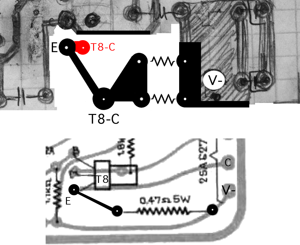

I had a similar bias problem years ago and traced it to my layout and I think yours has the same problem.
you have to feed the output transistors collector from the drivers emitter and not from any other point closer to the 0R33/5W resistors.
I have highlighted the difference between your layout and the original pcb.
hope this helps
regards
james
hope this helps
regards
james

I had a working L'30W with the original pcb then decides to make my own for the to3p transistors, the bias was way to high, checked everything and eventually change the wiring of the output stage as detailed in my previous post and the bias was right.
my layout was smaller than yours and a little more idiosyncratic, but has been working for years now.
If I can find my old layout I will post it
regards
james
