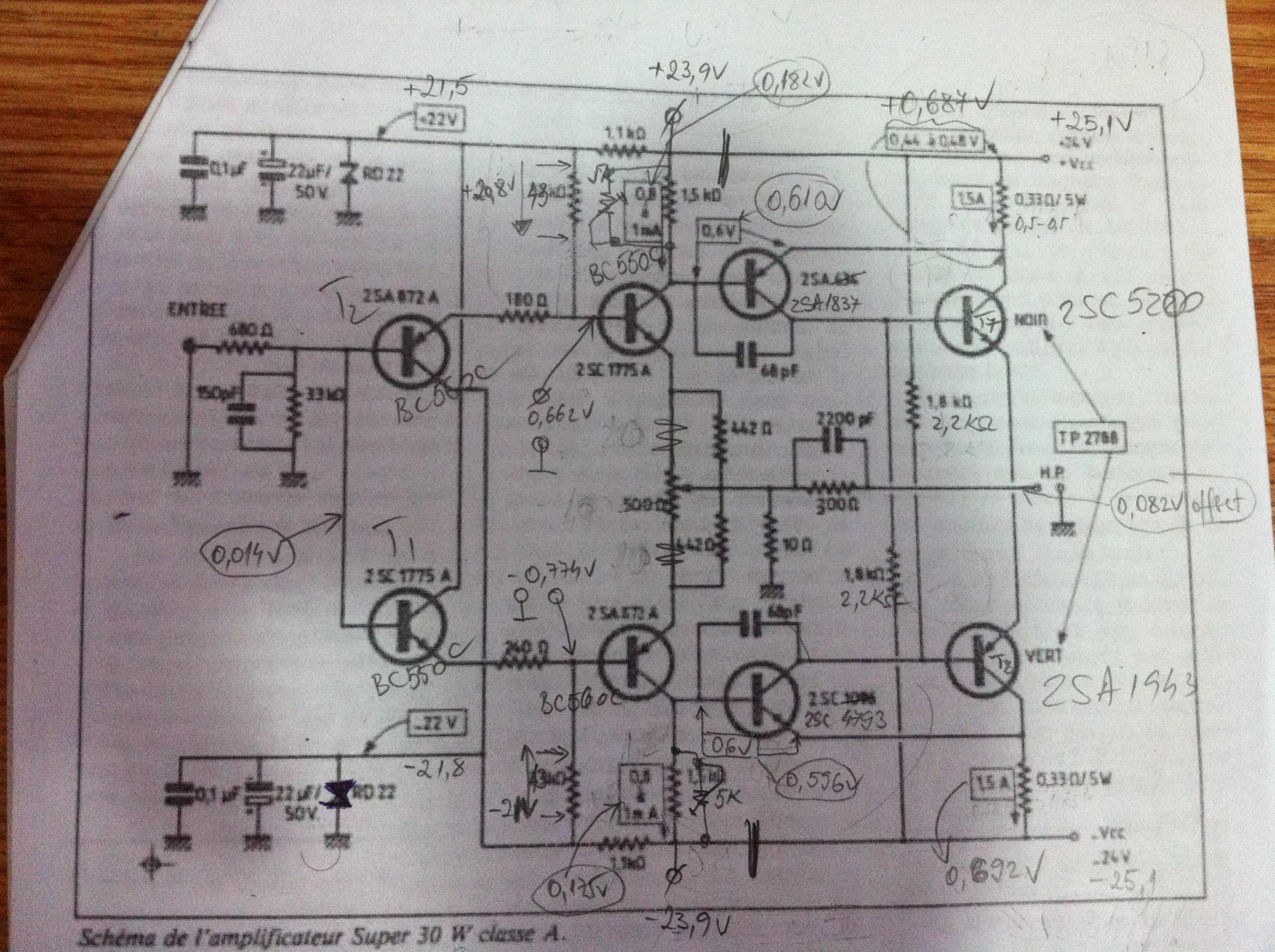

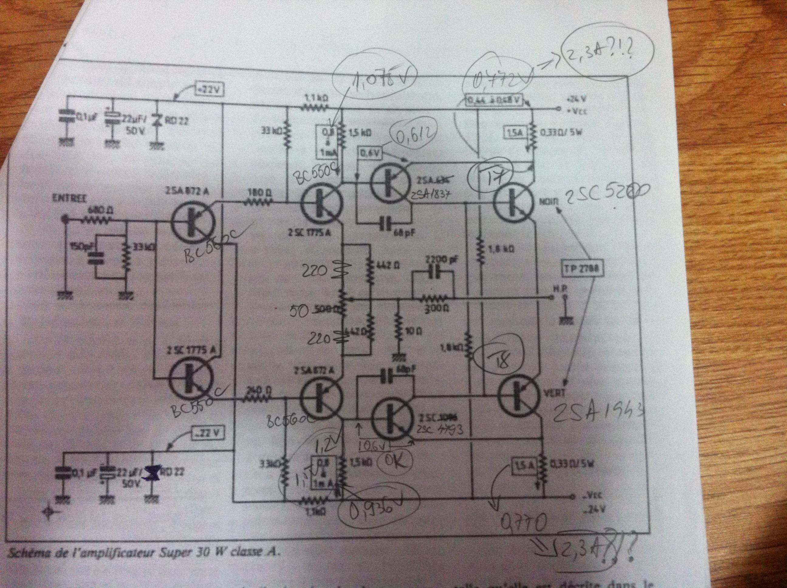

I have done this too and leaved this as you said on the whole day today. In the above results is included this addenum too. Cannot go lower with the bias..
Please help!
Now i lowered the 1k5 to 680ohms. The bias goes down to 0,734v and now i have 0,6 mA at the buffers collectors. I decreased the 33k to 26k and the drivers bias is now 0,94v across the 680 ohm (1,4mA--too high--needs readjust) and the bias across the 0R33 goes back to 0,843v....😡
Please help!
Please help!
The 0r33 resistors are very hot (cant touch them). Is this because of the hight bias?

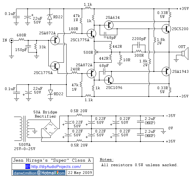

Hi sergiu
In the Hiraga 20W amplifier the output pair is a darlingnot, "seen" as one transistor.
The bias is set with the 1k5.
So parallel the 1k5 with a 5k potmeter, turn it to zero (really) on both sides, then gradually increase the resistance until you have the correct power (amp) flowing. Personally I'd go for 1,5 Amp. That is already a lot and gets everything hot.
When doing it this way, first ensure your resistor network in the feedback path is equally set for both halves (the 50 or 500 ohms) in the middle position.
Then make a final trim to the DC point (0,0 V) with the 50/500 ohm pot.
This simple procedure is from the F5 by mr Pass 🙂 It always works. You can even leave the pots in place if they have good quality.

Hi Triode,
Thanks for the advice. I just did that 5 min ago and this takes the bias down to 0.67 and 0.35V across the "1k5" (1k5+5k trimpot)...
Cannot go lower than this... If i go to minimum value (0ohm at 1k5) i have 0.82v bias 🙁
And this value is with 2.2k instead of 1k8.

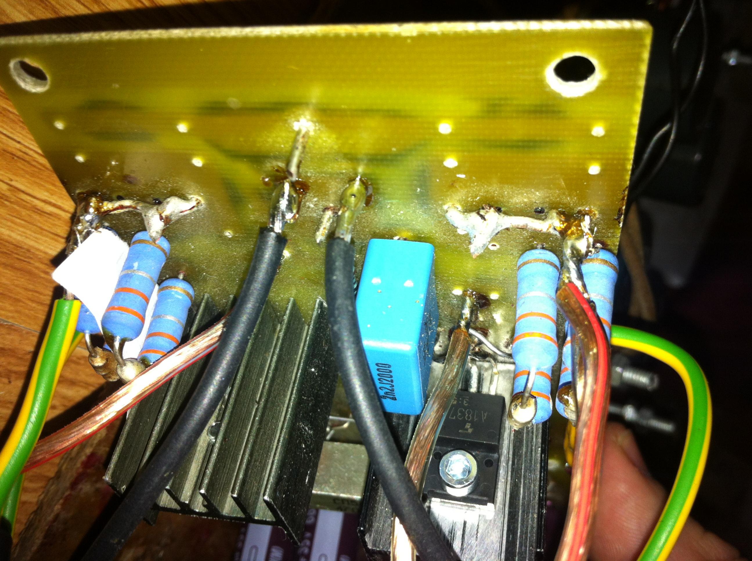

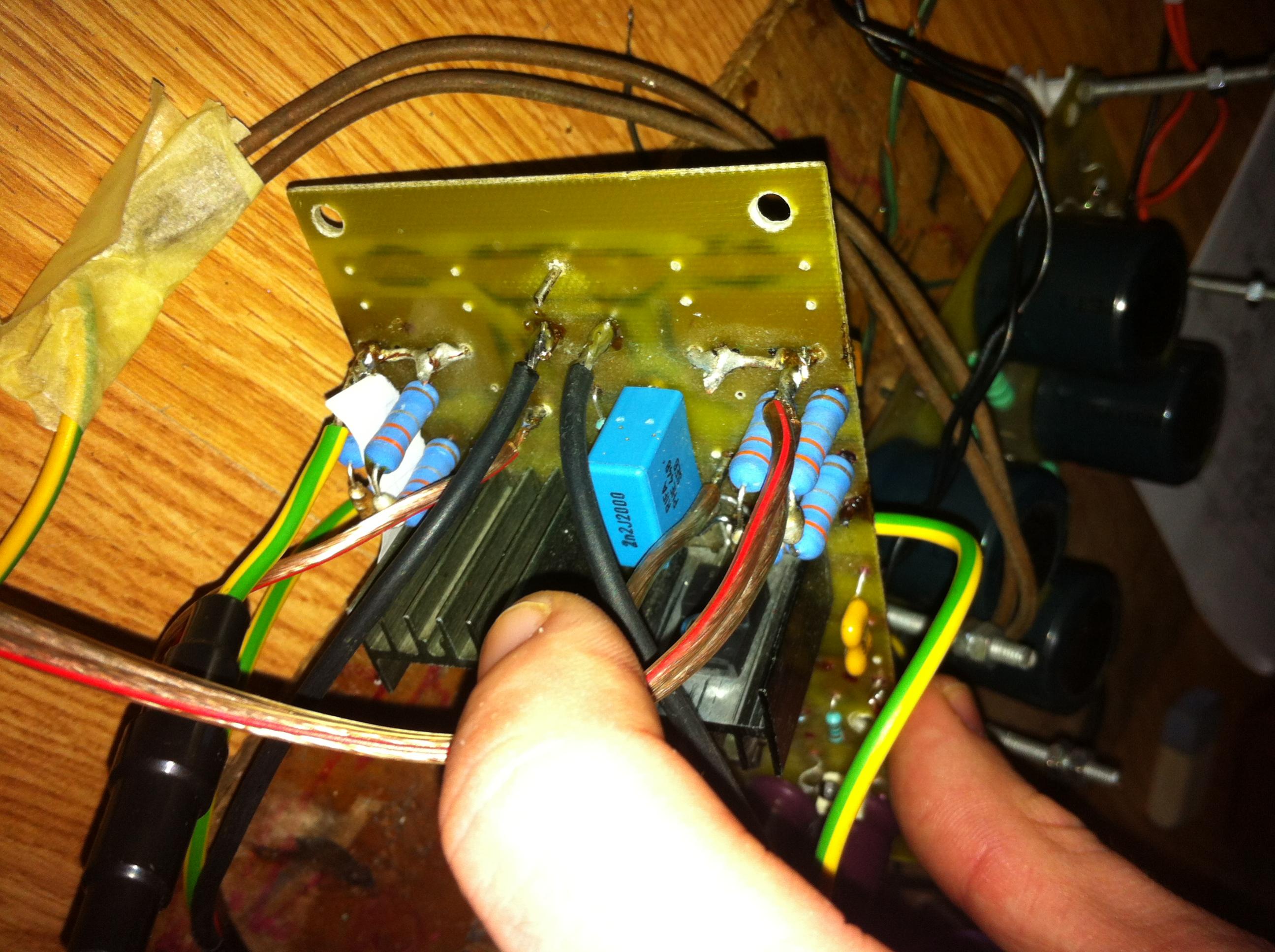

You need to check your layout, specifically resistor values and transistor orientation I think either that or you have an issue with a pair of transistors. This is my gut feeling but it is hard to diagnose without measuring more.
Can you take a photo of the board only in its current configuration perhaps we can help

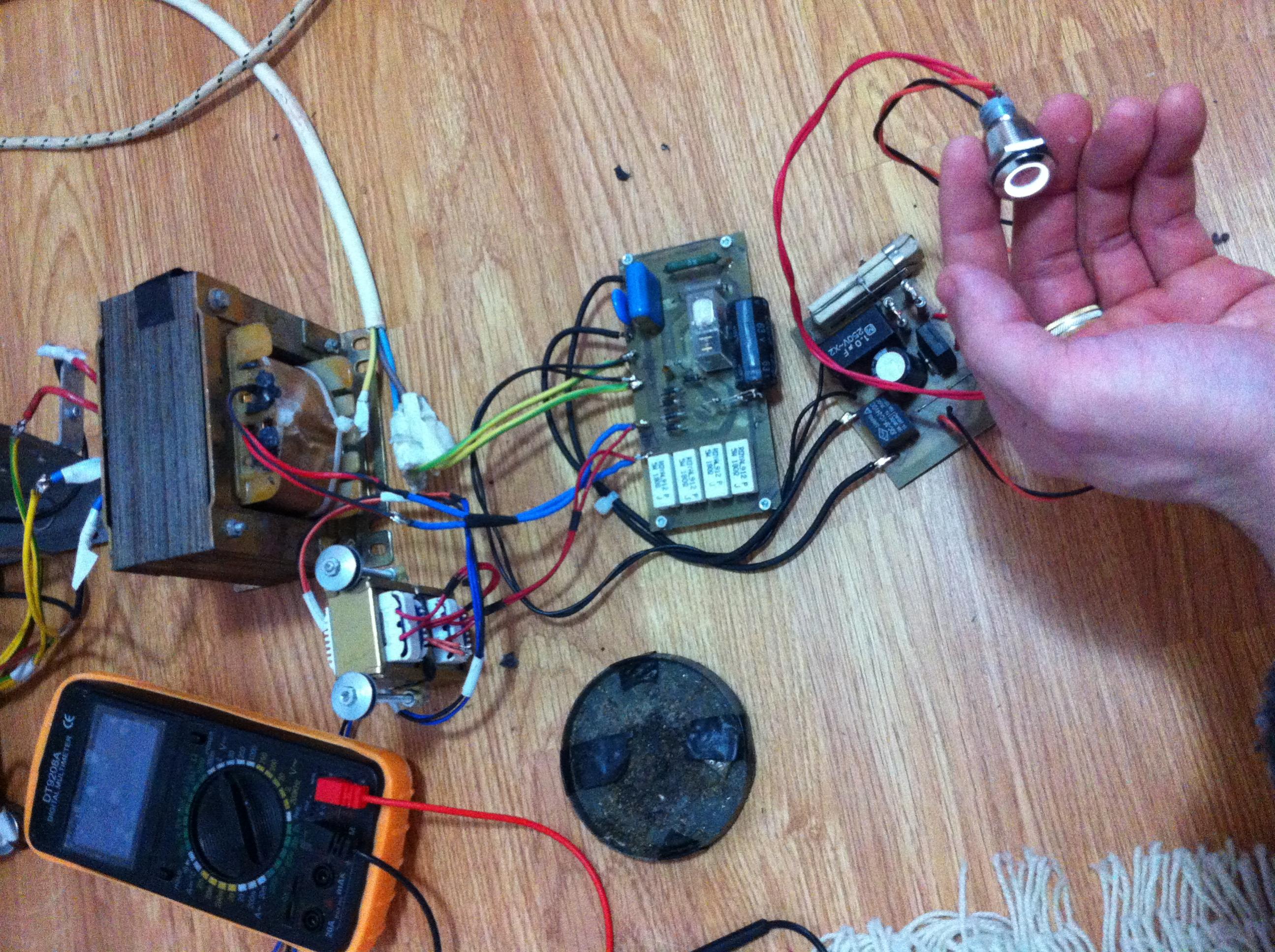

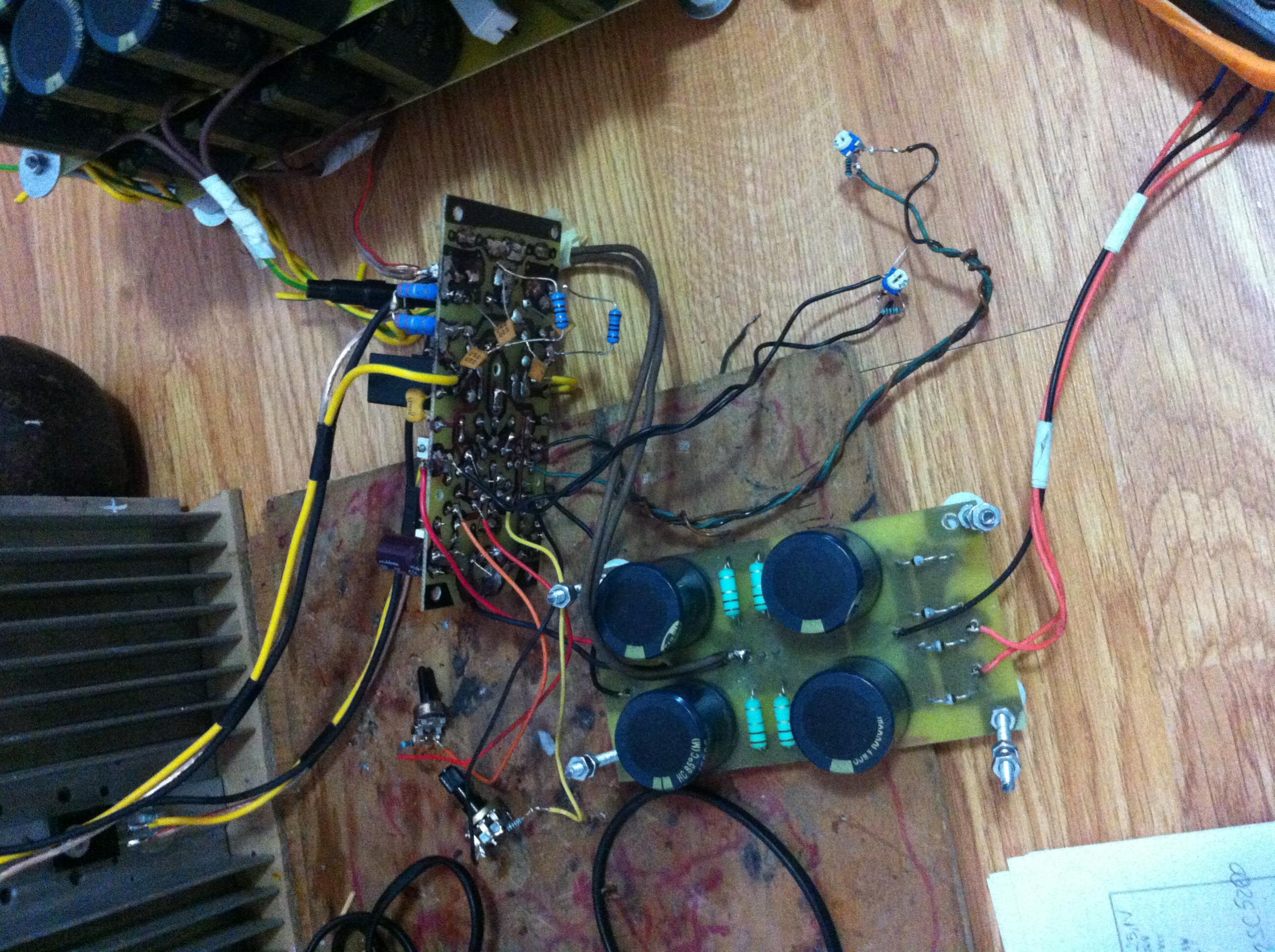

Here we are (from left to right):
1) the modified schm that you used
2) actual measurements

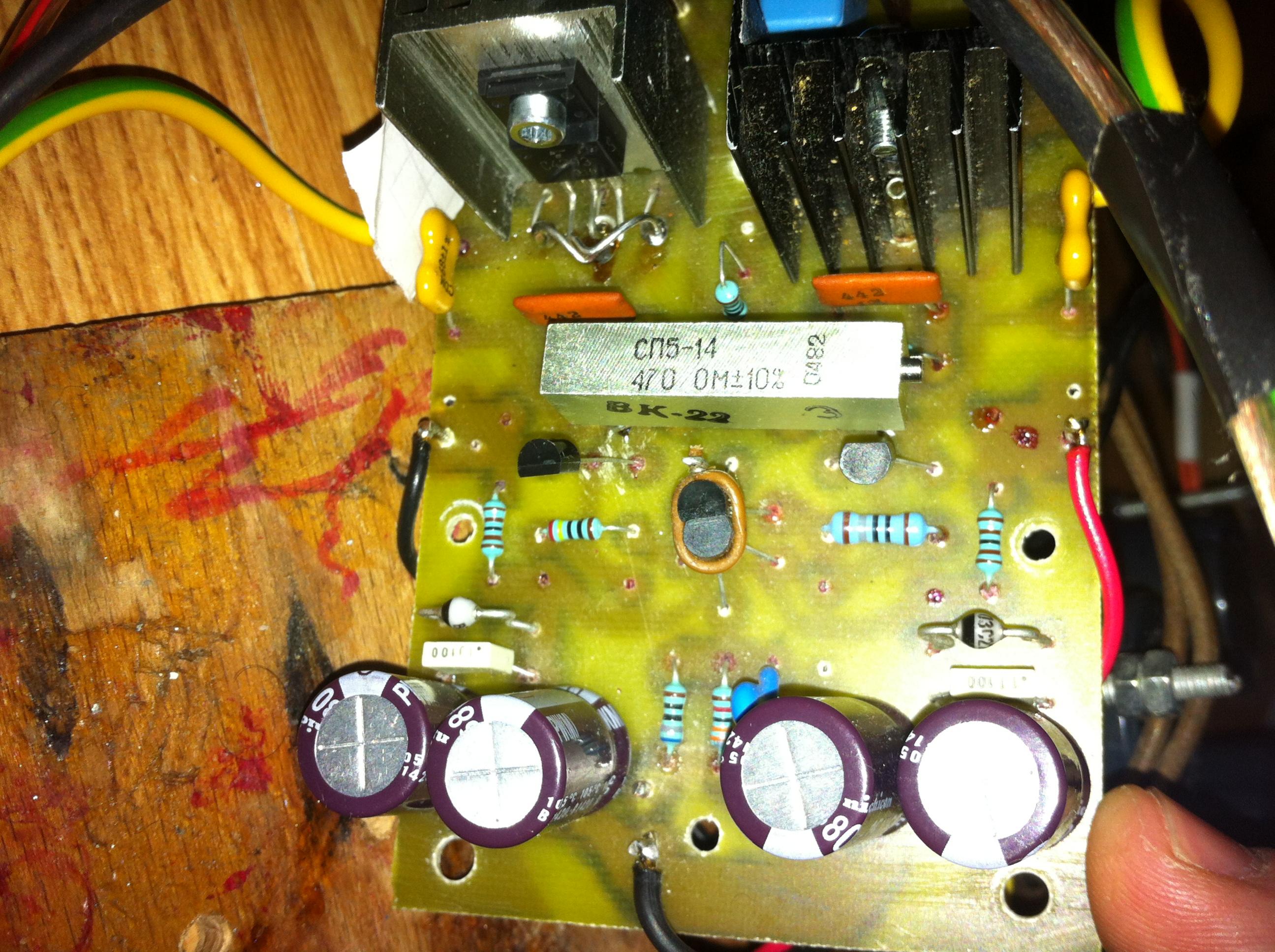

3) all the nest + the psu for the 24v at the input 🙂
4) soft start and a little "trick" for using that illuminated button

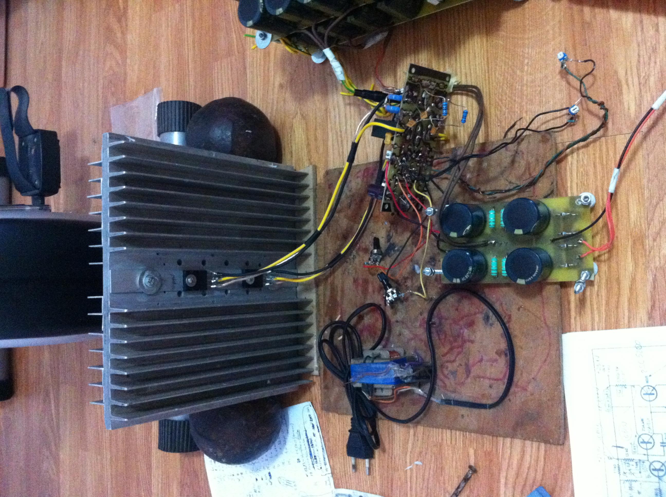

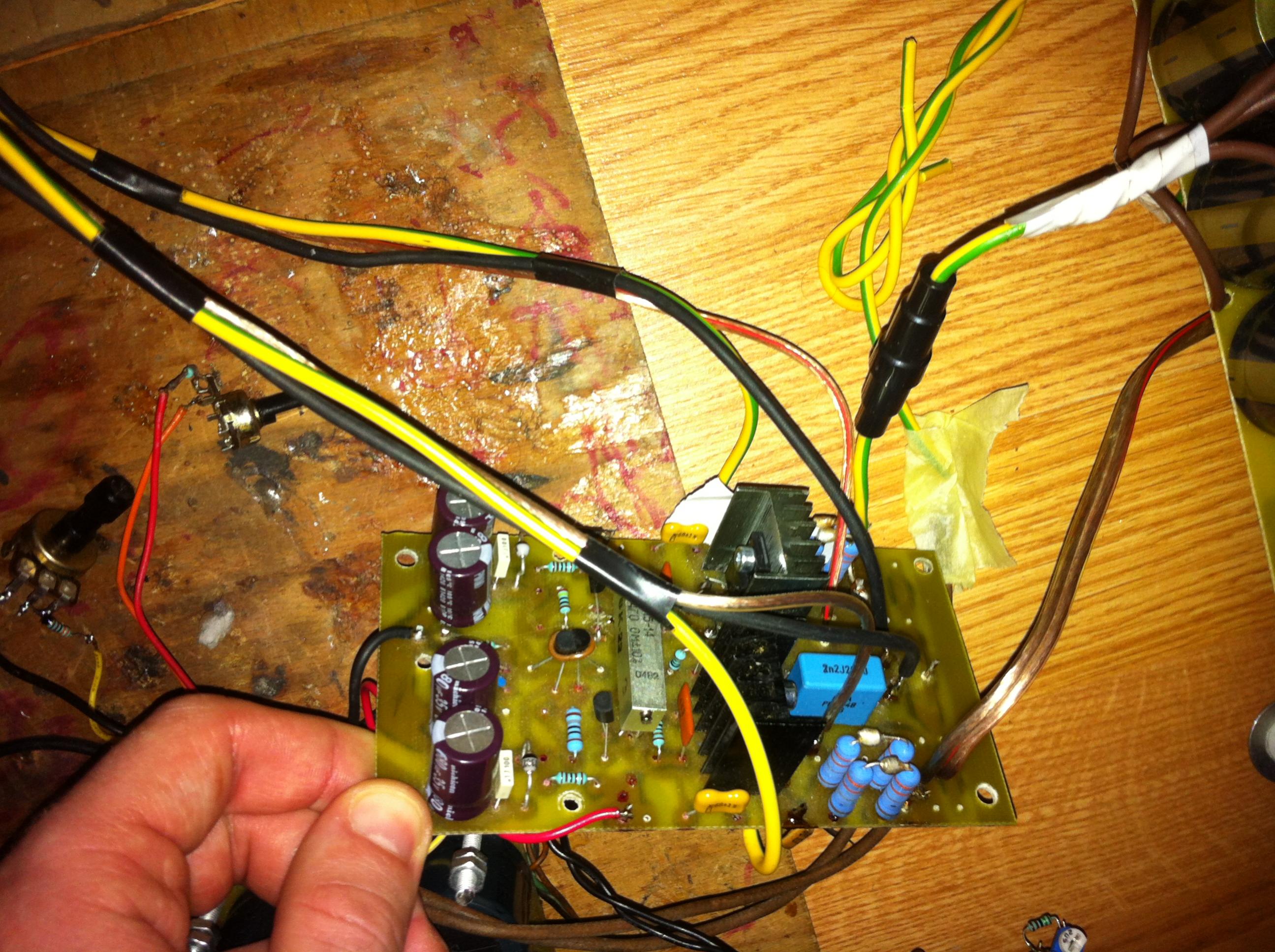

5) radiator and the nest
6 &7 the front of the amp
8 & ( the back of the amp

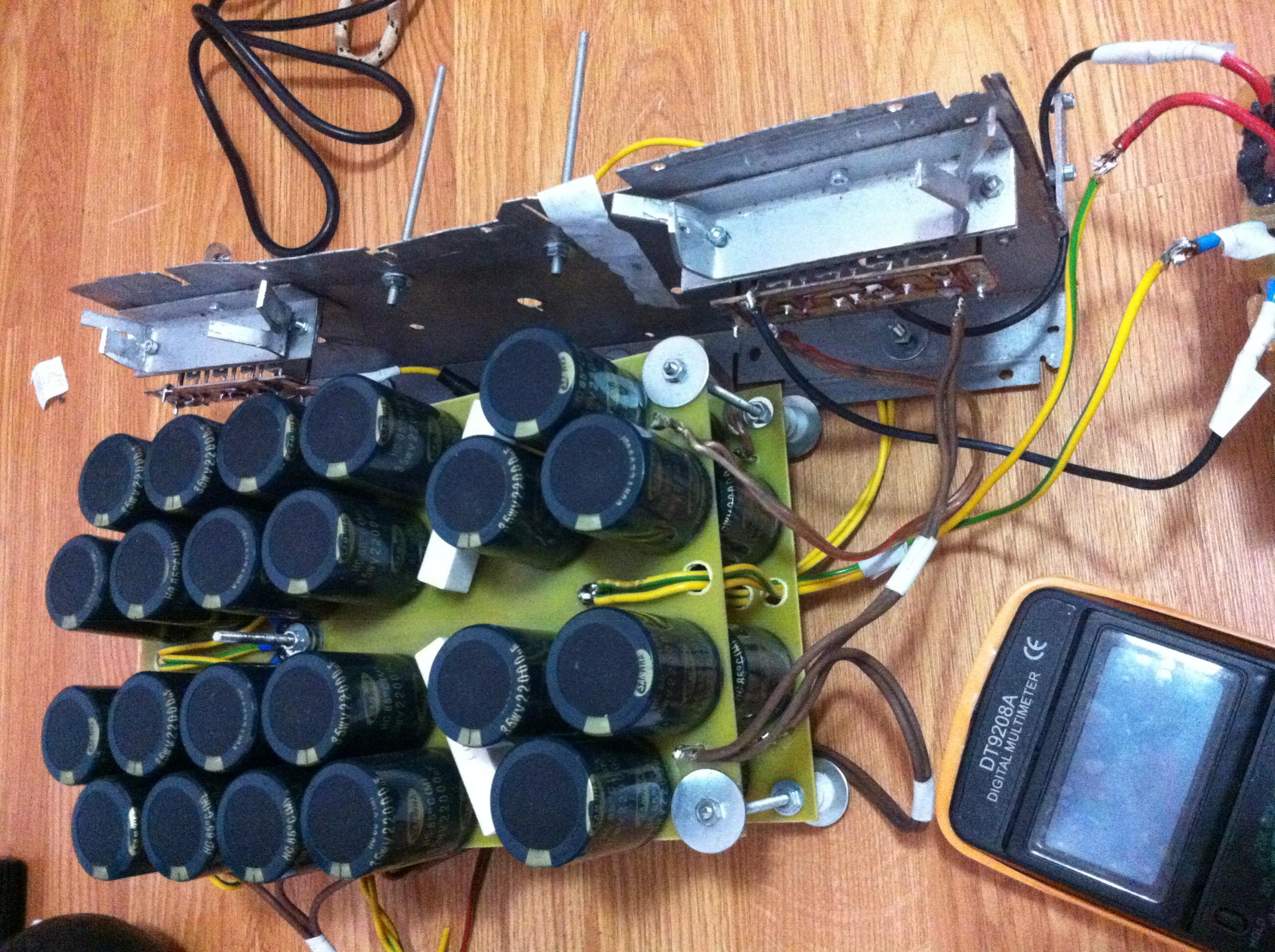

And here is the rectifier + CrC for the +-25V output (2X484.000uF/35v psu's each, one 0.484F for each channel).
