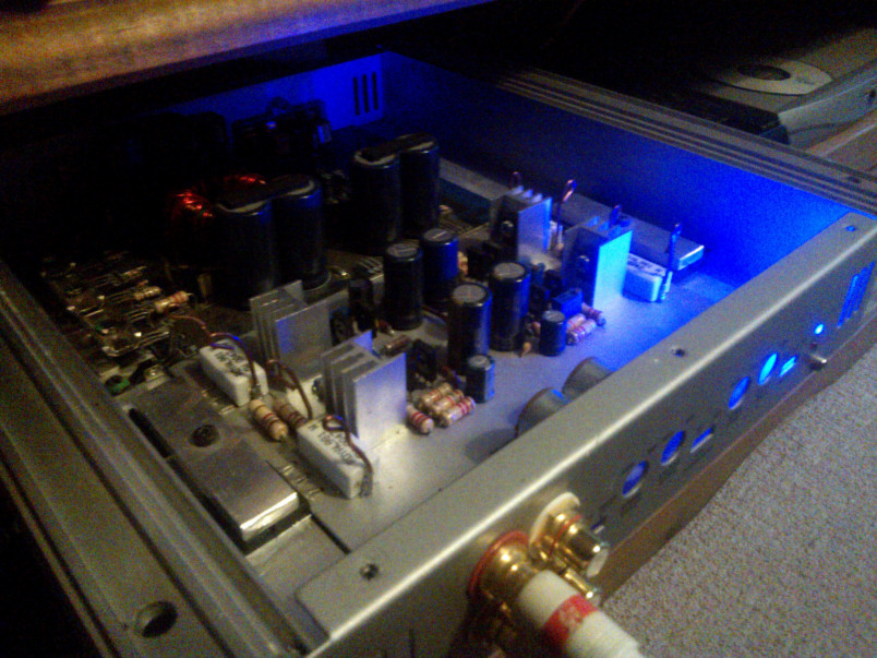

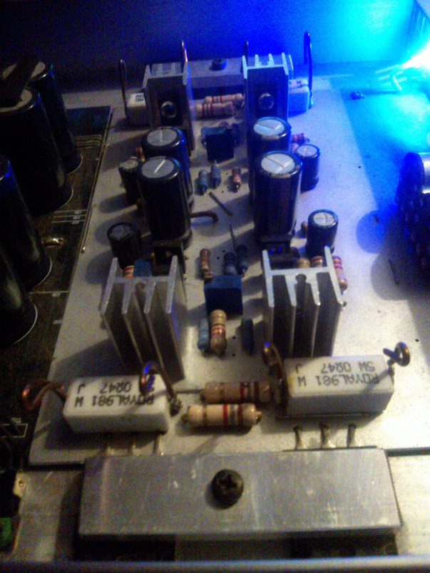

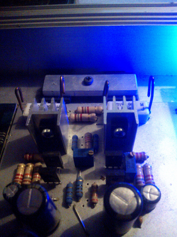

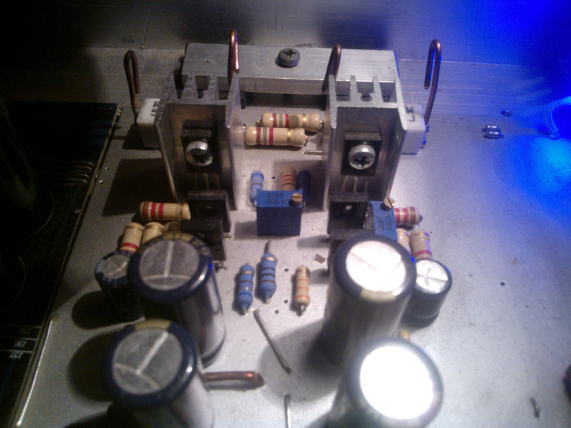

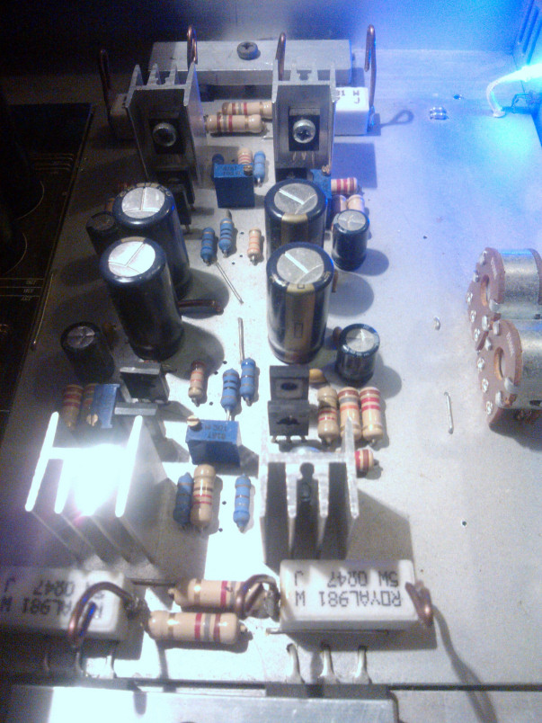

Hi, here is my Amp its the 20w Version, its using a 12v to 24v step up power supply and I cant bias very High Without having a fan On it at the moment. Until I get some heatsinks. Ive heard it biased 0.40v over the source resistors and sounds really good. But as you see the components are not that good. Any comments on people who know ? I guess I can replace resistors with better and make a better Power Supply.
Hey, I have 0.47Ohms Resistors and 0.51V across them.
How high In theory can I bias ? I presume I can go up to about 0.70 Volts
My Outputs are 2sc5200 and 2sa1943
Do I need to change any components to make bias higher or do I just increase from 0.51v to say 0.6v
Just wondering If anyone can help, Thanks

You can bias as high as the output devices can survive the extra temperature.
Once your bias is above optimal ClassAB, then when peak current exceeds the ClassA current limit, the amplifier will create crossover distortion. That crossover distortion will be worse than optimal ClassAB crossover distortion.
If your peak current is below the ClassA limit, then you don't have any crossover distortion.
