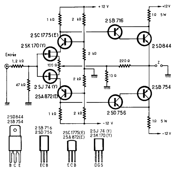

Gabor,
though you are pertinent (DON'T 😱), but .. . . is 2SA940/2SC2240 an option? I have seen this pair as a replacement in Le Classe A - but I can't find the Rbb. I bought two lots of both, match well. Intend to use these.
The commonly seen BC549/BC559 etc has a higher Rbb, in the order of 20 ohms. But they do have a flat Hfe, which is important too.
Just searching on the net, I found 2SA1316 with an Rbb of 2 ohm, and a Cob of 6 pF. I bought some, measure well, but I can't find the complement 2SC3329.

Look I know after my experience what I advise. You can take it or you can try to replace those BJT-s and after start all the endless research.
If we would talk here BC550C & 560C right away I would say replace it wit 2SK170BL & 2SJ74BL. Great improvement.
Since I tried several other type BJT and after I went back to use my short cut leads over soldered orig BJT I know it worth to buy them if you have source and you have no more headache.
I have a circuit I want to test someone mod it lot of LED, other type BJT etc I still I test it with the orig 2SA782/2SC1775.
It is possible to replace those BJT? Yes I don't say not. I built several Hiraga.
The problem these amp very sensitive every parts U use plus the PS is very important to.
If you want have a peace of mind at least test one side with the orig another side replace it ans com pare them again and again. Let us know if you find something close (sound wise) to the orig please.

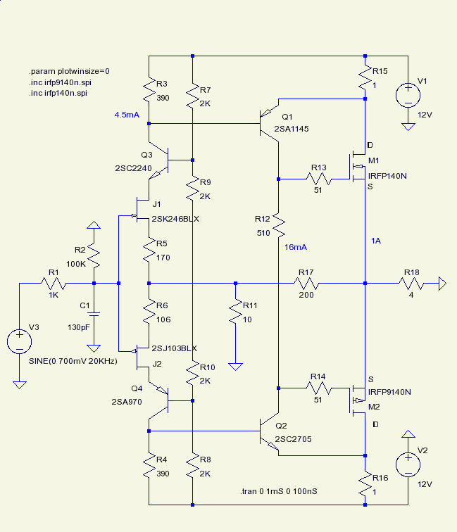

That's a nice combination of Le Monstre and the Le Classe A variant of the Sony Farlington.
I plan to use HIT667, + HIT647 as drivers. That must be good enough for the input capacitance, there is no real current like with a BJT output.

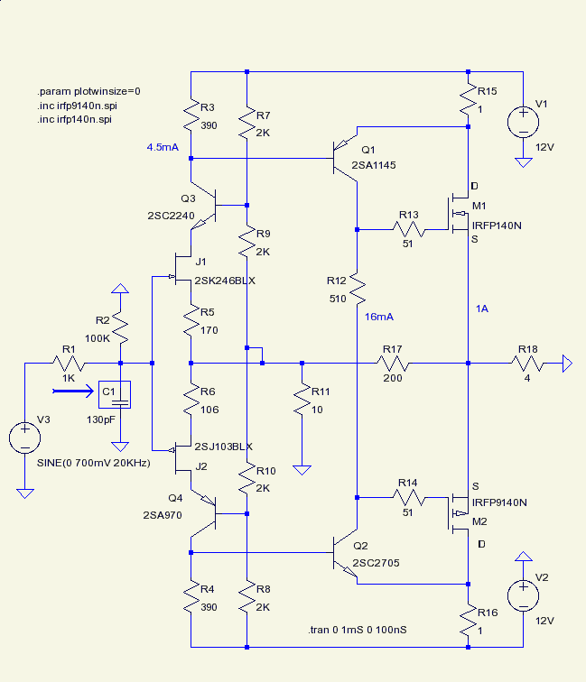

In the original the cascode bias goes to ground.
With due attenuation of the feedback (220 ohms/10 ohms á Le Monstre and maximum signal of 10 peak) this means that the Vds swings one volt underneath the cascode. That is OK.
With a higher voltage, the Vds starts to swing more. At a certain point (like in the F5 cascode!) there is 5 volts swing on the Vds - to much imho, the whole sense of the cascode disappears, except for the dissipation/heat.
  • (The sonic reason is that it decreases the capacitances of the input JFets and makes them more transparent)
So Gabor,
My reasoned suggestion: connect the bottom of the bias divider to the 10 ohms of the feedback.
[The all BJT Le Classe A don't have a cascode]
Hello
So you say to use the connection at the mosfet version it was correct. Connect to the ground!? Like the schematic at the post 571?
Please advise if I understand it well. All do I want to go a bit higher PS voltage. About 17V rail voltage but I still do not think that extra 5V will do 5V swing.
