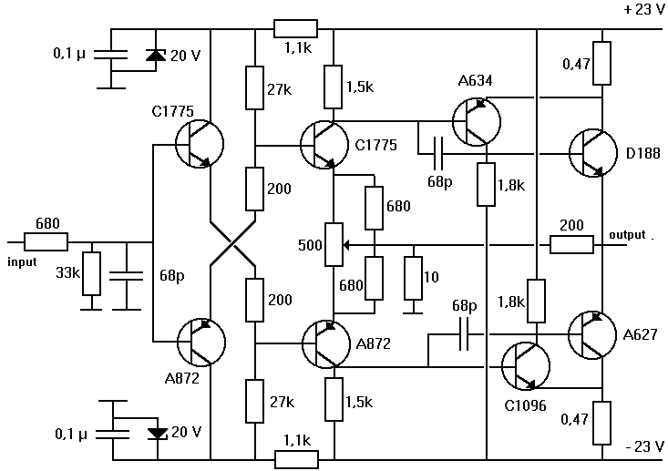

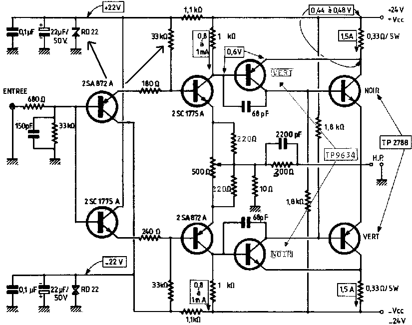

The resistor with value of 47kohm should be lower. Try with lower values 39k,33k,30k.... to voltage drop across 5W resistors are 2A=voltage drop/ resistor value. With 2A current you will have 36W/8ohm on pure class A.
The resistor's value 0.47ohm 10W is large. Try with 0.22ohm. Lower value of this resistor should improve the bass control.

To write some info the bias set up
There is two important think you must take care!
One the diode V rating!
Second the 47K resistor in your case! But think, if Dan uses the same Voltage and 47K resistor you have some other problem. The driver transistors lightly warm even under heavy load to..
Take a look these two parts how it change when you use different rail voltage.

Please study the diode and the resistor value at different rail voltage.

I marked the resistor responsible for the bias! But the diode to!

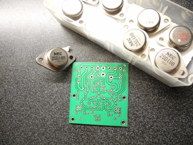

I would not recommend these boards. I bought them but they are too small to accomodate 'High-end standard' components + some other issues. I Will use them as breadboard for tests and make my own.
OK I didn't knew that.
You can use the Stig Eric (design) I posted somewhere at the front. Many thanks to Eric!!!
Just do not forget you need 4 jumper for that PC board.

Curent issues, power issues, thermal issues ... Better to use 1/2W or even one watt resistors even if calculated 1/4 is enough. Better to use thicker copper or solder solid core on power rails and output Xtors.
Pix attached to have a better idea!
Hello
Yes that PC board way to small. Probably it has other issue to how you mentioned.
The driver transistor just need a small heatsink but OK with out heatsink to. To spread the heat better you can use 1Cm copper over the aluminium heatsink (under the transistors) but very expensive.
The Erik design has very good lay out!

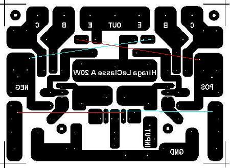

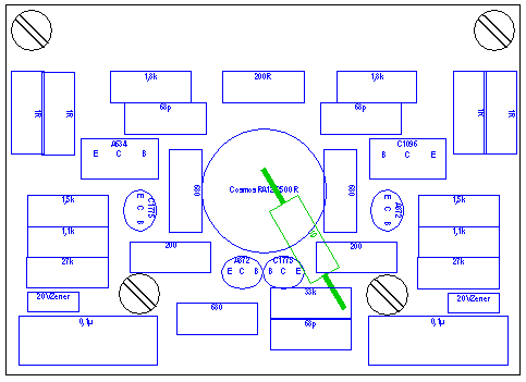

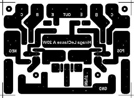

Hello
Here you have
Whith these PC boar you can use 1W resistors to. It has room enoug some place even for 2-3W.

Those colored marks on the layout jumpers!
