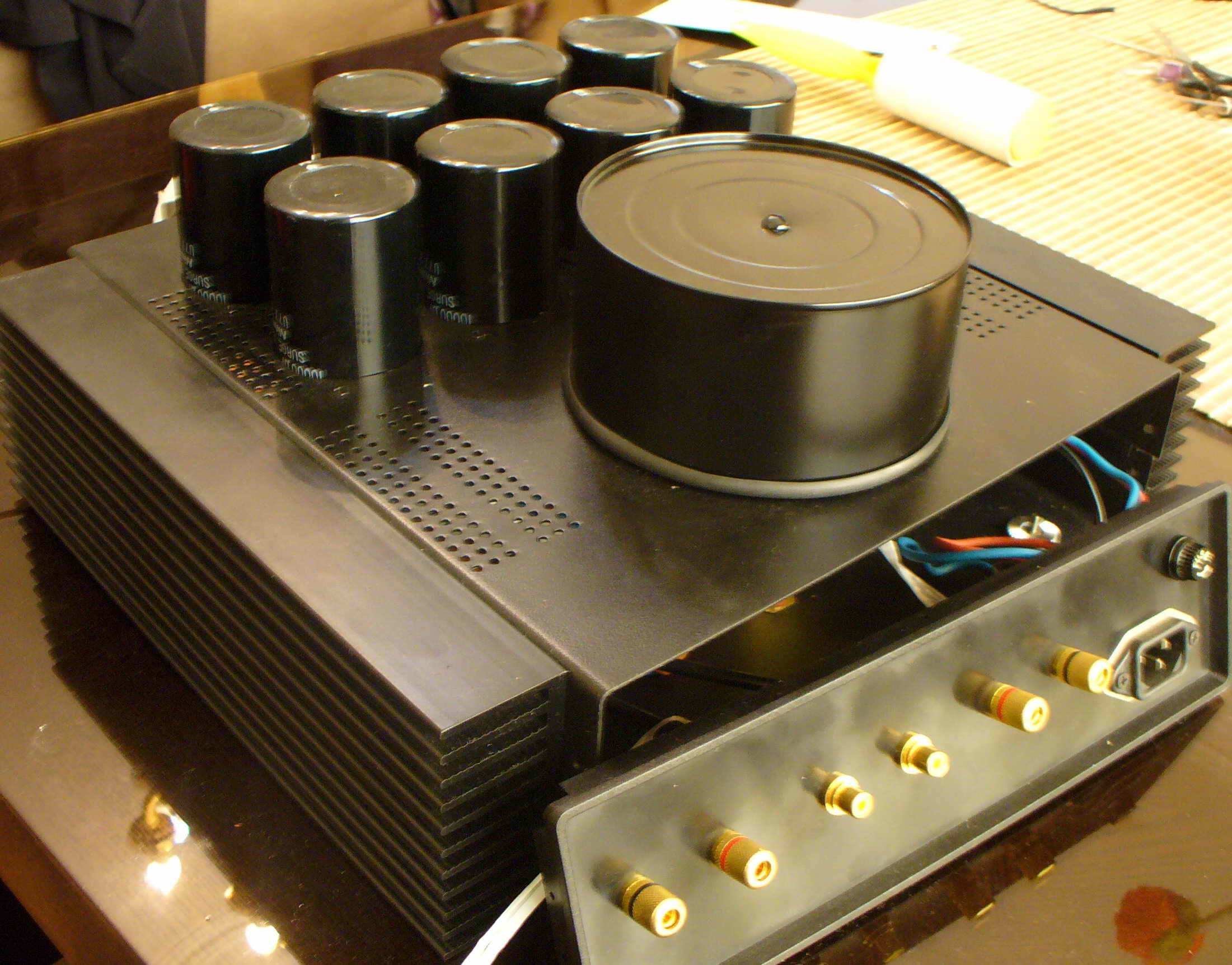

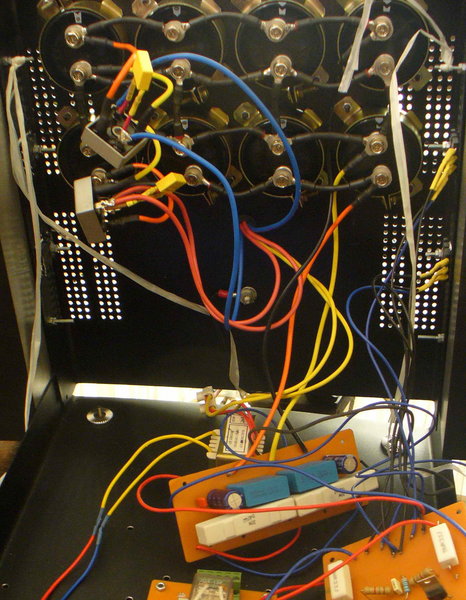

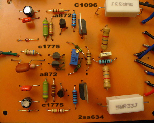

I am newbie in diy and also electronic.I have tried to build the Hiraga super class a based on the schematic that Dan has provided.First it was not working at all.I figured that I had plugged some devices the wrong way.plus when Dan has shortened some transistors I had done it for sure too. now it's working in a way but the problem is that while the output stage transistors are running quite cold the 2sa634/1096 are getting hot.voltage after the 22volt zeners are 23.38 the other voltage and currents that the original schematic suggest are quite the same.but across the 0.33 5W resistors the voltage drop is something like 7 millivolts and as I understand a very little current must be flowing there.The voltage rails are 35.I would really appreciate any help.
Here are some pictures;Ashkan

The heat sink is to small specially mounted that way how you use it. You lose the heat sink 40% capacity at least.
300VA transformer at that voltage enough for one chanel only. I used at the M Hiraga used 300VA at 12V power supply.The transformer was at least 45-50C warm or higher..
Please check the transistors are all the right place? also after measure all the resistors.
The Class A so simple amp to me always worked with any transistor I chose.
Please check the PNP and NPN to be the right place, also the pin out to. The driver transistors are not supposed to be that warm, check all the resistor value after goes to the power transistors.

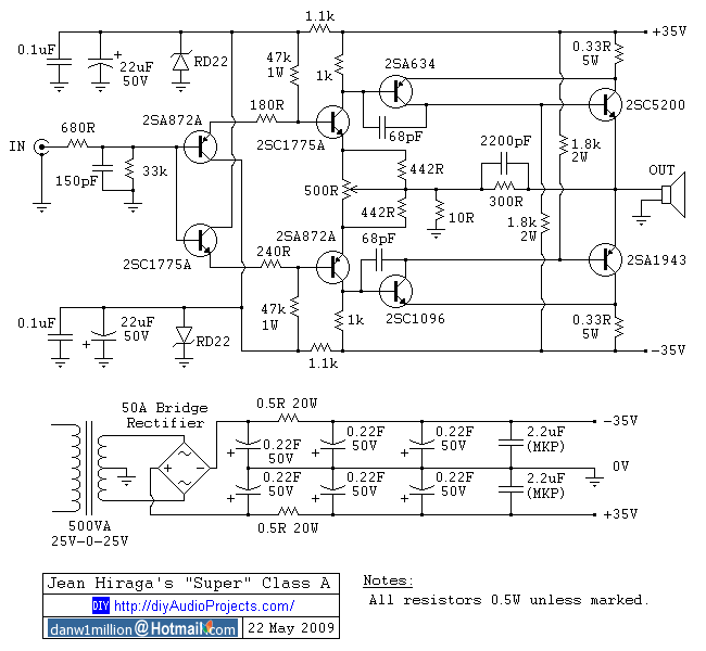

Dan amplifier was my refrence. 420 X 180 X 35 mm. Mine is 600 X 200 X 40 total. But you are right, the way I have instaled them is not that effective. I could not build the enclosure from scratch.so I used a premade one and since its dimensions are 320 X 280 X 100 mm I thought more heat sink can be implemented this way. about the transformer I only have this one right now. doy think that I can run the amp with this one even in class AB? If I get the confidence I will build another one with the pcb that you suggested later. here is the schematic;

Here is another picture. I have replaced the 1k8 resistors for 3W. but I learned that I have to replace them again to set the bias. The R33 5W resistors are 1.1R ( this is what the multimeter shows) everything else is the same as schematic.The voltage drop across 5W resistors are very small(0.007 volt) ;
