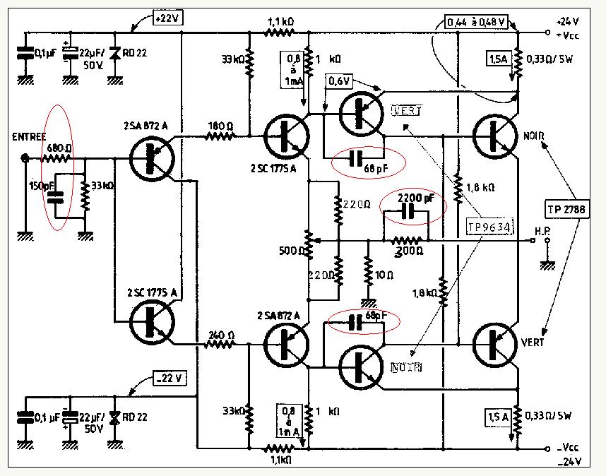

Hi, guys! What do you think about the scheme, it is good?
What do you think about the electronic components enclosed in red on the scheme in my post?
I think these electrics elements limit the ability of the amplifier. What do you think about this?
Do you think that, they are only for the limited bandwidth and they are necessary?
What happens if we remove it?

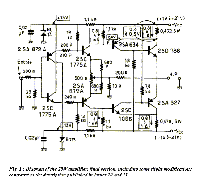

what's the difference between these two schematics?

The scheme is identical with others scheme in old posts, but my question is for the condensers 68pF and 2200pF, which skipped the transistors and which is in a feedback enclosed in red on the scheme in my post. I think these elements limit the ability of the amplifier and make it worse.

The schematic above appears to be for the 30W version of this amp. I've attached below the schematic for the 20W version, which I took from the "class a amplifier site", which has the original L'Audiophile articles (in English translation as well as the original French.) Note the rail voltages compared to yours above, the bias current, and that there are (almost) no capacitors... I'll leave people who understand these things better than I do to explain why 30W needs them and 20W doesn't, but at least the schematic shows that they aren't essential in principle.

Leaving those capacitors could bring a lot of swing into your amp.
Depends of your layout and wireing.
Compensation is needed to get a nice square wave.
maybe you can reduce the values. Silver mica is recommended.
You have to check your work with a scope.

Somebody has done experiments with different values of these capacitors or with and without them?

These capacitors locations are pretty standard fare on a lot of amps.
The capacitor closest to the input is a HF filter to limit the amplifiers frequency response, the 68pF caps (yes silver mica is good here) are also for HF stability - i have tried with and without the the results are similar but the amp is more prone to very small level HF oscillations on leading edge of the signal. My understanding is these caps provide some degree of local feedback and help the slightly different - yet relatively low values of Cob for the 2SA634/2SC1096 pair.
The capacitor on the feedback resistor is also pretty normal - once again used for HF stability / HF roll off characteristics.
My personal opinion is the point in this circuit which the capacitors are placed do not affect the sound adversly - they are all there to correct any potential HF issues and improve with difficult reactive loads in an other wise very stable yet fast amplfier.
Hope this helps
