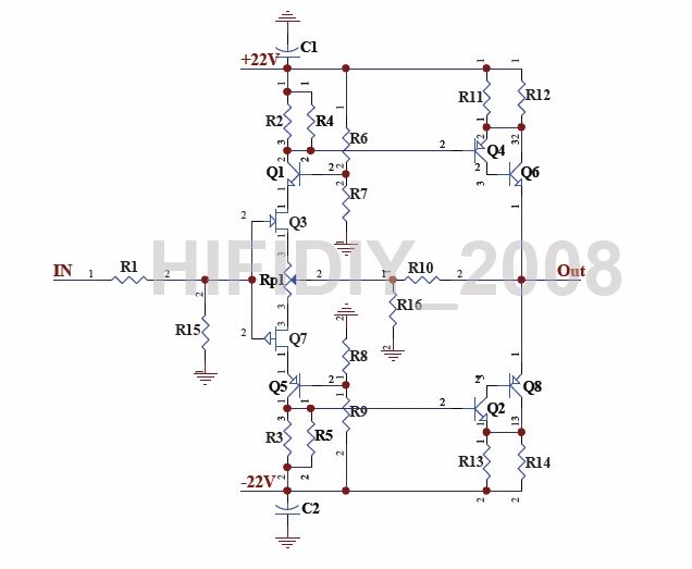

I have purchased boards for what appears to be a Hiraga Le Monstre with 20-22 volt rails . I've poured through this thread and two others only to find wide ranging opinions regarding semiconductors. The parts list that is associated with the boards calls for 2n3055/mj2955 outputs ,2sd756/2sb716 drivers and 2sa872/2sc1775 cascode. The venerable j170/k74 jfets are at the input.
Two concerns; the 2n3055 combo which has been all but forgotten and the 2sb716 which is the only small piece I cant seem to buy.
The threads indicate other possibilities both for drivers and outputs.Would anyone care (I hope so) to offer alternatives based on actual experience.
I really have spent time looking through the threads and am not looking for an easy way out.
Thanks so much.🙂

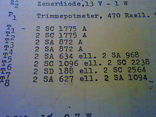

I bought and built a Danish kit version many years ago
Very serious kit with absolute top of the top quality parts, unobtainaly to ordinary people, back then
I dont know if anything was changed from the original, but seems to me transistors are different
The outputs were with green housing, so I suppose they were all genuine Toshiba
I have specs on other used parts too, if needed
btw, it worked flawlessly, very good, still regret I sold it 🙂

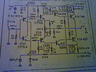

Hi Sandy,
This is not a Le monstre it is the 20W class A... i think perhaps you will find much better results with different output transistors than 2N3055/2955
PS: I have some 2sd756/2sb716 left PM or email danw1million@hotmail.com so i dont annoy anyone on here.

I'm a little surprised at the rail voltages you give; +/- 12V is used in the original Le Monstre. Do you have a schematic?
Dan: The schematic tinitus posted is certainly for the Le Classe A, not the Le Monstre, but Sandy said the input jfets listed were 2SK170 and 2SJ74, which the Classe A doesn't use... in fact, it doesn't use jfets at all...

looks like a Le Monstre layed out slightly differently.
Hi Andrew - Long time no speak - the output transistors are connected like the normal Le Monstre. it is strange but correct 🙂
Strange to have the rail voltage at +/- 22V though at least for le monstre.
-Dan
The parallel resistor is no big deal.The resistance at that point is 470 ohm 5 watt which could be a combo of two 3watters. The rail caps are a simple refinement which may make little or no difference in performance. I'm not sure why I 'm doing this project but if for no other reason I can make a comparison with my ZEN(s).
One point;the semis are all TO-92 except the outs which can either be TO-3 0r TO-220.
There is no bias or other info included with this package . I'm eyeing a cap multiplier for power but also considering CLC.Can do about 68,000uf without spending a dime. There is no reason why I'd have to adhere to 22v rails and may decide not to .Have a 24vct 10 amp trans sitting idle.
