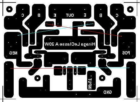

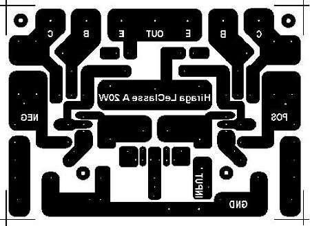

I forget to mentioned the green resister have to be on the butom of the PC board and 2W .
The emmiter resister I use 2x5W /side , please calculate the right value .
Use these layout , you can open with paint program .
Magnified 6x and fix a bit . After save it and U can use it .
Is better design than the orig .
There is 4 jumper .
I will mark in the next post . Use solid wire for the jumper to .
The colored lines are jumpers , one more time use solid wires .
I hope these help.
Greetings

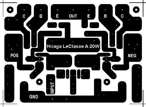

Hi Guys!
I just finished the 2nd design of my Hiraga Class A.
The 1.0 version used BC556B/546B BD139/140 and 2SA1943/SC5200. The 2nd one uses BC557B/547B MJE253G/243G and same Toshiba output.
All of the other components value are same, but the first version had 1,1A current, the 2nd one has only 0,7A.
This difference could be caused by different beta values? (556B~320 557B~330 BD140~180 MJE253G~140) Or what?
I'm seeking for some other types of transistors with higher beta, but I bearly found calculable source.
My Hiraga v1.0, 2.0
Chiao!
