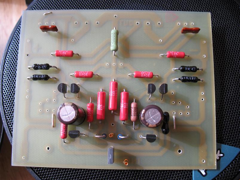

Hello
I bent the legs of the orig transistor how masage1 advised .
It was difficult because the transistors has short legs but I did it ,
Thanks for the advise for both of you .😀
Greets
