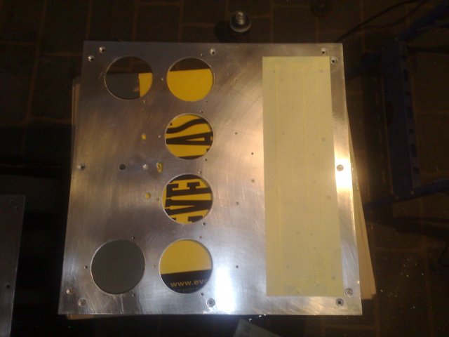

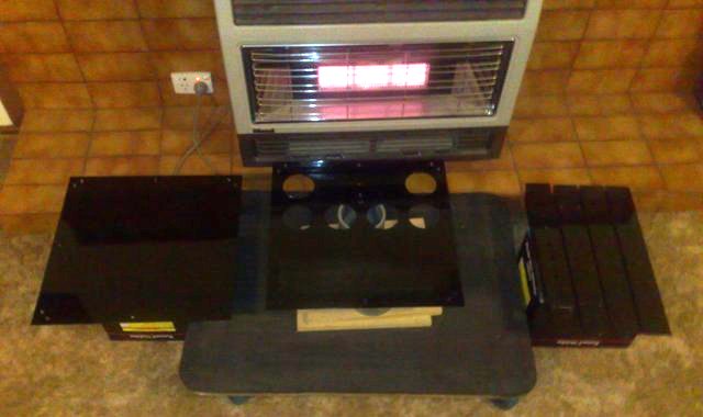

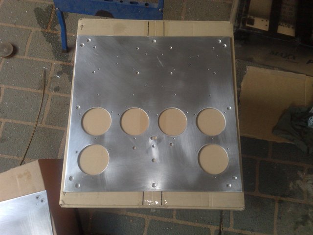

went to the hardware store today....

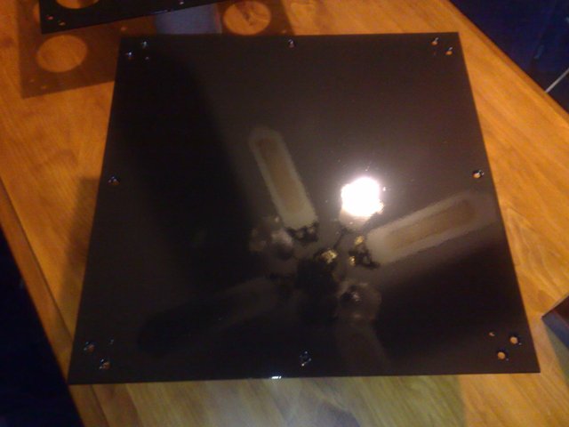

black gloss is on just have to wait for it to dry and it will be time to build this thing. (unless it needs some more paint / clear coat or something...)

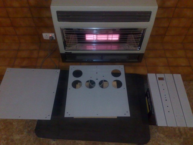

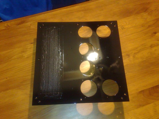

Hi Eduard,
I will be putting another coat of paint on the chassis in the next couple of days and then its time to assemble the amp 🙂
So far i have all the pieces ready I am just organising the inductors for the supply, it may get run at first without them and measured/listened to then run with them and measured/listened to, so i can see/hear the "real world" effects.

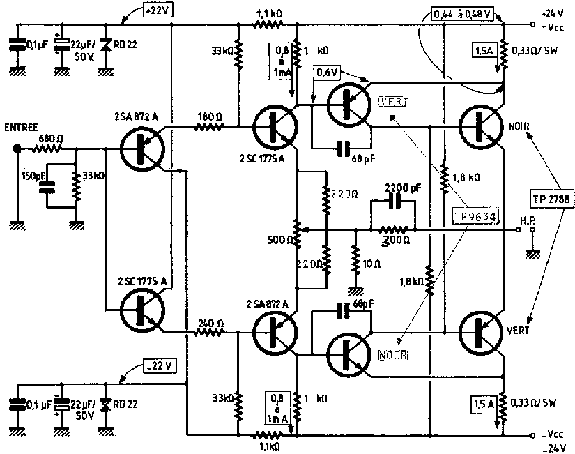

Hello Gaborbela,
what onsemis parts did you use ?
thats is actually the same schematic i used expect for the output pair, adj. bias and decoupling of the supply leads.
however all the transistors i used are originals expect the output pair
(i used toshiba 2sc5200/2sa1943)]

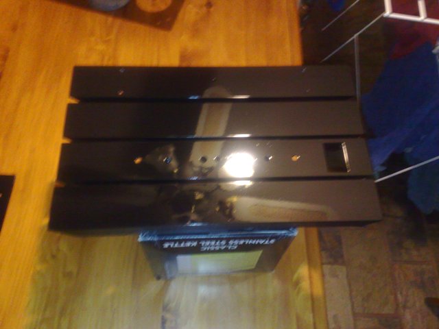

here is the second coat of paint for the chassis.

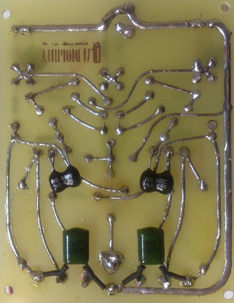

i took a look at your PCB with everything mounted .. transistors etc.:
http://www.diyaudio.com/forums/attachment.php?s=&postid=1576462&stamp=1217728407
amazingly clean and so very few parts
for being an amplifier that can have such good sound & performance
thanks Hiraga 😎

Hello,
One of the modifacations that were done here was interrupting the dc voltage tracks on the circuitboard and give the input and output stage their own cables arriving from the big power supply caps.
Also replace those 2 1k8 resistors with something like kiwame, mills or so. Mines were changed into two watt Allen Bradley. There weren't so much audiophile resistors those days ( at least 20 years ago) However the resistors supplied with the kit in Pareis those days were Shinkoh tantal. The 500ohm pot was Cosmos brand. One of the advantages of this design is that there aren't so much parts so you should use the best parts available. It is true that even using standard parts it will surpass a lot of others because their parts are even lower grade. Greetings, Eduard
HI
You may use the similar schematic from the UK site but please take a look at the input .
These one use 22V sender diode not 13V .
About the transistors please write you e-mail address .
I spent hours and days until I found better transistor than the original .I do not want to share every body .
