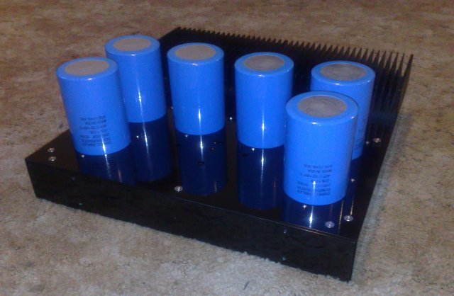

I refer to this original schematic, posted by gaborbela from Canada:
http://www.diyaudio.com/forums/attachment.php?s=&postid=1580452&stamp=1218173925
how important is the supply quality for this amp?
how good or less good is PSRR (power supply rejection ratio)?
Notes:
1. this symmetrical amplifier uses global Current Feedback.
This means feedback goes vis resistor from output to emitters of input transistor. I usually call this Emitter Feedback.
2. the input is a Diamond Buffer stage. This diamond is biased via resistors. From same supply as Power Output stage
Not via two CCS (constant current sources) which would give higher PSRR, and isolation from the Output Modulation currents.
The 1k1 resistors + 22uF caps filter in supply line try to improve this a bit.
Lineup conclusion
This amplifier is very much dependent of a good clean supply.
A supply free from (or very low) ripple and voltage level variation.
Power Supply Rejection Ratio is low.
And the use of Current Feedback is one factor why Power Supply must be very good!
This is typical for Current Feedback amplifiers.
PSRR. This is so low I would even recommend regulated power supply. For example by using LM338 or other powerful IC regulators.
I understand that some will use capacitance multiplier power supply from ESP site. This is more low cost and maybe just as good as buying a lot of very Big & Expensive Elyt Capacitors.
The more power output you make with this amplifier, the better supply you need.
For 1-2 Watt Output into 8 Ohm you may perhaps get away with a more 'normal' supply.

Please don't. I will buy this secret, since this is my most successful mass produced model in my China factory. Its crucial not to reveal.
lineup said:Power Supply Rejection Ratio is low.
Yes- it is. The only real fault I can find with this amp.
The PSU went thru several minor changes to kill noise.
It would be interesting to hear it with a more sophisticed PSU. The final version of the PSU worked very well, but there may be better ways to do it.

Lineup: thanks for the comments, I cant wait to hear it, i am working on it today....
I agree on the PSRR issue which i why i have more than a Farad.
I may after measurement use regulation before the large cap bank for the best of both worlds. it helped with my little "monstre"

Hello Daniel,
I think the looks are okay. But the red coloured caps did look a little better.
This amp is very sensitive to the parts being used. Not at least the parts used in the power supply. I think i did tell you before that Hiraga is busy building a new power supply for '' le monstre''.. Maybe a capacitance multiplier?
In general the reports about the hiraga amps are positive. The people owning one should be the positive music lovers.
Daniel make one change every time should be the way to go. Mine did have the chokes from the first because i did ask the people in Paris if i could use the choke that was developped for another solid state design in the 30 watt as well. 25 years later you can see people start using them to supply the heaters of 300b, 2a3 with cleaner voltage.
Now i will get bsy with a test set up for a new to built power supply for a drd amp ( also using chokes, even better a choke input) Greetings, Eduard P.s Daniel maybe i will have some 1k8 Allen Bradley . Anyway the ones i did use were not 0.5 watt like the Shinko tantal ones supplied by the shop in Paris.
