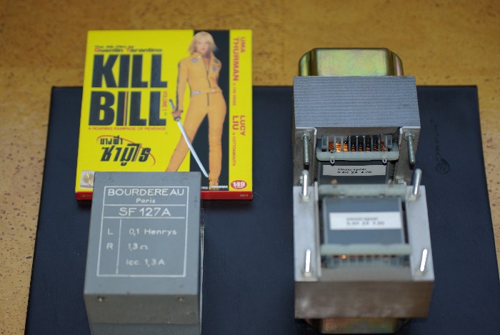

I will try to attach the two chokes i did mention before.

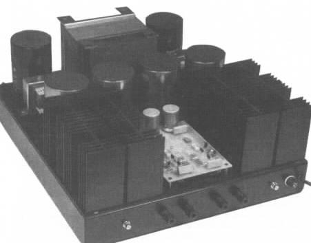

Here are some pics of what sort of thing i am doing,
this one is of another chassis layout you may have seen with the 0.2mH chokes on the top plate.
I think i will use a similar size choke on the interior of the chassis

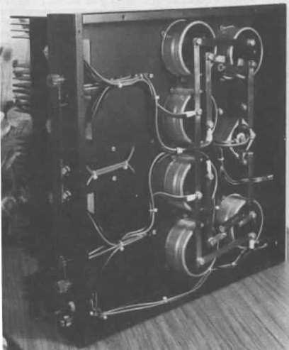

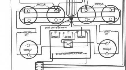

here is approx the layout apart from the values.... i am kind of mixing and matching here basically using the "le class A 20W" supply with more capaciatance and different volts, with inductors in place of the filter resistors (hopefuilly if they fit !!!!!!!!!!!)

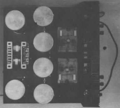

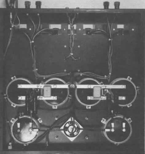

Hello Daniel,
The first photo is the 50 watt kaneda and all the others are hiragas. I did take a closer look at your chassis again.
I think i did mention it before you can create some extra space by mounting the chokes on the inside of the top plate ( maybe using stand-offs and a little mounting plate) Everything above 60 mm will pass through a hole in the bottomplate to allow some extra space. No parts will be mounted on the bottomplate itself. This hole could be covered by a small box-like construction. But if there are electrical wires uncovered it might stay open to allow some extra airflow.. Maybe mount the round transformer on the inside and make a circular hole in the bottomplate and move the chokes to the upper part. this way they could be bigger . I think , i mean i am sure doubling the va of the transformer will give less effect then adding 2 chokes.

Creating a pass through in the bottom will make some extra clearance necessary by using higher feet BUT i think you need that anyway to allow maximum airflow.
I did put the circuit on the inside of the top plate and have a small hole on top to reach the pot to adjust dc offset. I remember that when they were on top , moving a door near by would change the offset not a lot but i could see it on the meter.
