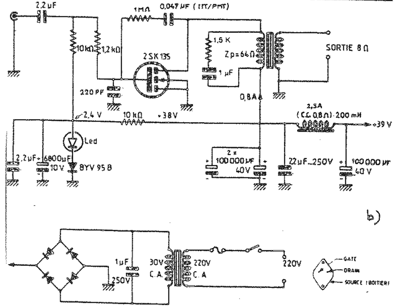

Hello,
The circuit attached is the basic nemesis. The super nemesis has 3 transistors the basic just did have one to3. in the picture there is the choke that was also used for the kaneda and the hiraga.\
Just surprised that this circuit did end up in australia. Even in europe you will not come across lots of nemesis amps. People say it looks easy, very easy but it isn't that easy to build one that will function day day out with the same quality.

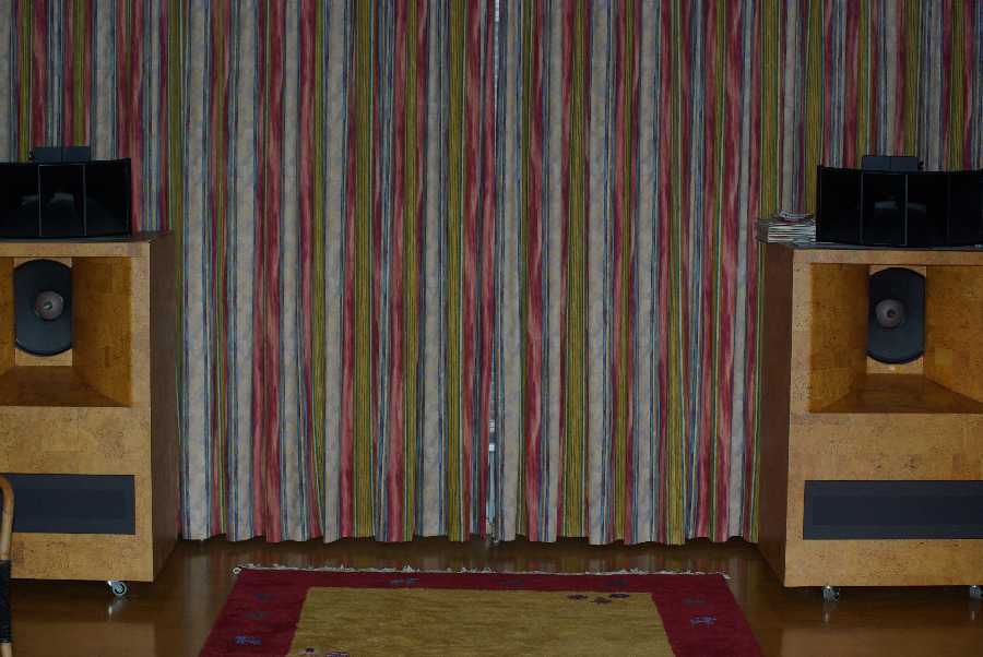

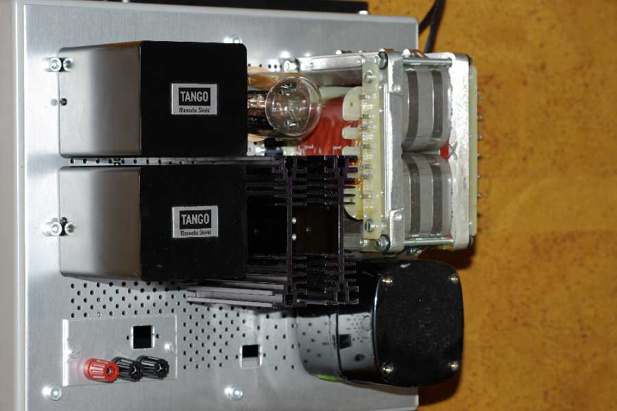

The black transformer is for the heater supply. The double c is for the high. voltage. The heathsinks are for the bleeder resistors. The amplifier itself ( double mono ) have exactly the same chassis for the amplifier itself. Only the mounting plate for the components will be different of course. The grey colour chassis are power coated stainless steel 2 mm thickness bended and welded to function like one piece being thrown away because the client did have his design altered. A pity i did just take 4 because there were at least 50 of them. A nice height allowing the mounting of big parts on the inside as well.. Maybe i will decide to go for a similar design when i will opt for a poweramp with the power supply incorporated. Still struggling to get it finished . It will be a 25 kilo ( The thing in the pic without bottomplate, transformerprotection and some parts inside was allready reaching 17 kilos)up monoraul amp to '' feed'' a tad 2001 above 600hertz with flea power.
Jean Hiraga did convince many audiophiles that using high efficiency drivers is easier than trying to reach the same level with low efficiency loudspeakers driven by complicated high power solid state designs. My vot's are being driven by a line preamp with el84 and an output transformer designed in 1961 for the french broadcasting organisation. Now working with a choke-input power supply and an allen wright shunt power supply. OOOH we are way off topic. Greetings Eduard
