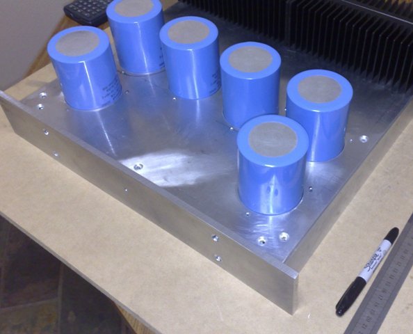

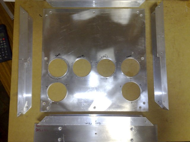

danieljw said:chassis mock up
Very good looking Dan! Not tempted to peel and polish your caps? 🙂

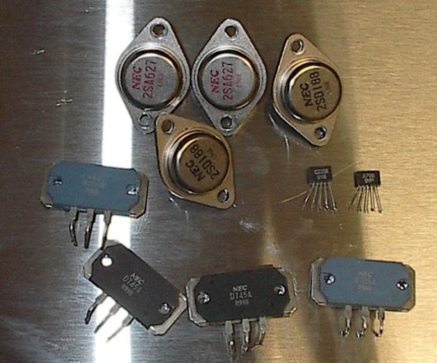

I have the original outputs for this amp (SA627/SD188) but have committed them to the K10A. An intensive search of my junk pile of vintage circuits may reveal a few of the others used in the original.
I'm sorely tempted to build this one.
Hello, These metal power transistors were indeed the ones used in the first hiraga 20 watt version. Because they were no longer available at a certain time they have been replaced by a pair did allow a higher dissipation, so the power supply voltage was increased and because of that there were some minor changes in the circuit values as well. Later the same thing did happen because of the non-availability of the drivers. Greetings, eduard

and these 705/745 jobies were used in Otala's HK770 and few others
hehe - HK770 - two pairs of these , for 60W/ch ........... 😉
