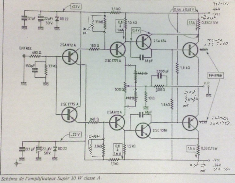

Sorry about that,
Don't know what I was think, here goes with a fixed version

As for the D-33A, Toshiba may have lost its thermister range when it sold Marcon to United Chemicon, none of the Toshiba or United Chemicon websites have any thermistors listed.
Regards
James

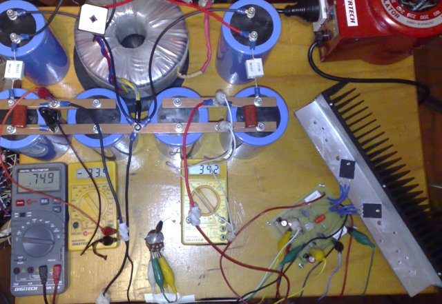

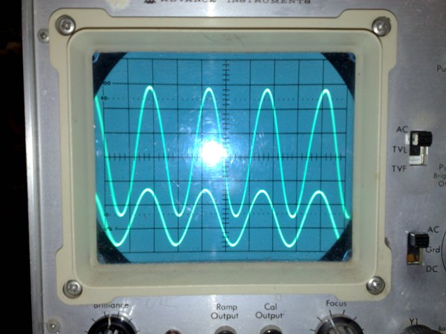

Hiraga class A test setup on the scope
And here is the amp running on the scope.
larger waveform is 10V/div (approx 19Vrms)
load is 8 Ohm resistive
Frequency is 20kHz.
approx 45 Wrms 8 Ohm resistive. Class A.
Those poor little output transistors.
-Dan

Re: Hiraga class A test setup on the scope
Yes, at 80 watts each, they are cooking.
danieljw said:Those poor little output transistors.
- Hiraga 20W class A
