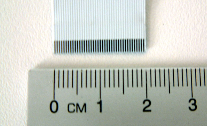

Yeah was good to see the multi meter NOT light up in this case LOL...still not out of the woods though, until I have a moving picture on my wall im still worried, im so careful with my LCD as I have read so many people have damaged theirs in the stripping process, but i guess these FFC just dont like to be bent too many times....
HiLLBiLLY, measure the width of the fcc and divide it by the number of conductors to get the pitch. You can get them here in Australia at Farnell but you have to have an account to order from them. Most electronic technicians will have one so you should be able to get one through them.
DJ
Thanks Dazzla I worked out the contacts and pitch earlier today cheers...I have called everyone I can think of an have been unable to find one, to be honest have been unable to find anyone that knows what a flat flexi cable is! I have tried various larger establishments along with some local technicians with no luck. I dont have a credit card so I cant order over the net with that or paypal so Im seriously stuck now unless I can find somewhere that accepts bank transfer :: sigh :: So close yet so far....
40 pins 0.5mm pitch

Theo Julienne from Lumenlab Australia has offered to organise the FFC cable for me through bank transfer. I will still be looking within Australia as the one Theo will be getting is comming from USA . Least I will have spares if I do find one locally 🙂

mouser.com has your FFC in 3" or 6" length. From the picture you posted, it looked like yours is about 3.3" long, so you would have to go with the six inch version. (I doubt that would bother you!)
Mouser # 538-21020-0435 (Molex # 21020-0435) $4.42 US for quantity 1
If anybody else is looking for FFC cables or extensions, check out catalog pages 818 & 819 Molex FFC/FPC Connectors at mouser.com
I use the vertical SMT ZIF connectors to clamp two cables together to make an extender. Those run in the $1 to $2 range per connector.

The cable is another set back...not to worry I have another one ordered and should have it in a few weeks 🙂

Oh..Guy the cable I have ordered is of the 6 inch variety to mate 🙂 Will give me some extra length to play with this time 🙂 Was a little more than what you pick them up for unfortuneately but Theo was kind enough to organise a bank transfer for me so im quite happy to pay a little extra for his effort/trouble. I definately would have taken you up on your generous offer to Guy if I had means of getting the cash to you ie. paypal or a credit card...bank transfers to overseas accounts cost alot extra I have been informed so that would have cost more than the actual cable lol...thanks again though for that generous offer guy 🙂
