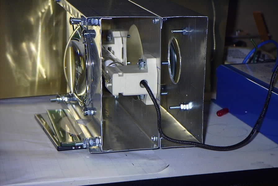

Couple of things that you may like to try with your lightbox Steamer if you haven't already...I found with the reflector as close as you dare to get it to the lamp yields the best results (did for me anyways) Just a thought bud 🙂 Also...If you look very closely at my light box in particular the bracket holding the condenser lens in place you will see i have used a spring on each threaded rod so as the tension on the condenser isn't such that movement due to heat and expansion isn't possible. Very simple very cheap and maybe not needed but good insurance IMHO to purhaps, avoid "exploding" a lens due to it being tightend down too much or un-evenly...food for thought anyways bud 🙂

Oh...also just had another look at your light box mate, looks like you are also using 1mm aluminium for it, I found an excellent way to cut it is with a stanley knife (think Americans call them box cutters) Use a steel rule and run the blade several times along the desired cutline using medium pressure, then simply bend the aluminium a couple of times and it will snap leaving u a perfect cut. For bending, make one medium cut along bend line, then hold the rule against one side of the line and bend your aluminium, you will get an excellent "sharp" bend <---LiL' bit of advice Ace handed to me, give it a go mate you will be impressed with the ease of it and the end result 🙂
That's good info, "mate." I had been using general contractor's tinsnips. the first cut goes great, but, soon as you get into the material a bit, they get preeety cumbersome, LOL! I'll try the knife bit. I got a steel straight edge thatshould work out perfectly.
