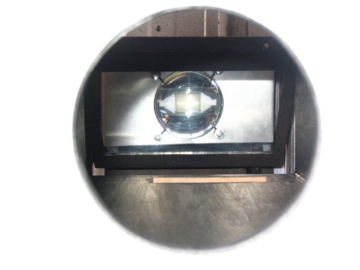

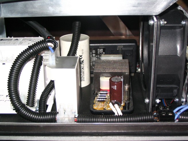

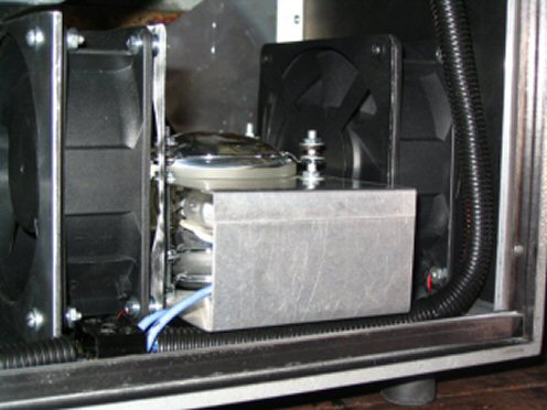

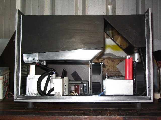

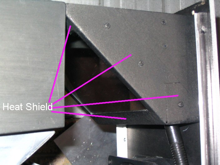

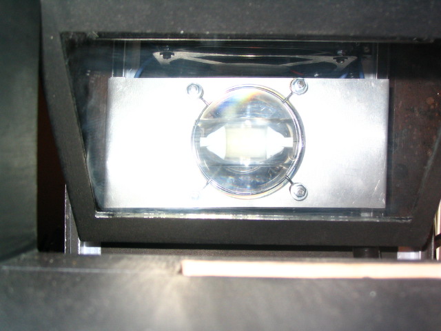

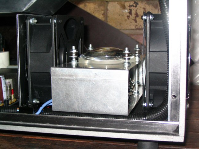

Well....Still hot here in OZ, and still no "working" projector as far as screen shots go. Upon looking over the PJ and thankfully speaking with Ace da man, he bought my attention to a fact regarding fans that I knew about, and thought I had taken measures against (and as u will see in pictures to come) was entirely un called for LOL ...but better safe than sorry. For those that aint aware...a fan has a dead spot the size of the centre for approximately the length wise of the diameter. (hope that makes a lil' sense) In front of that before mentioned centre of the fan. To account for the heat issue in my current design I did place a cut out of ali on the centre circle of the fan, but after speakin' to Trev and thinkin' of the close proximity of the fans to the lamp i fabricated a heat shied for both fans...he's a couple of pic's of what im trying to explain. (yep me mate came to the party and dropped by his digital for ma again hehe)

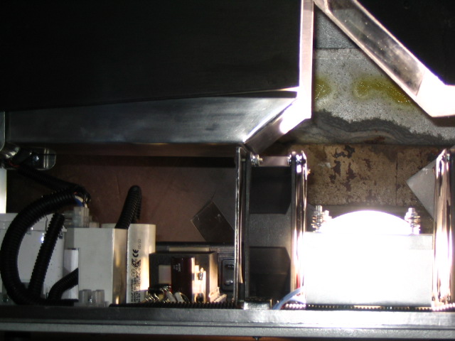

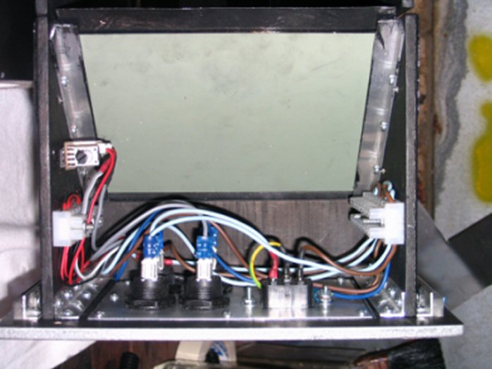

Fabricated the frame to hold the mirror in place also, combined a lill' heat shielding into this also, was preeety happy the way this came out... it is made of one piece of 1mm aluminium then hit with 850 degree heat resistant paint...heres a pic of what im on about.

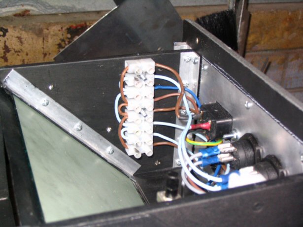

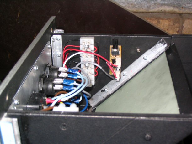

The wires ended up in the mirror box, again as in the last PJ I utilised terminal blocks to connect the wires, also incorporated the fan speed controler in there to "Tame" the big fans...have them running at around 1/2 speed...more on that in a bit...looks a little like this---->

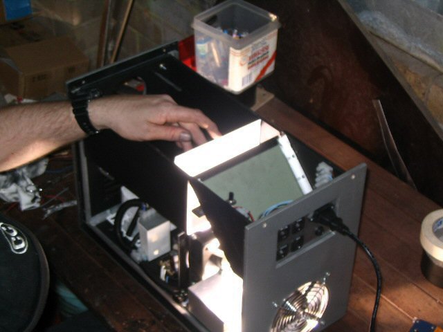

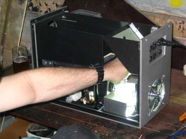

Was rapt got it right .... and everything worked LOL dialed in the fan speed controller to have the fans approx 1/2 speed and ran the lamp for 30 minutes... After letting it run for this time I could actually put my fingure on the centre of condenser for a good 30 seconds before it got too hot! I could leave it on the outside of the condenser indefinately! My mirror doesn't even get warm...period! the fan heat shields get luke warm!
