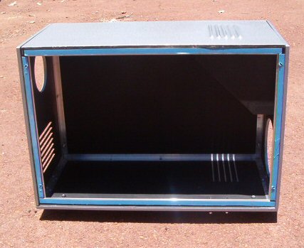

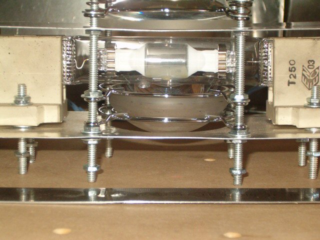

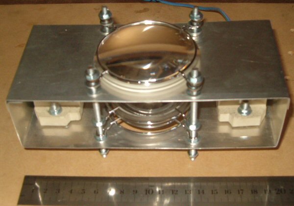

Well...Little behind schedule but things are comming along nicely with my new PJ, and I did tell ma 'thrifty' lil' Canadian bud Ancorp I would have some pics for him by the weekend, he has been following my projector from day dot so I have a few little 'teaser' photos of the construction of the new box...no screen shots, I have the camera though till 5pm tomorrow and the projector I envisage will be completed by mid-afternoon...So I will post some screeni shots of the projected image along with the interior layout etc of the PJ...for now, this is what and where im @ and what I have pics of...Hope they are of interest to you Ancorp...and of course others on the forum 🙂
First pic is of the light engine arrangement, not fully adjusted at this point...tweaking of distance will come tomorrow, it is as you can see fully adjustable

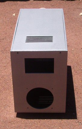

Heres a pic of the rear of the box...top rectangle is for the switch and power supply oh and of course s-video connection... lower hole is for the exhaust 120mm fan, I have a chrome fan grill for this also...Ill just ad, the box has not been assembled and tightend so you will see some gaps, they aren't there when fully assembled, I have added rubber insulation tape to all angles, the blue tape will be removed when PJ is assembled tomorrow...The rubber makes the box air tight, thus all air will ducted into case via the grills witch will have fan filters....
Close up of rear, with switches mounted, pic doesn't show this well, but the alumiimium is on the interior side of the mdf thus switches etc are recessed...For those wondering why 4 switches...top left is main power...second is fan...third is light and last is for the LCD...a timer control for fan will also be added down the track
Ok...guess you want a squizz at whats inside hehe, as with the last PJ I made I have again incorporated alumiinium angle into the constrution of this box, again all joints are mitred, Interior is flat black 850 degree heat resistant paint... the box in the right is for the mirror, the electrics will also be housed behind this, not in photo is the LCD chamber ...that comes later... lol
best ad a pic of the front to...the two vents have been recessed into the mdf, filled, filed and sanded so they are completely flush, will take some closeups tomorrow of the completed interior along with some screen shots of the projected image...hope this tides ya over for now Ancorp hehe ...
