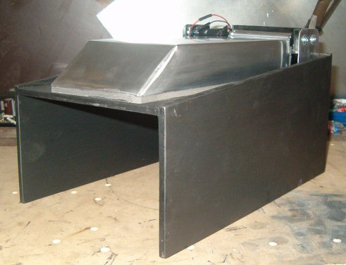

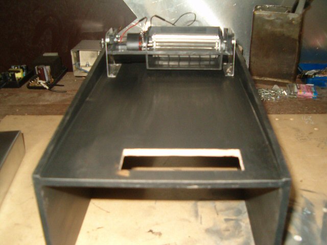

First few pictures show the fan duct I made from 1mm aluminium plate for the cooliing of the LCD, Im using a 100cfm "blower" fan I used on the light box on the last PJ... The ducting is bent and epoxied on all corners and fixed to the LCD chamber via doubleside adhesive rubber.
First pic chamber in upside down postion and blower fan in place...
I took more pictures of what I got done today for you all to checkout.

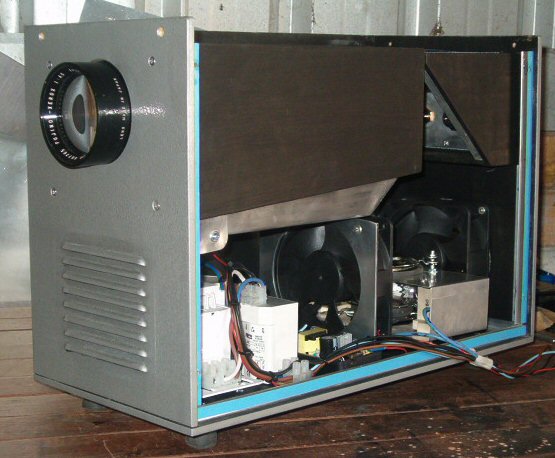

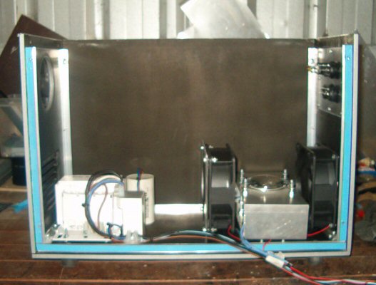

Front/side shot of whole PJ...this is where I stopped for the day...soz guys, the heat and a long day just got too much, I have the wiring too complete and really don't want to rush this and its best i'm fresh when i start on it, so for today i'm afraid this is it... 🙂
Hope everyone that views the pics finds them of some interest, I can't see any reason why It wont be complete tomorrow, fingures crossed all goes well, shall borrow my friends camer during the week and post some screen shots of the totally finished interior, and what Ancorp next to myself has been most anxious too see shots of the projector in action....hehe

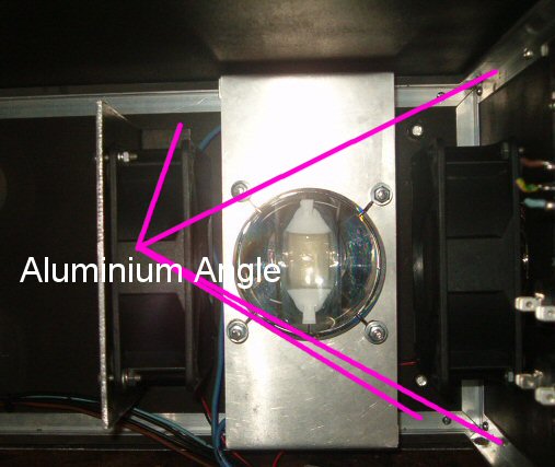

Is the MDF reinforced with aluminum extruded angle shape along each joint?

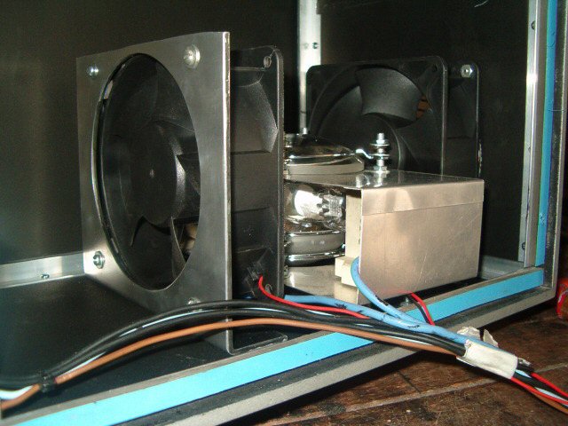

I have one suggestion:
If you moved the fan to the other side of the light engine, then it could pull air through it, past the bulb and condensor lens, before dumping it outside the box. Right now it looks like some of the air heated by the bulb will head up to the LCD area. Not a very good way to control the heat!

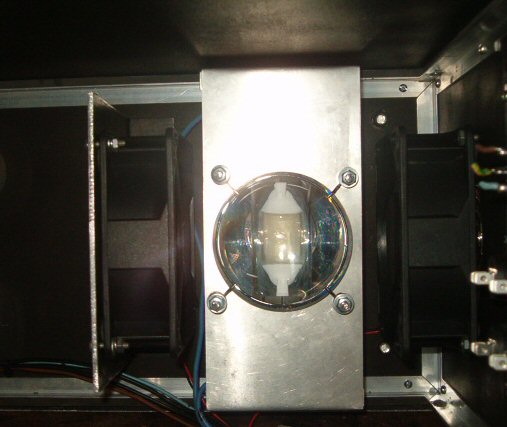

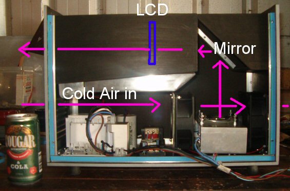

Hrm dunno what you see there Guy but in the pics its preeeetty easy to see there is aluminium angle on the joints, as for the fans set up it is set up in a push pull so cold air is sucked in the front of the case blown over the condensor lens and bulb before exiting the case! Where do you propose I move the fan? I totally don't follow what you are on about bud...might wanna take a look at the setup again mate 🙂
OK, Now I see it!
I couldn't see the second fan on the other side of the light engine, until that last photo. Very nice. Although, I wonder if you really need the pusher fan. I guess you could try it with and without, if you added yet another switch!

🙂 No probs there Guy, possibly one 120mm would do it, but after the last PJ heating issues im covering my bases on this one so too speak hehe, I have a fan speed control lined up to control all the fans so they wont need to be at full speed, I guess with the two the air flow direction will be very precise and maximum cool air will be forced across the light engine and pulled and vented directly out the back 🙂
The Aluminium is used on every joint of the outer box and the mirror box Guy, I like using this for the strength it ads plus it keeps the box square 🙂 I use only 6mm mdf for the boxes to keep weight down, screwing and glueing isn't really a way to go with mdf this thin I believe. Anything over 10mm would be ok to glue and screw I would think 🙂 Mitre joints are marked with 45 degree template and thein I use a cuttoff disk on my dremel to cut it. They sell whats called a mitre box here in Australia @ hardware stores, I presume you would have something similar in your neck of the woods, maybe you could try one of those to get your mitres precise ;-)
