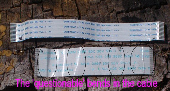

Unfortuneately I have had what might turn out to be a major set back :-(
I finished the PJ yesterday and powered it all up, the LCD aint showing a display screen, I had lights on the button panel and on closer inspection I realised I had hooked the ffc cable attaching the small panel to the large control panel incorrectly (had it upside down) The way the panels are mounted in the PJ meant twisting and bending the ffc cable (several times) to get it in the correct position, Im praying I have only broken a ffc cable and done no permanent damage to the other hardware. I was speaking with Trev about it and he does'nt seem to confident that the ffc cable is the only problem which aint to reassuring :-( I'm taking it to a local electronics technician this morning hopefully he will have a better idea of the damage/problem I have done, I don't want to fiddle with it anymore myself testing it incase I do even more damage to it. If it's not repairable (cheapily) I'm afraid it's going to be a long long wait before I have the funds to purchase parts to fix it and/or a completely new Lilliput.. Shall await the outcome of the verdict handed down by the techniician today, but not to happy bout it all at the moment :-(

FFC cable plugged in upside down
All the FFC cables I have seen are single-sided. If that is the case with yours, then plugging it in upside down would be the same as not plugging it in at all. I doubt that you could damage either the controller or LCD driver board by doing that.
Hopefully, you just busted the FFC. If the tech finds that is the problem and you have no local source, replacements are available from Digikey or Mouser, with no minimum charge. If they balk at sending them to Australia, let me know. I will get one for you and then airmail it in a letter.

"All the FFC cables I have seen are single-sided. If that is the case with yours, then plugging it in upside down would be the same as not plugging it in at all. I doubt that you could damage either the controller or LCD driver board by doing that."
This is nearly exactly what I explained to Trev but he was saying thats not the case that there is metal on both sides!! Thankyou for the offer to airmail Guy, hopefully it wont come to that I will try to source them locally, sometime back a fella from Perth posted he could get them locally the thread i believe has since been deleted as I can't find it! I rang the technician and he is willing to have a look @ it but was unable to do so today as he had house calls to make for the day. My impatience got the better of me LOL so I took Trev's advice and ran the multi meter over the FFC cable in question and got the results I was hoping for, approx 3 of the wires within the cable are still functioning, the rest are dead..so to speak hehe. So that's a little more encouraging.
Took a pic of the cable in question---->
I shall have a ring around now and see if I can locate them, when speaking to several Technicians this moring they didn't know what I meant by an FFC cable, are they called anything else in the industry?

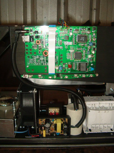

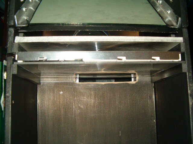

Here are a couple of pics of the mounted LCD and boards...
And the reason the cable got bent in the first place was due to mounting it on the opposite side of the LCD chamber than previously, It is lined up perfectly however the metal on the cable is facing the wrong way hence I "maipulated' LOL the FFC to invert it to be correct way around, I think if i did this once instead of half a dozen times I would have been ok!
How good does that feel to have the problem work out to be a minor one!!
