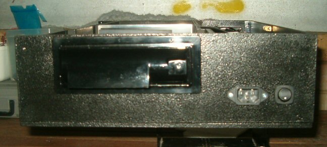

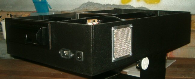

Right rear shot...

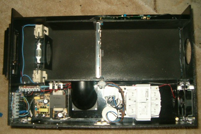

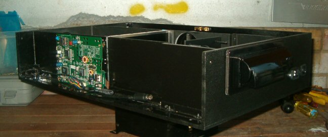

Rear shot... I removed the fan speed adjuster from the fan and relocated into the elctrical compartment of the projector...i have set it approximately 3/4 speed and she is whisper quiet now 🙂 Fan is mounted on double side rubber tape to prevent vibration (as are all fans in projector. When i was testing the fans i blew a lung full of smoke under the PJ it was sucked straight in by the intake fan and choofed straight out the back at a great rate of knots lol...
Well...thats it for now fellas, my next picture post will hopefully be of a working projector 😛
Still a couple minor things to do as far as construction goes, a lens holder, stand, s-video extention. The top and side has been finished and painted but i will mount that last as the top is hinged to the side and would make working on the thing a little cumbersome.
Hope you found the pics of some interest guys

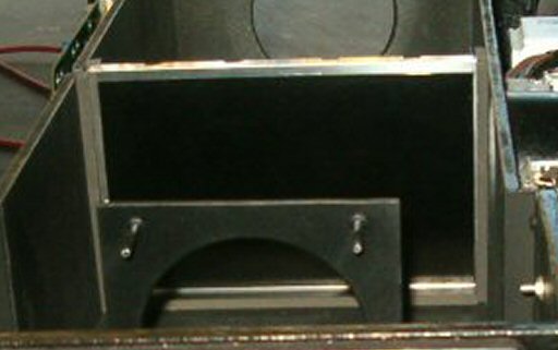

Hey Hillbilly! Your projector's looking great! I am in the process of building mine too but I'm in a slump right now for constructing an LCD holder for a split fresnel design. Since I have a Lilliput too, can you tell me (or show me) how you made yours? If you wanna talk, I'm on AIM as thenewwon. Keep up the good work!
Thanks frozenbum87...my lcd 'holder' is about as simple as it gets bud...i purchased sponge type tape with adhesive either side and simply stuck a strip either side of the LCD to hold it in place. The LCD chamber i made 167mm wide so the frame and LCD simple slide in 🙂 I have held the control board in place with mother board mounting spacers and screws... I will also hold the glass with UV filter and the two fresnels in place in this manner, the stuff sticks like s**t to a blanket and is a convenient 10mm diameter. Soz mate i dont use aim...i have msn and am contactable on that aussiejester@hotmail.com...
Blew one of the pics i took yesterday up so you can have a closser look at how I have done it...
Hope this helps mate 🙂
