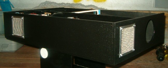

Bit of an update on my projector fellas...I pulled it apart and painted it, have decided to go with black instead of the silver (silver didnt look good was different colour than cap on the can) I have used a fine sponge roller to paint it and it has given a hammer tone finish to it..looks good i think. Borrowed ma buddies camera again and took some pics for you all too see. I have also got the LCD mounted now, the fan surround at rear is also finished...unfortuneatley though...am still waiting on the lenses, i got a feeeling this might be the week they arrive, fingures crossed 🙂
Anyways here's some pics of her all painted up and pruuurty like hehe
