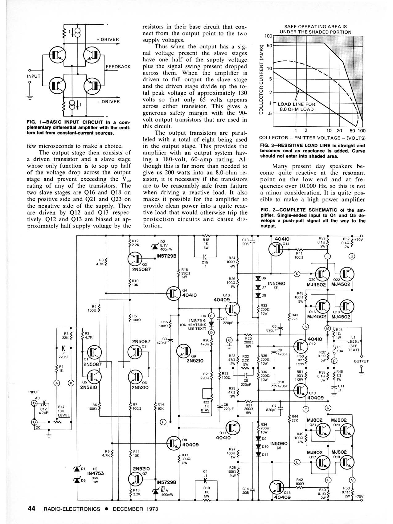

I have now taken a closer look, and the circuit looks very familiar to me. And yes, you could buy exactly this circuit as a finished module in Germany for a long time. Not exactly, but slightly slimmed down and with a switch-on delay: OCL-950 from Monacor. This is now all decades in the past.
Many thanks for the original schematic, I remember the performance - without blame.

That s somewhat equivalent to a diamond s buffer since the drivers emitters resistances are tied to the opposite supply rail.
On the left is the schematic published by SGS, surely on the footsteps of Moorola and also Fairchild who made AN
using this topology, on the right is the drawing from a french review that used SGS schematic without any mod.
This topology was very popular at the time and was recycled among other by Monacor and later by Elektor as basis
for their their half baked Crescendo with a cascoded VAS, it was also used by commercial brands like Nikko, Rotel and Luxman.
As you can see it make more sense than the australian design that try unsuccessfully to drive a symmetrical VAS using
a single differential, this was done by Sansui circa 1976 but in a more complexe maneer, to summarize they inserted such a symmetrical differential between an input single ifferential and the VAS, and guess what, they called their topology diamond,
here their schematic FTR :

The SGS amp is from 1976 and is originating from a previous Fairchild AN, wich itself originated from a Motorola
AN from 1973 wich was published in Radio-Electronics, Leach has nothing to do with the original idea,
he got the credit in the US public because he popularised this topology there but he was unknown elsewhere.

wahab - The Motorola amp had a shunt capacitor C3 whereas the Leach amp loaded the VAS with R20 and R21. The Leach amp had wide open-loop bandwidth.
The original Leach amp relied on junction capacitances to bring the gain down to unity. That could not have been reliable. Leach switched to Miller capacitors on a later version.
Blujay - Power transistors did not have high enough voltage ratings at the time.
Ed

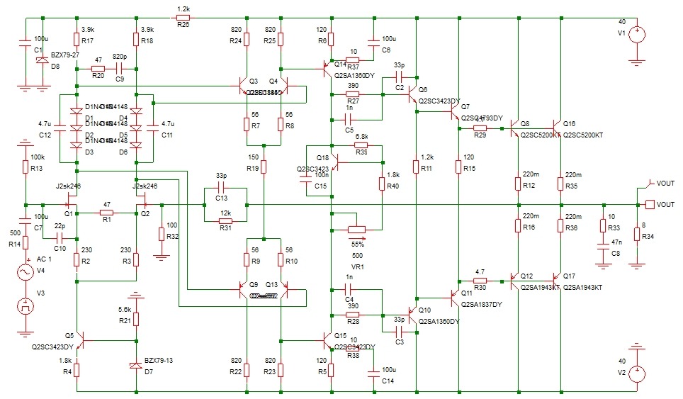

That is the crucial point, the biggest mistake - not just the biggest (alone) and only one.As you can see it make more sense than the australian design that try unsuccessfully to drive a symmetrical VAS using
a single differential, (...)
But how can we transform this menu into a satisfactory result using the simplest means and without going beyond the given component framework?
The automotive industry is a prime example of this approach: Beating nonsense to some kind of market maturity at all costs.
In the late 60s there were still designs that were some trials and errors, there s scores of exemples.
This design is of the same wood, it s not well thought, it has even more hidden drawbacks than you think and that
i discovered through sims, hence why i discarded the thing.
Capacitive coupling for the IPS and VAS is a no go, with the latter being a voltage rather than current controled stage
that require the IPS to have a minimal output voltage swing capability otherwise the amp output will stick to one supply
voltage rail, that s just too much bad enginering from the start, the only reasonable approach that would be a testimony
of good enginering capabilities is to keep it in the museum of electronics horrors.
