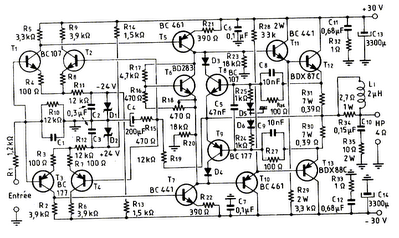

high performance 25W PowerAmp

Any arguments for "this schematic has great potential and is worth modification or upgrade" ?
The input stage looks so very basic that this might be more a simplified concept schematic than a circuit ready to built.
Dear Bernhard,
would you like to continue working on the L. Stellema design and make it a success?
25W with a minimum of components and really high performance - I'm really stumped, it seems to be a waste of time.

If we (want to) continue working on this topic together (and stay with the choice of transistors, the original, a possible output stage); the circuit will undergo some radical changes, I am completely convinced of this and have been from the beginning.
Every analysis needs a beginning and this is / was the article.

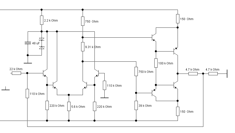

A quick interjection as a picture attachment.

Assuming that our raft doesn't sink again immediately, now would be the time to follow L. Stellema's recommendations and give the IPS and the VAS (both sections are unfortunately voltage-boosting - and this has unpleasant consequences, as D. Self clearly points out in his printed work) an AC load in accordance with the T.I.M. doctrine.
Obediently, we must now torment the two-stage IPS-VAS combination so that its bandwidth and local gain are lowered in accordance with the legal text.
In the final step, we close the loop (i.e. counter-couple, call it nfb).
Now, at the latest, a light comes on - and Hagen already suspects the consequences of his actions.

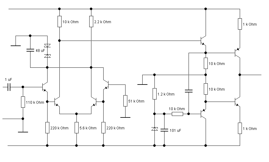

So Q5 and Q6 provide a current source drive for output transistors Q1 and Q2. The are not temp compensated and probably not matched. Only 0.6 volts across R7 which give a little less than 100mA and quite influenced by temp.. Tendency is to give higher bias at high temp which is not the right direction as Q1 gain goes up with temp
The only advantage I can see is a virtual constant drive source independent of output magnitude.
To improve that schematic and not morph it into a new amp, I would keep the function blocks, just pimp the stages going from left to right.
Start with the diff pair.
Maybe integrate the first with the second part to get rid of the two coupling caps.

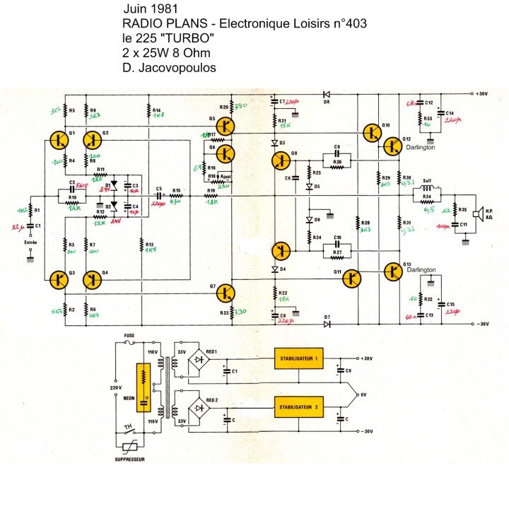

If one want to drive a symmetrical VAS then a symmetrical dual differental is the simplest way to have things
working correctly, here s SGS Ates take of Otala s ideas, 52dB OLG and 100kHz OL BW with 24.8db LG,
their AN was first pusblished in 1977 in a french review who recycled it in 1981 unchanged, notice the diamond buffer.
Reactions: hbtaudio

Dear wahab,
I have now taken a closer look, and the circuit looks very familiar to me. And yes, you could buy exactly this circuit as a finished module in Germany for a long time. Not exactly, but slightly slimmed down and with a switch-on delay: OCL-950 from Monacor. This is now all decades in the past.
Many thanks for the original schematic, I remember the performance - without blame.
greetings,
HBt.

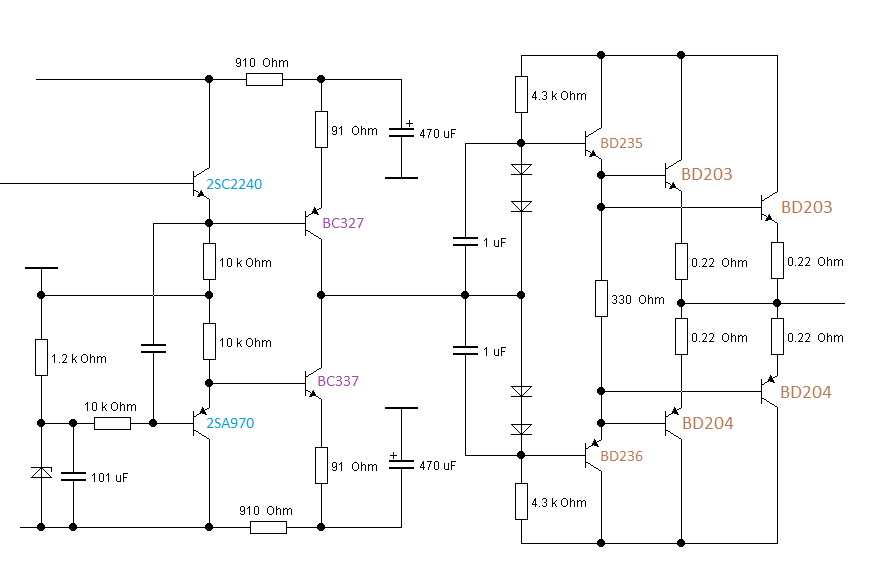

Would anyone like to go to the trouble of modeling the original power amplifier and running extensive simulations, as per my initial post #1 ?
Unfortunately, I'm tied up this weekend. Do we even have correct SPICE models of the BD203,4 & BD235,6 BJT's ? Who would like to contribute them ?
