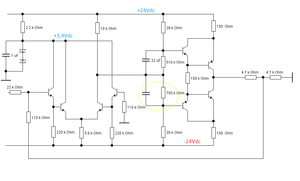

Quite apart from hearing as an alarming and locating sense, yesterday I made the first simulation of the L. Stellema circuit (which I jokingly called "Tim" temporarily, because of the T.I.M. Spirit at that time). With the identical results that wahab has already made clear. The cause of the unwanted oscillation is also quickly identified, it is causally related to the doctrines (or design recipe) of the time. Simply put, the main problem is the chosen compensation method of the frequency response, of course the topology also looks very strange - and Ed's objections and displeasure are valid, but can be corrected.

Road map
I think with these two quick sketches you can identify both the causal problems and the solution in plain sight - without having to name them explicitly.
Theoretically, nothing oscillates anymore, not even sporadically, and the bandwidth is greater than or equal to 1MHz.
Power must be supplied with constant, regulated +/-24Vdc. As has already been comprehensively established.
That would now be my first step in approaching the project, again completely freely, innocently and intuitively.

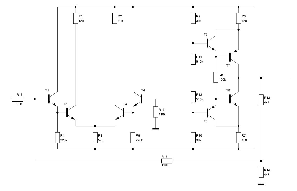

A further thought, what if:
if we now add a suitable (push-pull output stage, not a diamond or a diamond after all?!) output stage to the rear, extract the resulting error and subtract, add or multiply it back to the front -> feedforward for /or intervene to correct the error.
We automatically rotate the phase again and at the same time isolate the stages from each other, but also take them back into the control loop.
After some sims i came to the conclusion that the more you want to improve the design the more it will gradually converge
either to a classical blameless or eventually to a symmetrical dual differential IPS, with both yielding either better perfs
or equal perfs but with a simpler and better working schematic, and with a lower component count in all cases.
The main culprit in this design is the VAS that AC load greatly the IPS and that also reduce its DC GNFB because of the DC
voltage attenuator at the VAS input, not counting that its topology is not compatible with an energic miller compensation
unless using huge caps that will increase greatly the distorsion.
The most elementary intelligence would aknowledge that trying to improve this design amount to trying to get a race horse
out of a stubborn donkey, and that that the design is just too flawed from the start to be worth the effort, but still, we can discuss about the causes of what is obviously a stratospheric failure from those Sydney aeronautics enginers.

Oh dear - that was actually clear from the start. The deeper we question, the more we end up with Self's blameless approach, economical, simple and elegant, with really excellent results.
I'm very sorry, after all I dug up the article by accident. Hopefully you won't find your study of L. Stellema's circuit diagram a waste of time now.
hbtaudio - No need to apologize. L. Stellema's circuit was an interesting look back at history. I learned that the diamond buffer was named after its inventor. 🙂
Researchers advance the state-of-the-art by starting from the state-of-the-art. Put your efforts into improving those amplifiers. This board has several state-of-the-art designs.

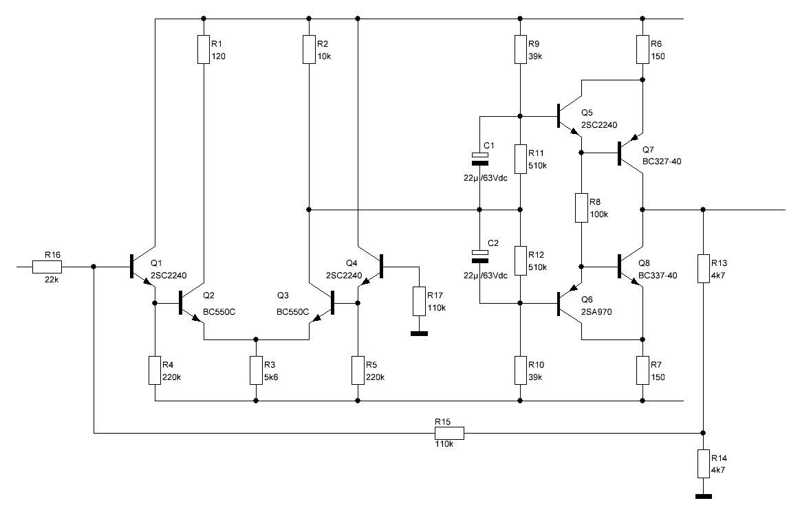

Starting from absolutely constant operating voltages of +/-24Vdc, I'll take another static look at the potentials and the load on the IPS (Q1 to Q4) by the VAS (Q5 to Q8).
And if there is no reason not to take a further step, I look at the dynamic case at steady state.
I am not yet ready to give up, well aware of all the adversities of the original and listening to the cries of warning
R1 now 13k6Ohm for better balacing.
What kind of garbage? But I don't want it to be true.
R1
absolutely has to approach zero, otherwise the oscillation will be there - and as we already know, we can't compensate sensibly.
R12
must be greater than R11, otherwise an almost symmetrical modulation between the rails is impossible.
We can actually save ourself the test setup. I wonder whether the original ever really worked reliably. Let's see if I invest some more time, one obviously have to be very tough for this circuit.
Pretty cruel.
