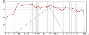

In other words... it will be really hard to correct using DSP...
Still a set of real world measurements would be helpful. Looking at the scale on the dB side of the Edge plot shows a less deep 'predicted' dip than in reality. A ~1 dB downwards swing compared to at least 5 dB measured. Leaving the lower bump out of the picture for now which is 2 to 2.5 dB.

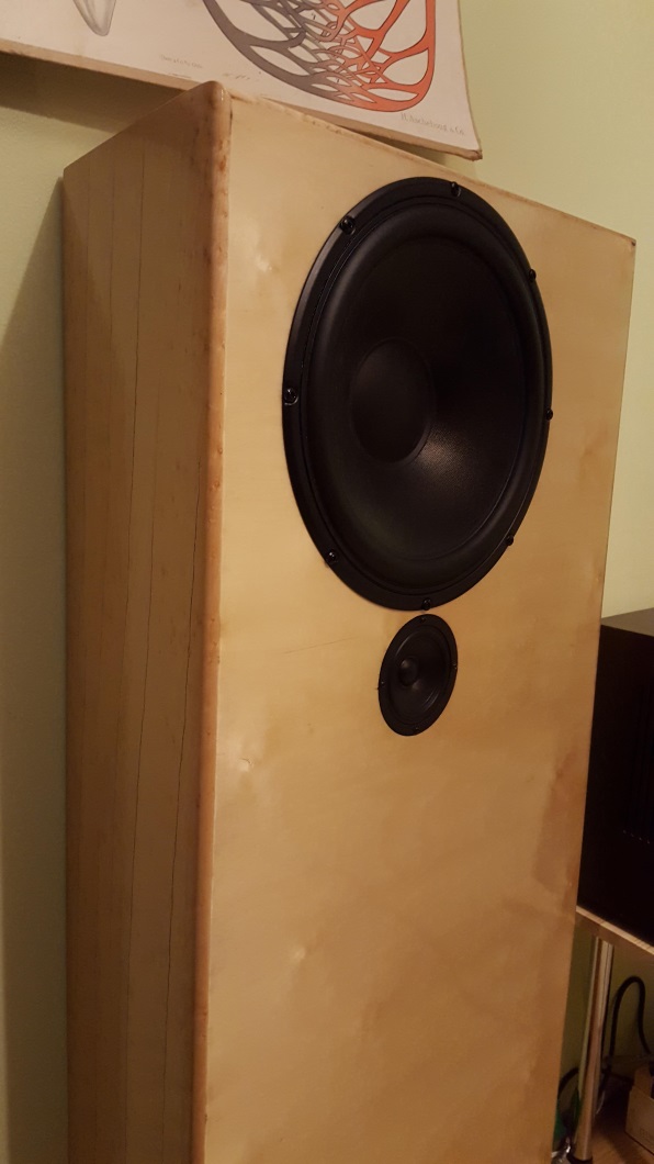

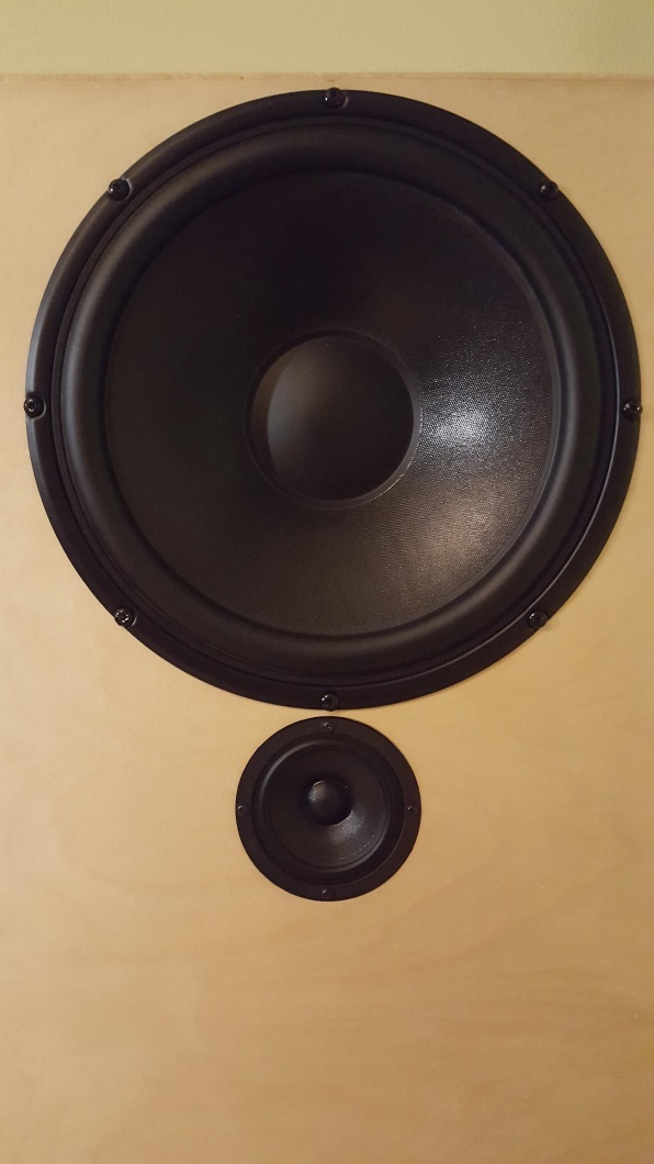

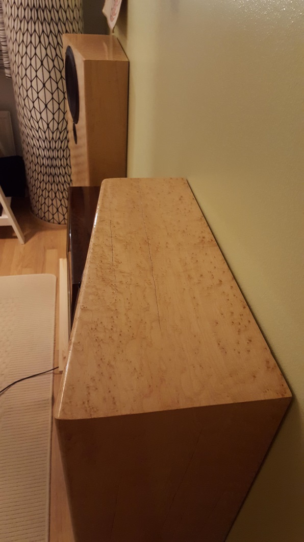

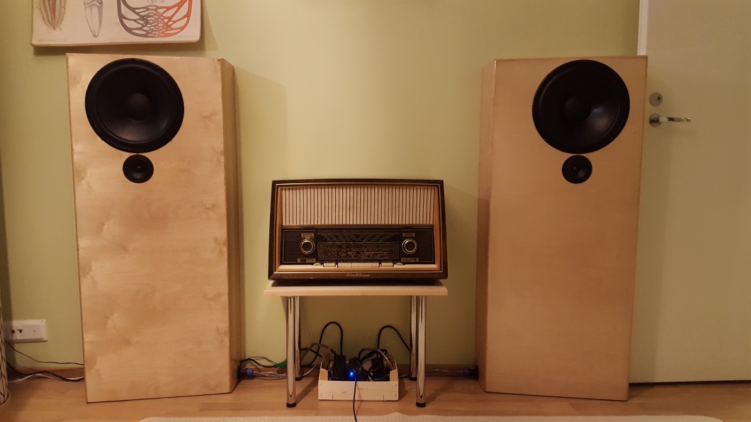

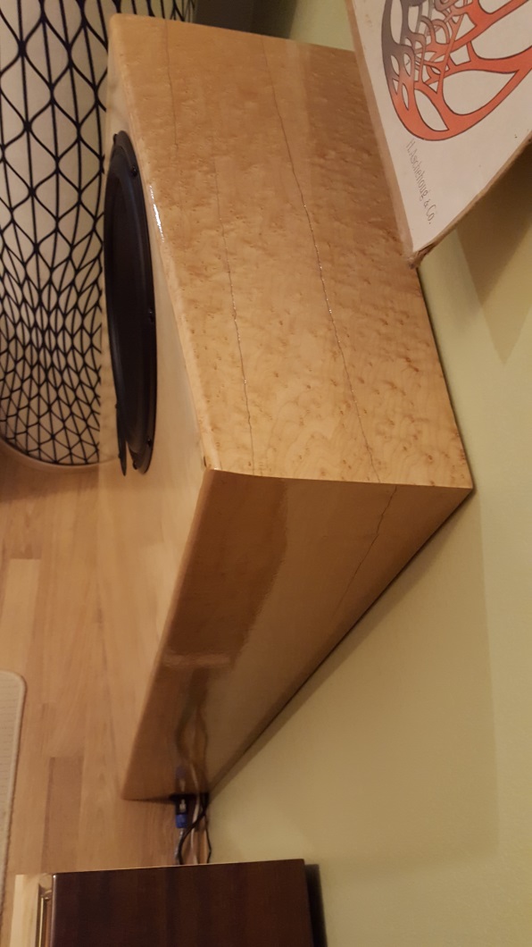

Well, that's a blow. Everything was sailing so smoothly already. Have to take some measurements at listening spot to see how it works in there. Anyhow, here are some pictures of the speakers themselves. The surface is Baltic Birch plywood on the front baffle, sides are veneered with Birds Eye Maple. Surface is high-gloss lacquer. The mess of wires is my placeholder amplifier, two Sanwu TDA7948 driven by 24V 5A bricks and the MiniDSP. The radio on the middle is inheritance from my grandpa. Still has the original receipt with it, too bad the warranty has already expired.

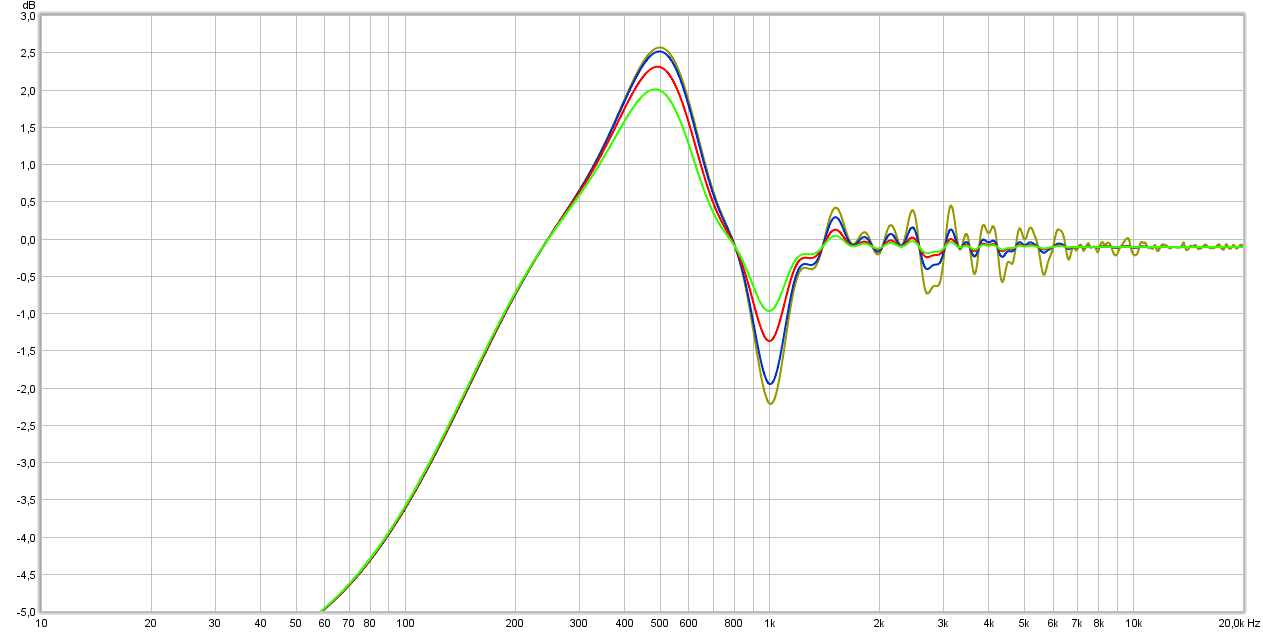

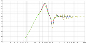

One of Jeff Bagsby's speadsheets can count in the roundovers so did a rough quick and dirty example for offcenter 10F on 50x120cm baffle with 0/1/2/3 inch round-overs and exported as frd files to have them presented overlaid in REW, first plot is at 2 feet distance and second is 8 feet distance.
This does show improvements. But again the scale of it is between -2 dB and plus 2.5 dB and round overs does win you quite a bit (about half of the total value) on the dip.
It also shows us why you'd want to measure at the listening position or at least at listening distance.
If I remember right from exercises in past having a baffle that is not so wide means the broad and lowest in frq high peak goes away transfering into a more gentle roll off point and then if combined 1-3 inch round over, diffraction and baffle step will look very smooth almost perfect and acceptable.

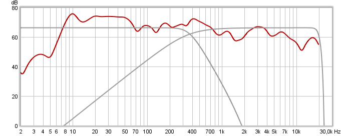

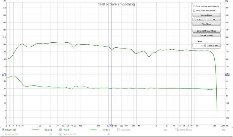

I tried my Line Array FIR recipe on this RAW measurement and it looks like this: (that's the one labelled "On", prediction of the results)
attachment.php
I guess I still like my own recipe's 😀
But it's good to note the dip at 2 KHz didn't get fixed by my "usual" FIR recipe. But look at that phase plot 😉

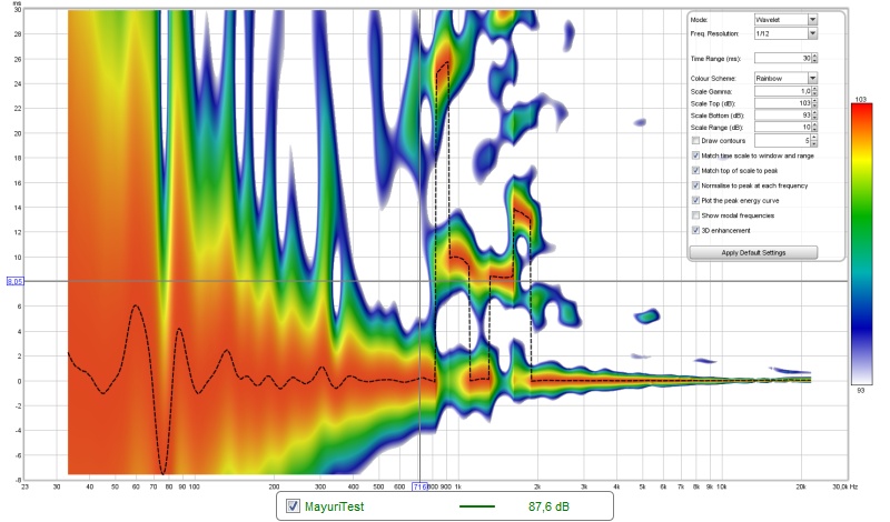

The wavelet of that prediction:
attachment.php
