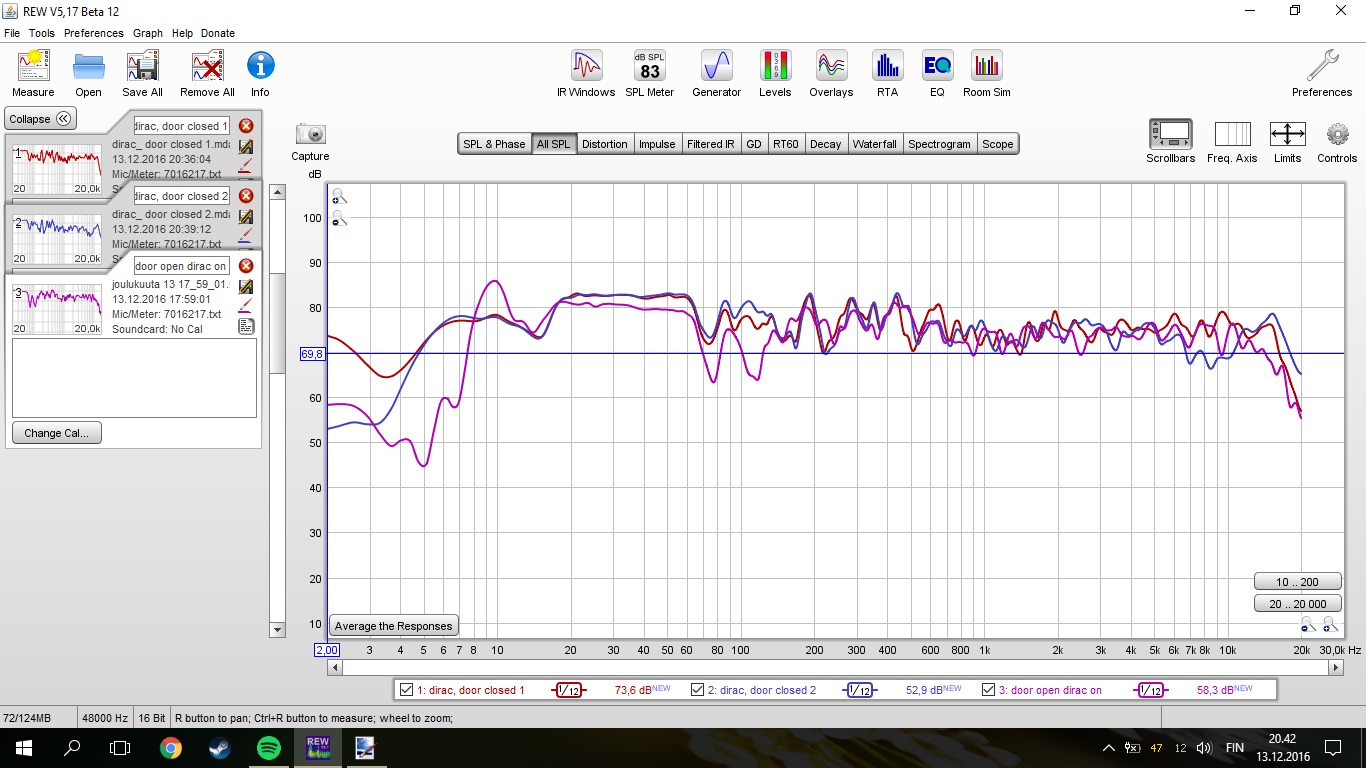

Made a tremendous improvement with the 70Hz null with a very high-end trick... I closed the door to the room 😀 In the attached picture you can see how much effect it had. They are with calibrated dirac filters, so the door open part compensated the huge drop by setting the overall level lower. My listening chair swings back, so I also measured the door closed position in two ends of the swing (red=no swing, blue=full swing.) The raw files are behind the dropbox link, as always.
https://www.dropbox.com/s/9vzrrmqvct0ctyb/door.zip?dl=0
At this moment I think I'm done with furniture changes. I can't move my speakers out from wall, and with listening tests on 70Hz sine wave I've located the best position for my listening chair. Next step would be messing with digital corrections 🙂
But for now, time to relax and enjoy the fruits of my labour. It might look relatively small, but the improvement on the drums in songs is very audible. I enjoy my setup immensely more this way.

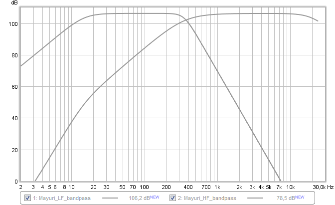

Because we have support from wesayso about in room acoustics knowhow and experience still think would be so great to go after correct band-pass target slopes at listening position to see how this perform instead of the often used near field or pro anechoic ones that never would perform those targets at listening position. Then find correct delay to offset system and then go for your preferred tonal curve and maybe build that up upon B&K curve to get a feeling.
Here my 2 cents for planning that think sounds reasonable:
1. Get these two Harsch XO band-passes right at listening position, LF one is 15Hz BW2 - 350Hz BW4 and HF one is 350Hz BS2 - 20kHz BW2, they made over a 48kHz IR-wav file so as to replicate your UMIK-1 sampling rate and as you can see system HP 15Hz is included to mid-tweeter and so is system LP 20kHz LP included to woofer even it real only moves a bit in phase. Find these two target curves attached for import to REW.
attachment.php
2. Now find and correct right delay for mid-tweeter and if my calculation is right it needs 1,42mSec to be Harsch formula and then add listening positions physical distance difference to drivers acoustic point at XO frq.

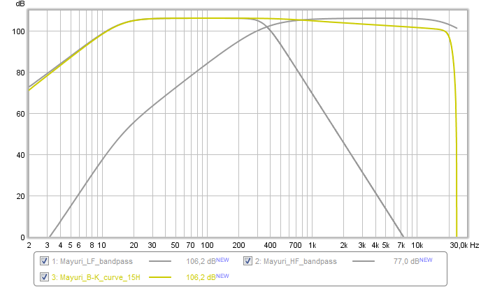

3. Summing the two pass-band should now arrive at a flat but bright system sound, now its time to add preferred tonal curve and find to use as starting target attached IR-wav file approximate B&K curve with system slopes at 15Hz BW2 - 20kHz BW2 under 48kHz sample rate.
After point 2 its important to know that ever never adjust any correction to only one of the band-passes because that will ruin and change correct delay offset, so from now on any IRR or FIR correction should be done on a point in DSP engine that correct hole system or if DSP run out of these numbers for correction then if a correction in woofer area is corrected for that band-pass remember to do same correction for mid-tweeter even if its outside XO stop band.
attachment.php
Is there some logic in above to arrive audio nirvana at listening chair in new dedicated room with new nice speaker build 🙂
