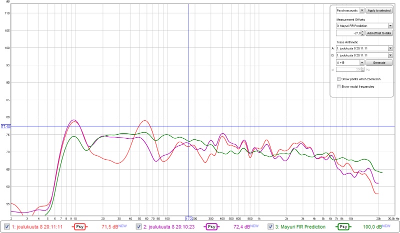

Here's the reason my FIR recipe doesn't fix the diffraction trouble. This is what REW's Psychoacoustic filter looks like on the FIR prediction :
attachment.php

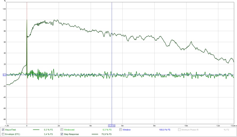

IR and STEP:
attachment.php
Final room curve would be up for debate 😉.

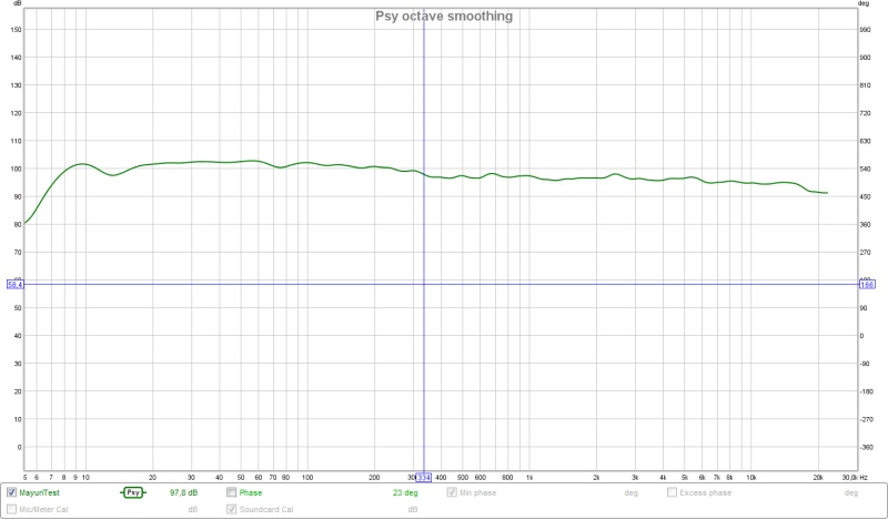

One more to add, all 3 graphs in the same Psychoacoustic smoothing:
attachment.php
Now if there's room for the actual EQ edits remains to be seen. This FIR recipe is made for line arrays that can take up to 240 Watt before running out of steam. We'd have to check real boost values etc. Plus invest more time in measurements to see what happens off axis with correction like this in place.

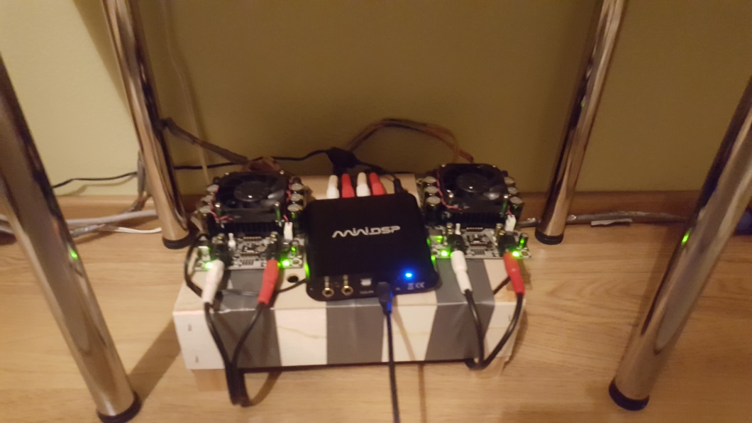

My Sure amp modules finally came from China, so I upgraded my amplifier with SMPS 24V 10A brick and two Sure AA-AB32971 amplifiers. Noticed a drop in background noise, so they might actually be worth their price.
Anyhow, I'm not sure how to implement filters from REW to actually filter the signal. Tried the waterfall thing with the filter wesayso produced, but didn't really understand what I was seeing. Figured since I have a new amplifier, it might have some different in measurements, so I re-ran everything and then a bit more. Now there are multiple measurements from the listening spot with all kinds of combos and a bit of off-axis measurements from near- & farfield. The neighbors kids are being quite lively today, so there might be some artefacts from that in the measurements.
BYRTTs idea of finishing of perfecting the crossover, then having a go at further corrections first seems logical. How would I go about it?

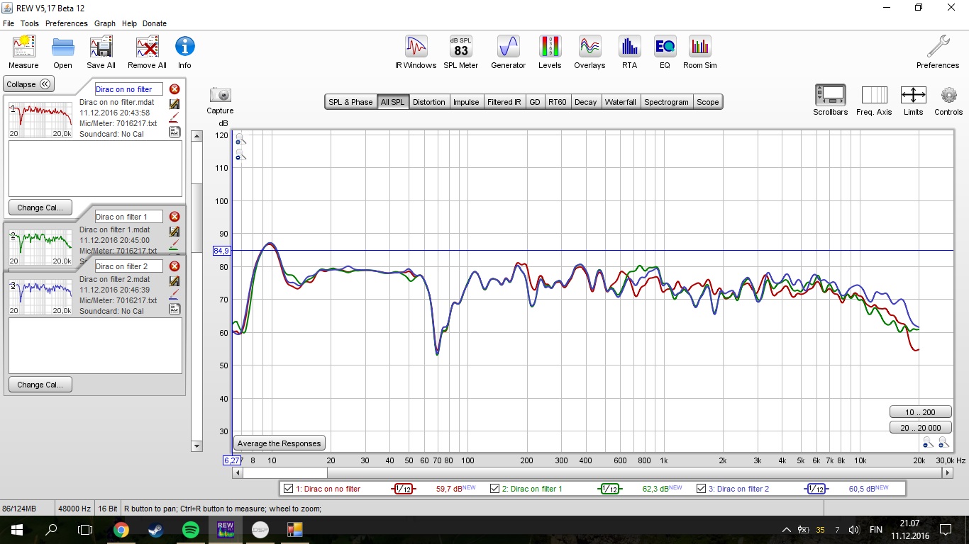

attachment.php
Here are the measurements (Dirac on with everything, tell me if you want if off). They are no filter, filter 1 and filter 2. It kinda shows that they were made for the previous set of measurements. Don't mind the top end, just experimenting with target curves.
EDIT: I wonder if it would help the HUGE null at 70Hz is I re-organized my room and flipped the place of speakers and listening chair. It's making the music sound a very anemic. Need to solve it somehow (maybe just pull my listening chair forward), and in this task DSP just isn't going to cut it.

Yes, those were for the previous measurements. The new red curve is better behaved on first sight.
Is that dip there in both channels? Left and right? I have a similar (though higher Q) dip in my left channel from my corner placement. I don't use boost there but instead bring it down some more. Then after boosting a little in the other channel I compensate.
They add to flat with both speakers playing. It's the best I could do.
The left channel is better at playing real low, so there the right one is a few dB's behind. The higher harmonics still make the positioning of percussion seem right in imaging.
You probably don't have that luxury, as the left and right speaker output was pretty symmetrical in the first measurements you showed.

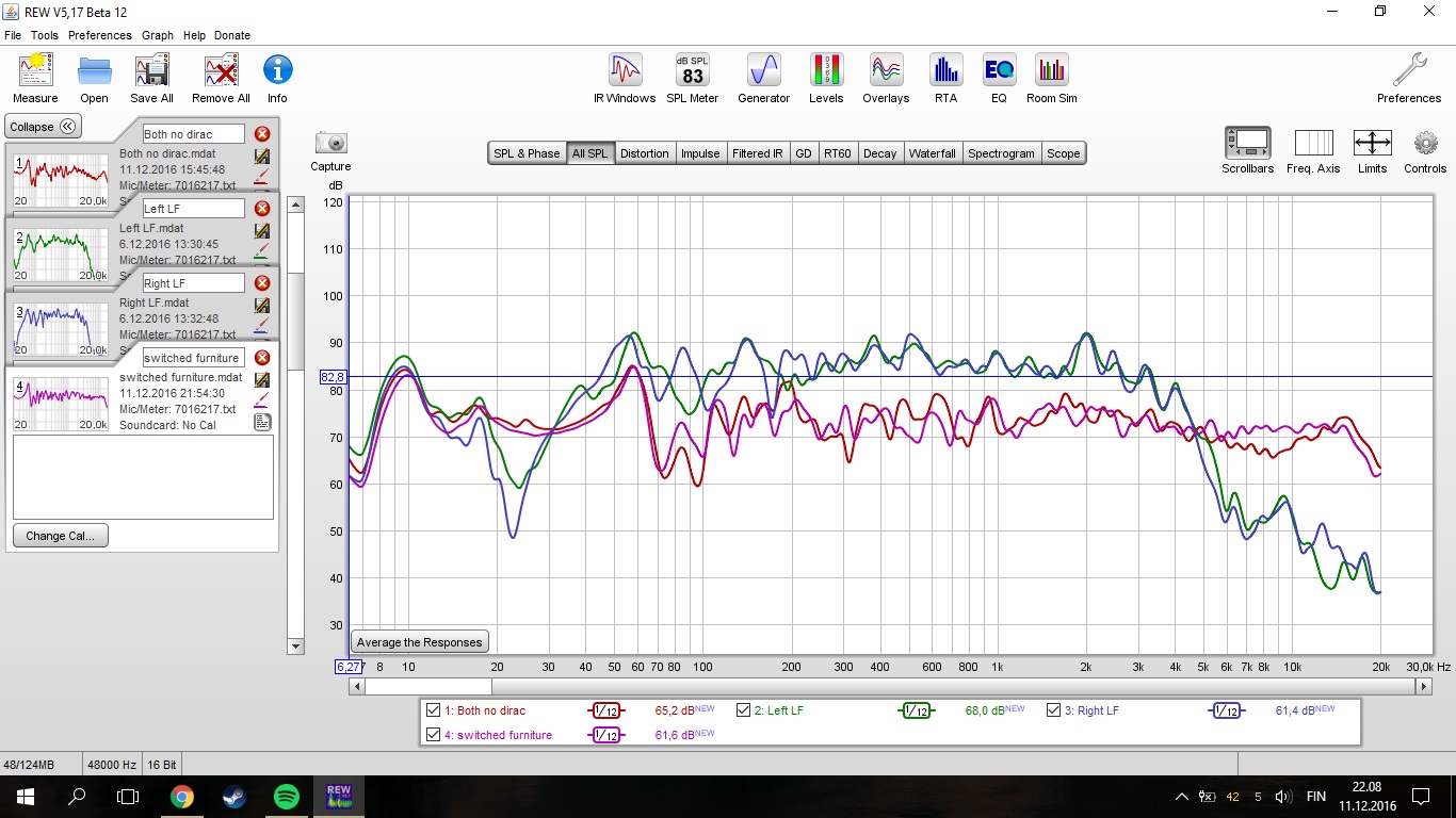

Looks like switching furniture around didn't really help much. That 70Hz dip is inherent to this room. Shame, can't do much to help it. Will probably swap order back tomorrow unless there's some massive improvement that I missed, room feels much less spacey with the listening chair next to the door. Attentuating the output to be level with the 70Hz dip might work, I still should have plenty of headroom on my amps.
In the picture you can see the furniture swap test (bass trap, bookself, chair, loudspeakers) along with 3 measurements from old listening place. Here's the measurement file:

What happens if you remove just the bass trap and remeasure? Maybe it's sucking enough bass energy out to affect that 70Hz dip.
Do I get this right;
Left low end: not a trace of that dip
Right low end: not a trace of that dip
Both speakers running: dip is there? At least, the separate measurements don't show such a deep dip. If that would be the case, the timing between left and right would be to blame.
If I'm off base, you got to tell me what that left LF and right LF is.

Wavelength at 70Hz is 490cm so it could well be boundary interference (SBIR) causing the null. If your speakers are placed symmetrically in the room this could be making the boundary interference worse when both are playing together. Try to offset the gap between the speakers or move them further into the room to measure and see if there is any difference.
I'd play a tone at about 70Hz, doesn't have to be loud. Now, walk around your room from corner to corner. Do you hear the loudness changing as you walk, or does it stay the same?
Place the speakers 2m off the back wall. Walk again. Place them at 1.5m, then 1m then 500cm...... Feel how they interact with the room. Experiment. Get to know how the room behaves with your speakers. That will take some of the guessing away and start to narrow down the problem(s).
