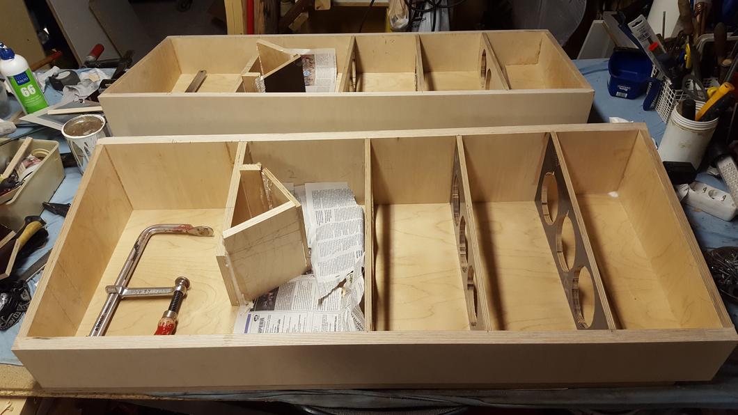

Gluing the boards for the first speaker. It's just the sides getting glued together for now. After that, I'll glue the front baffle to them. The back side will be attached with screws, I want to have the possibility to open them later for service.

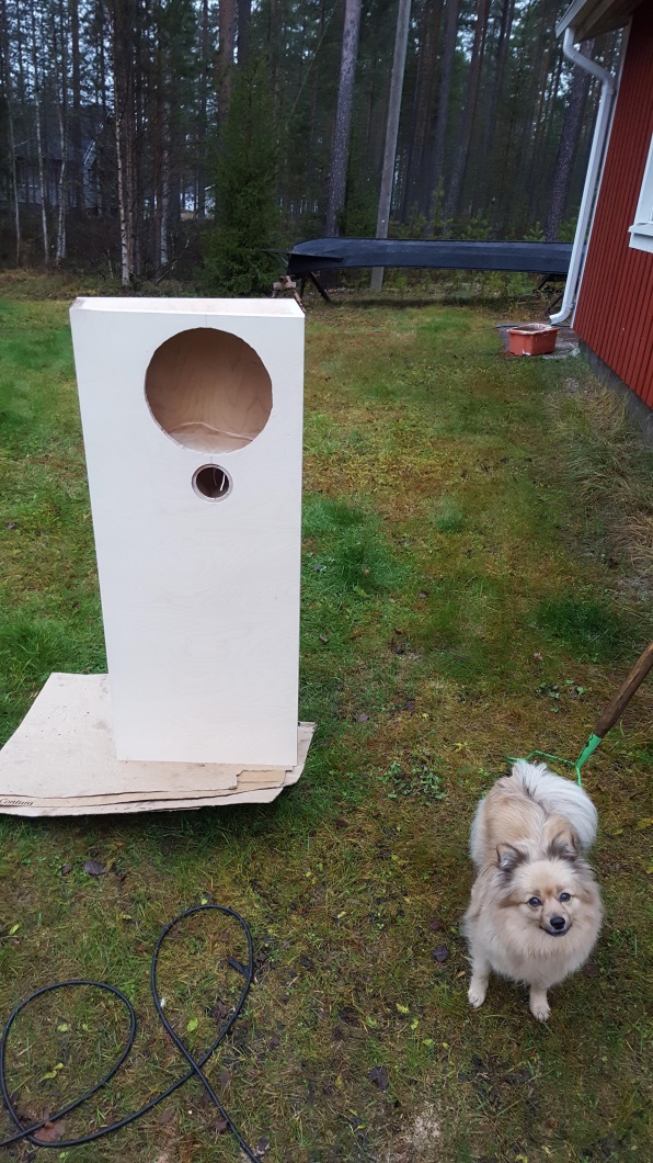

Front baffles are ready! Or at least the holes are, still got much work to do 🙂
Last pictures for today. I screwed the back board on instead of gluing it. The glue part will come later, after the front baffle has been attached. This is simply due to not having mounting terminals with me. Should have thought of this before I came here, but nothing I can do about it anymore. Need to do it later.

Man, please resize your pictures. Those monster sizes make it almost impossible to read the thread.
Those holes looks very ragged. It won't show when you put the drivers in, of course, but the way you use your jig creates all those mini edges... unless that was the plan?
The subwoofer hole is quite jagged. It was done by free hand, without the jig. On the full range hole, it was to flush mount the driver, so the edge of the driver matches the front baffle 🙂 Unless you meant something else?
Following your build - but as perceval has already said, please resize your pics or ask the mods to help out.
Ah, I was wondering about that. My browser automatically resized the images so I assumed it looked normal. Checked with another browser and it looks horrible. I'll resize them right away.
Better yet don't post pictures at all -- post attachments.
I'll do this in the future. It's more work for me, but at least the images stay in here if someone wants to look them up later.

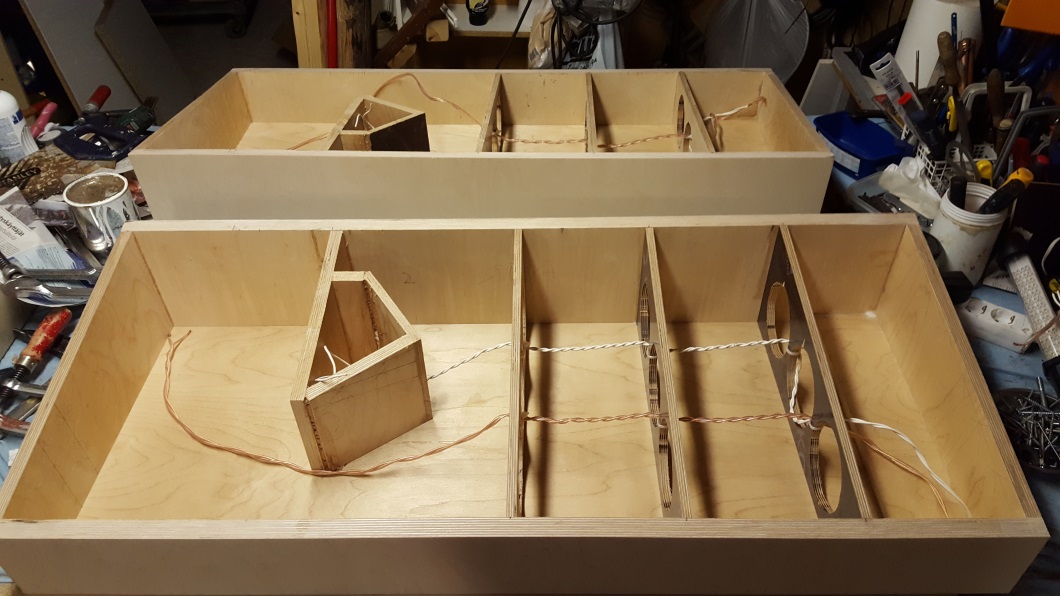

First off the full range enclosure needed some extreme makeover to fit inside the subwoofer enclosure. The extra bits came off easily with a hand saw. Then it was time to put the internal wiring inside. I use only premium quality true audiophile cable (it has copper in it and a rubber protective sleeve). However, thing I usually do with the speaker cables is that I check it has a low DC resistance (discontinuances are bad) and twist them. On the off chance I ever listen to these inside an MRI machine, the electric field won't mess with the signal that much. Plus, I know some studio monitors get build this way, so it probably has some science behind it. The connector isn't in place yet (still don't have them), but I'll use Speakons.

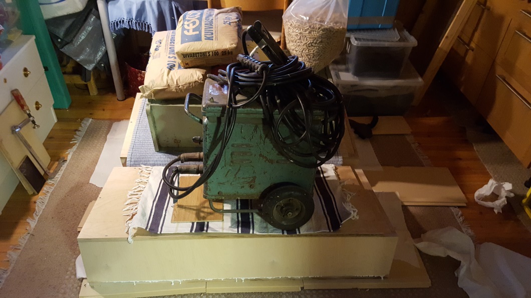

Skip to the last thing I did today, which is gluing the front baffles. The fit was not perfect, so I mixed fine sawdust with PVA glue to create a non-runny hole filler susbtance that I applied generously to all inside edges in contact. Due to the shape of the enclosure, it was impossible to use clamps to pressure the baffles very tightly together. Had to go for the next best thing. I did it the ultra-fine way of first walking and bouncing on top of the enclosures with my old man to squeeze the extra glue out, then piling as much junk on the enclosures as necessary to keep the seams closed nicely. The other enclosure has bags of concrete on it, the other an extremely heavy old-time arc welder. My method doesn't seem much, but hey, if it's stupid and it works, it ain't stupid 😛

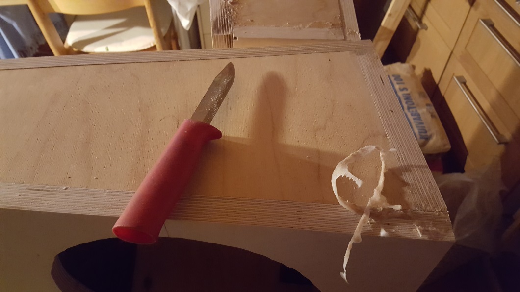

Gluing the front baffles was a success. Few places had some unevenness and shortages, but I knew that was going to happen anyway. I already planned on routing a small cut around the front baffle seam which I'll fill with black elastic glue. It will give a nice finished look with a smooth black line going around the baffle. Here's my dried glue removal tool, very simple and efficient.

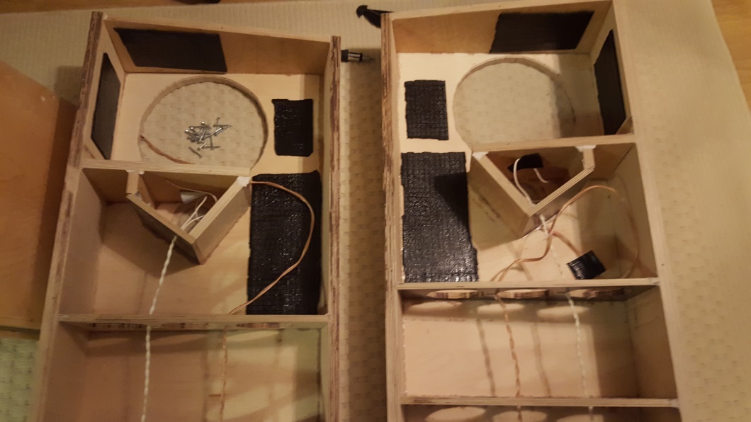

A small update. I did some very simple knuckle testing of the enclosure, and it seems the open area around the bass driver could use some more internal bracing. I added a couple bitumen 4mm mats to dampen it a bit, but they alone don't do much. Internal bracing is where it's at 🙂

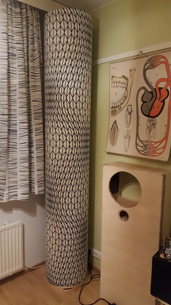

Update again. I haven't been working on the speakers much, only did the baffle edge rounding for them along with light sanding. Not much to show. On the other hand, I finished my bass trap!
attachment.php

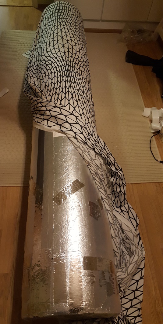

Here's the bass trap in the making. The aluminum tape is to mask texts etc in the wrap, because they show through the fabric. Low frequencies will pass them like nothing anyway, so it's purely aesthetics. The fabric is from IKEA. I went to the easiest way of attachment, just tape it on the tube.
attachment.php
Here is the bass trap on it's place in the corner, finished. The tray under it is also from IKEA. It's handy for dragging it out of the corner for cleaning, but serves virtually no other purpose. It turned out to be better than I originally thought. WAF should be alright too since wife actually chose the fabric and helped me wrap it.

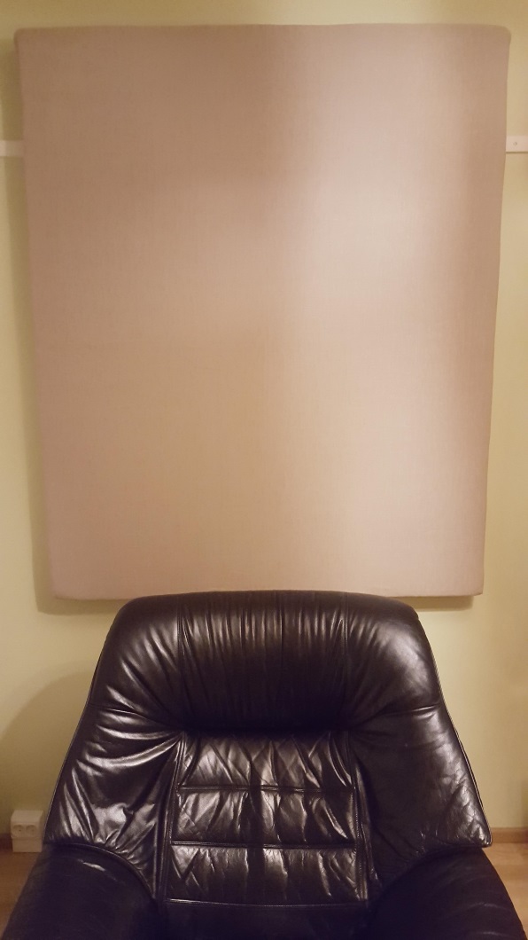

Here is my listening chair with the finished acoustic panel behind it. The panel itself has 1500x1200x100mm dimensions. The cover is light beige flax linen. Looks very nice and calm in the room. With a simple on-off listening test it seems to bite reasonably deep into the midrange. Measurements will come later.

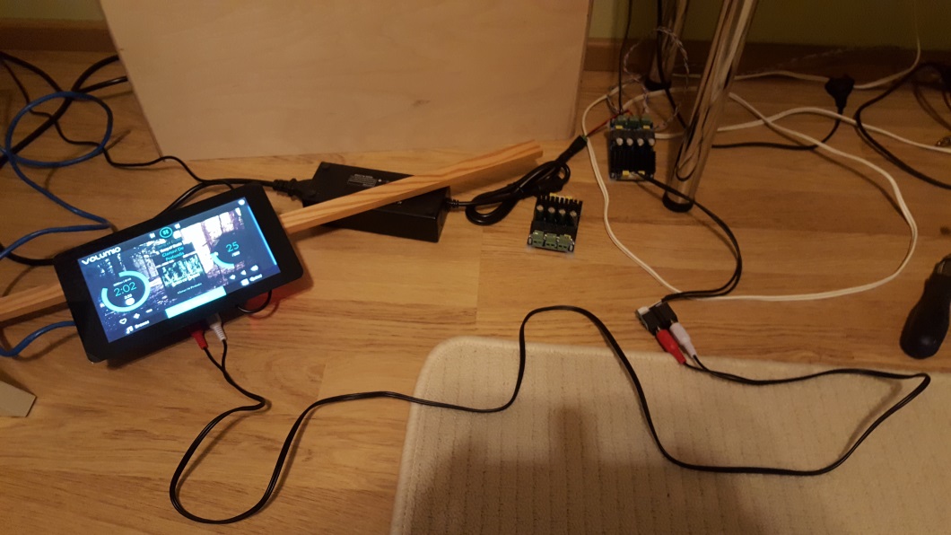

My audio source, which is a Raspberry Pi 3 with a Hifiberry DAC+ Pro along with the Raspberry Pi Touch Display. It is running Volumio as the OS. Very handy, and works nicely. The DAC sound quality is excellent. Still need to figure out how to run FIR filtering with it. The amplifier is Sanwu TDA7498, the model without the RCA inputs and volume pot. I won't be needing either of them. I checked under the heatsink, and both amps seem to be running the real 7498 chip, not 7492 like someone mentioned. My PSU for the amplifier is only 24V, so I'm not using it's full potential.
