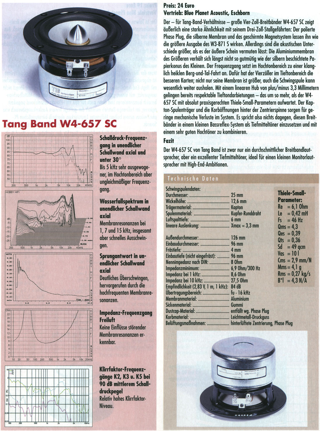

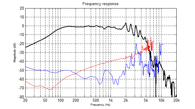

I have experience with this driver, and I'm currently making a BR box with them for a friend. It has excellent bass for a wideband driver, but problems in high register. It has horrible peak due to cone breakup at 6-8kHz, so it would need a crossover to a tweeter, effectively making it a multi-way design. What immidiately popped into mind would be a Harsch XO with -48db/oct crossover for the woofers, cutting the cone breakup out of the game. Tweeter would likely be happy with -12db/oct when correctly time aligned. Review of the driver from a german magazine attached. My german is too rusty to make anything out of it aside from the graphs, but they seem be happy with it's capabilities as a mid-driver.

That is most likely the case still. Oh well, I trashed a few old drivers, so might as well stock up on new ones 😉 If nothing else, I'll make Karlsonator HT systems out of the W4-657SCs for family.

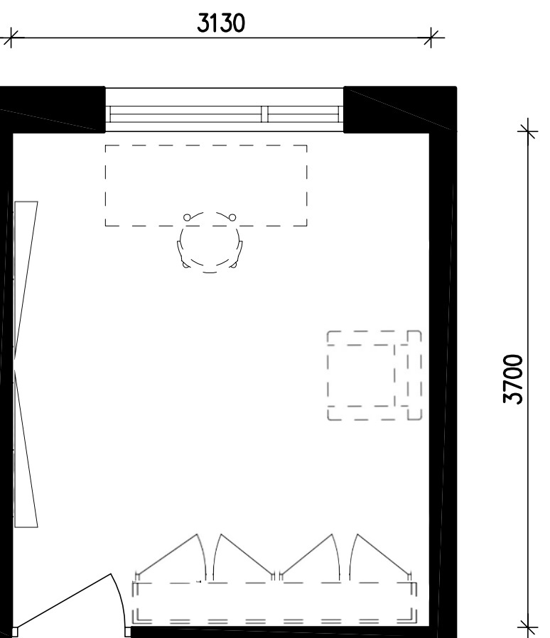

Room and audio source:
1) Room is 3150x3640cm when including cabinets, which will have doors on them. It might be actually beneficial to have the listening position on the side wall instead of before the doors, as it will de-clutter the room greatly. I adjusted the speaker shape to this.

2) The source will still be Raspberry Pi 3 with Hifiberry DAC+ Pro. It can only give out 2 channels of information, so all the crossover functions will happen on analog level before the amplifier. I can't get a steep enough crossover on passive line-level, so I need to do active line-level. For this I will use Sallen-Key topology (unity gain) high quality opamps. I have stocked up on these: NE5532, LM4562, LME49860MA, OPA4134UA, OPA2113PA. I will decide which one is the most suitable by listening tests. The exact value of crossover will be tuned with miniDSP 2x4HD, then build as analog circuit. Currently thinking it depends on how much I can help the phase problems with computer.
3) Whilst the Raspberry Pi 3 and Hifiberry DAC+ Pro are only capable of stereo output, they are very capable of high-quality FIR filters. I haven't had time to read up on these first, I've currently just concentrated on the speaker side. How much can I do with the FIR filtering? Can I for example help with the phase rotation that is inherent to 4th order RL filters?
4) Acoustic treatment is a must. I will build a DIY acoustic panel behind the listening chair. We are also have going to have a nice big fat carper on the floor where me and my wife can sit and play board games with our friends while listening to music.
