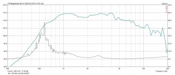

Please find here some measurements of the Faital HF1440 in Yuichi Arai A290 horn: https://www.diyaudio.com/forums/multi-way/357825-shadow-colossus-build-thread-13.html#post6348851

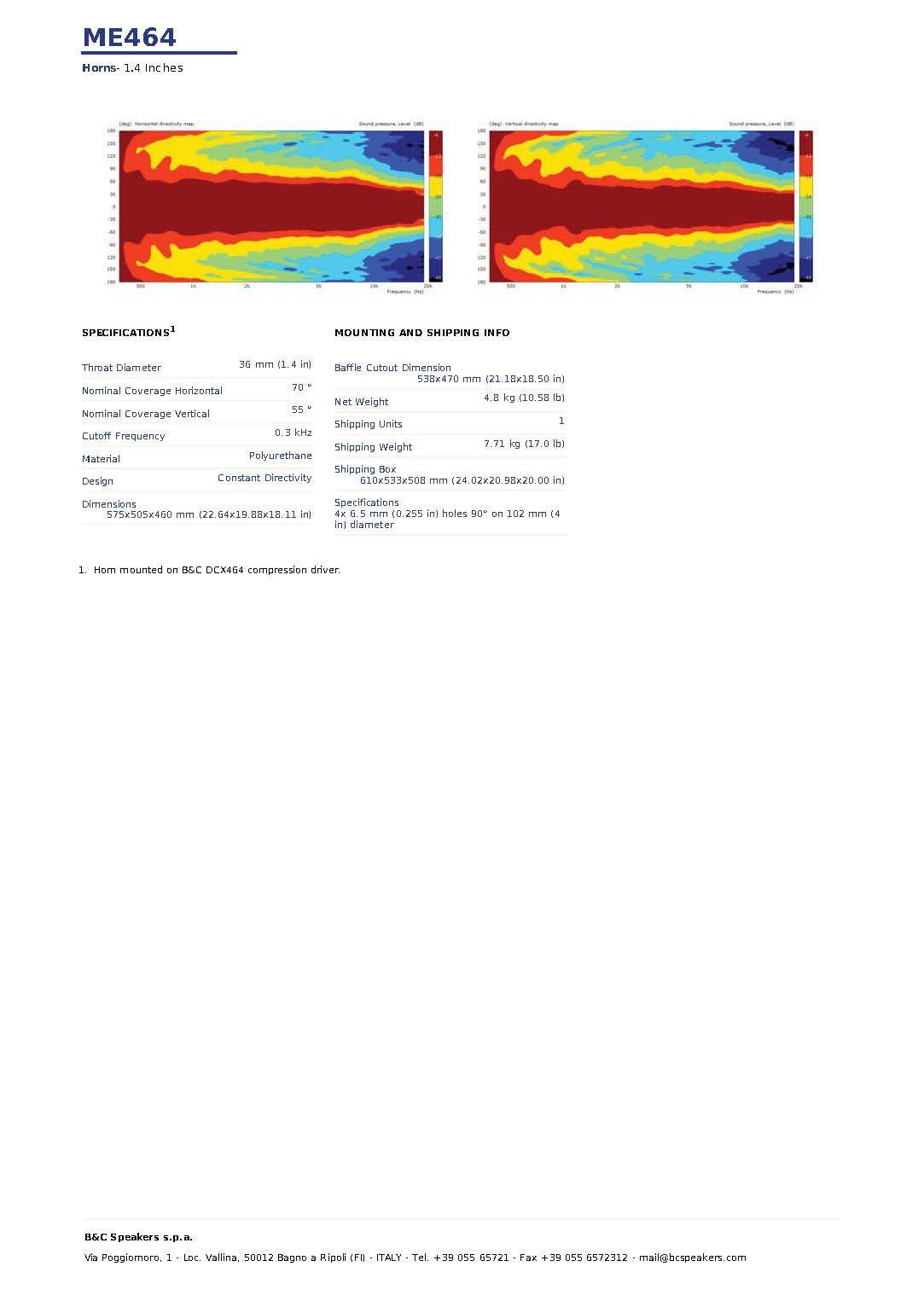

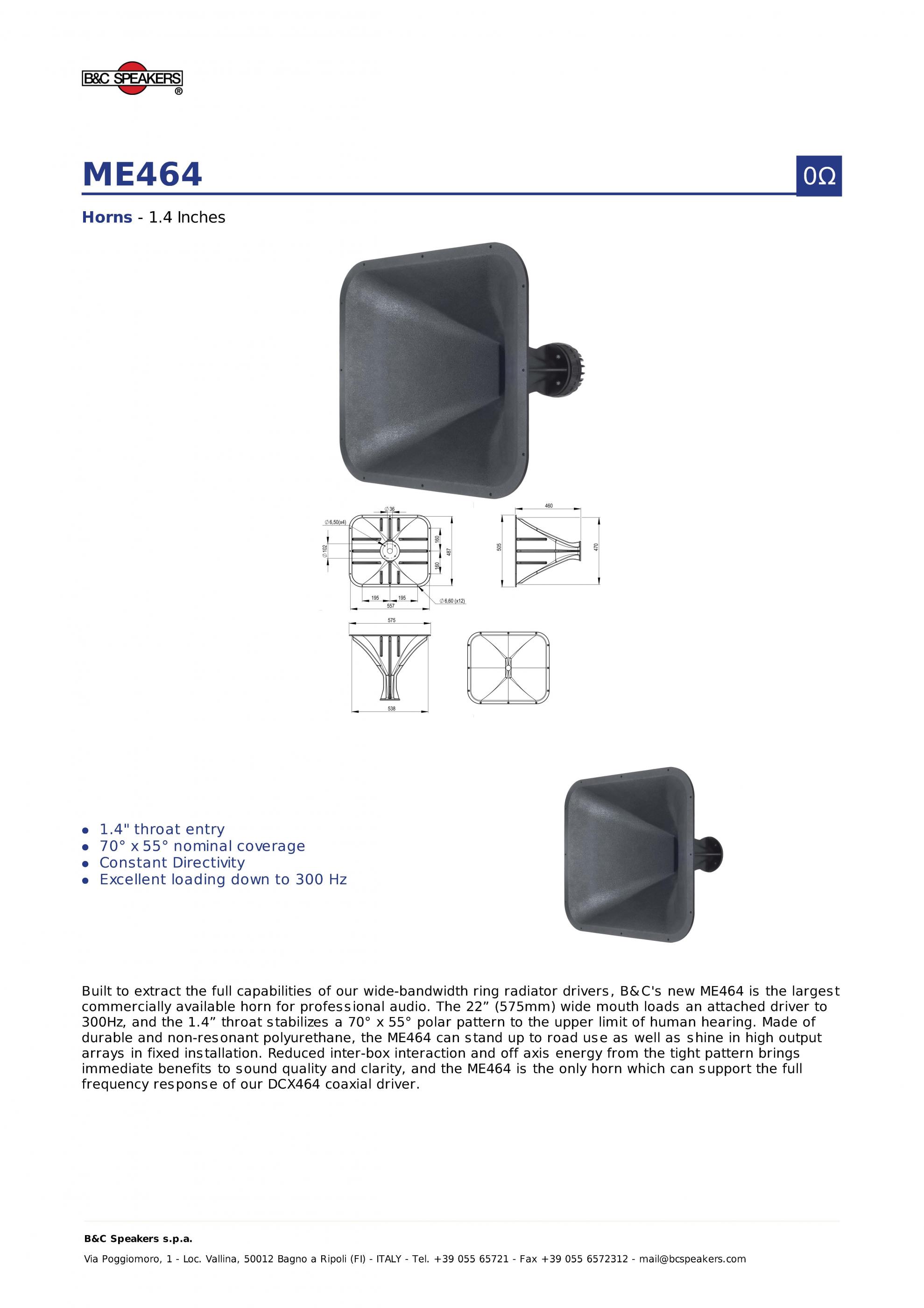

The HF1440 will likely work well in that horn down to 700-800Hz. Measure it and find out.
Correct.
Funny that Parts express is calling the HF1440 a 1 1/4" when the exit is 1.4". I briefly though they had come with another standard for throat diameter.
it would have to be a whole new design with a much bigger horn, and no mids
If it has to be a ready-made horn that provides maximum loading, this is could be an option.
