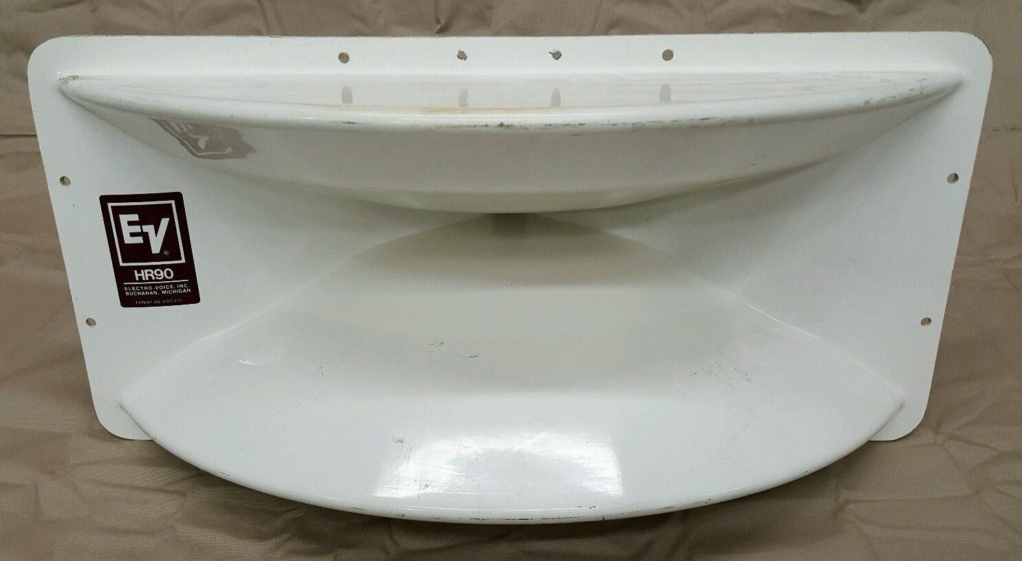

These horns are expensive to manufacture and have become obsolete due to their size and the advent of smaller PA systems, primarily line arrays.
Danley incorporated Keele's secondary mouth flare in his Synergy horns.
If you compare Keele's horns for EV & JBL, you'll find these are all variations on the same diffraction theme that he first introduced with HR series 1.
The slot in the JBL horns is positioned vertically in order to circumvent patent infringement.
While the Bi-Radial mouth section of the JBL can be considered an improvement, the HR series A is better, because the throat generates a much lower amount of diffraction and HOMs.
The HR series (including the smaller HR60 and 90) don't differ much from Arai, TAD and similar radial horns.

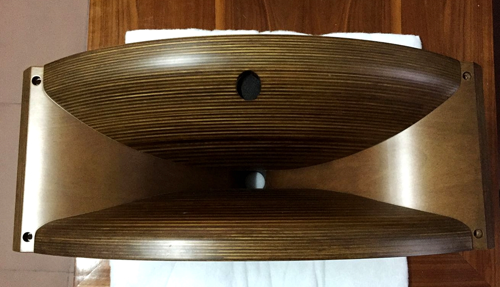

It would be of high interest to see measurements with the Yuichi horn especially the impedance.
Sure, I will keep you posted.

Once mounted to the Arai horn, the on-axis response should be pretty flat.
This driver definitely doesn't need a tweeter.
