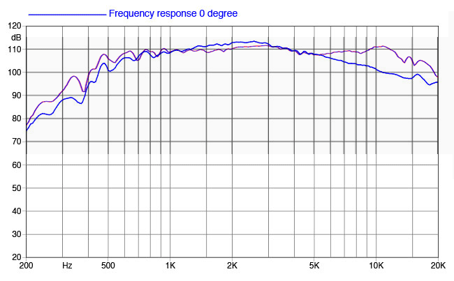

No EQ, just raw drivers. I found them used with horns from Denmark and a pair of 15pr400 used from Sweden. Good that the graphs look easy to work with - I'm trying to "design" my first pair of speakers and have never done a crossover=)
The graphs look rather similar to me, so I will go with the xt1464 since discussion here gives the impression that it is slightly preferred to lth142, does this seem resonable?

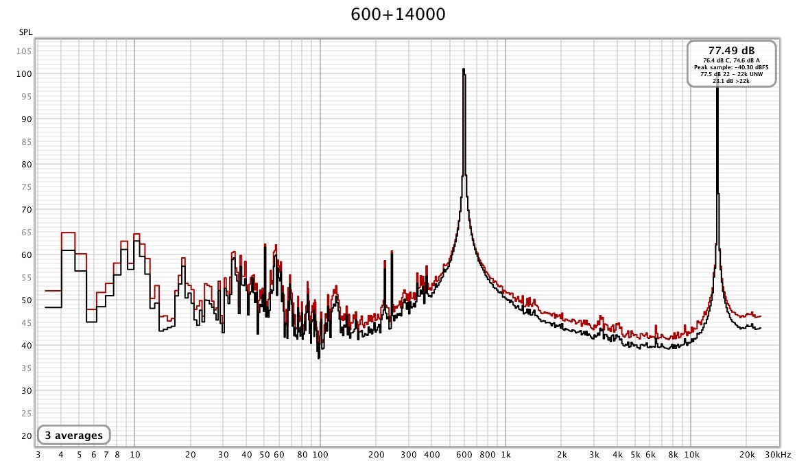

I see it too. ATH4 optimised horn. 1M.
Interestingly enough there is a peak in the impedance plot at this frequency in the Faital Pro data, but no response irregularity.

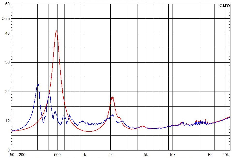

One thing to note from my side. The wg does not provide any load or damping to the driver? A good horn also damps significantly all peaks visible in the free air impedance shot of the driver. A good example is the 18s ND4015N attached to Selenium HL4750SLF horn which provides excellent loading / damping. Red is free air.

The dip seem to occur exactly where the driver's impedance side peak is. If we assume simply that P = U**2 / R then the voltage source amp might provide much less output power P into the bigger load R resistance.
What I would try now is a setup with amp out following first a 10 ohms parallel resistor and after this an 100 ohms resistor in series with the driver.
The difference would then be about 108 (normal) to 140 (peak) and without this setup 8 to 40.

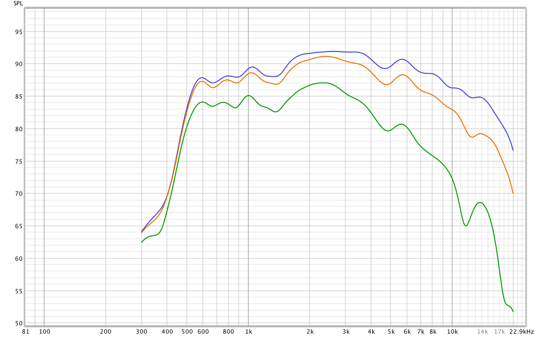

Tried this driver on a Joseph Crowe ES-600 horn. The frequency response is smoother than using RC HF950 horn, but the ES-600 horn seems to be losing vertical directivity at about 1500Hz and in-room measurements tell very little. I had to use strong smoothing and short window to get something meaningful.
-lots of pillows piled on the floor around (and under in this case) the device under test and in-between and around the mic. If it’s just the horn/CD you can also lower it nearer to the pillow stack to delay the ceiling reflection. You can also move closer to the source but in this case I would not recommend closer than 18”s.

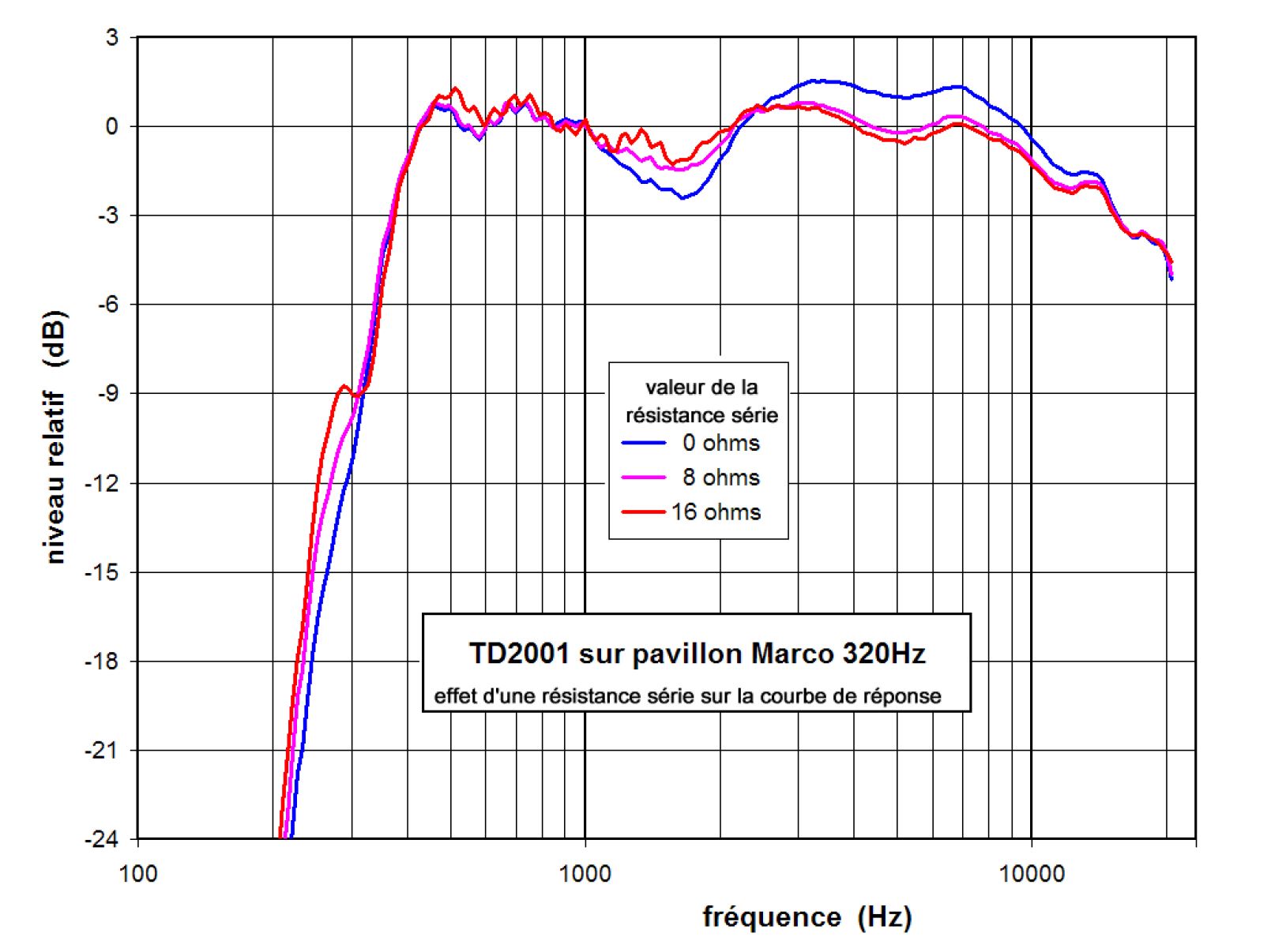

What equipment JMLC used to measure or the setup is not so important. His "paper" was done to show the effect of resistive padding/ "high" output impedance amps on a compression driver.

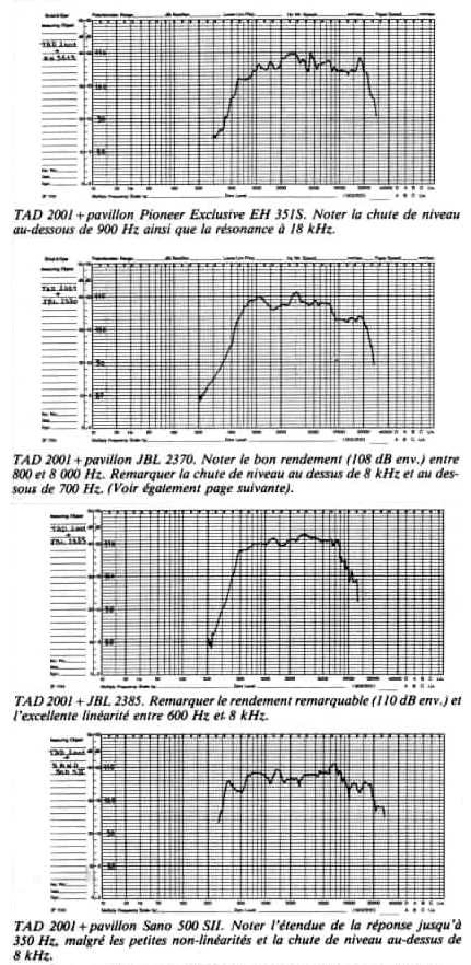

It has been documented numerous times, that the TD-2001 has this issue.
Look at the added pic of some old TD-2001 measurements, they all show it to some degree..

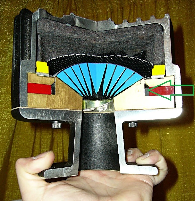

It is a cavity resonance, due to the cavity in the gap, below the drivers voice coil due to too large clearances.
Look at the attached picture below of a split up 4002, and the added arrow, you can see the "black rubber ring" added below the gap to avoid a cavity resonance during the design phase.
Don't take my word for it. If your a AES member or find it elsewhere, this document below gives some insight into the problem in general, and for the TD-2001. Written by Kinoshita and Locanthi in 1978 the year they released the TD 4001 and 2001. Noone would know better in the case of the TD-2001.
