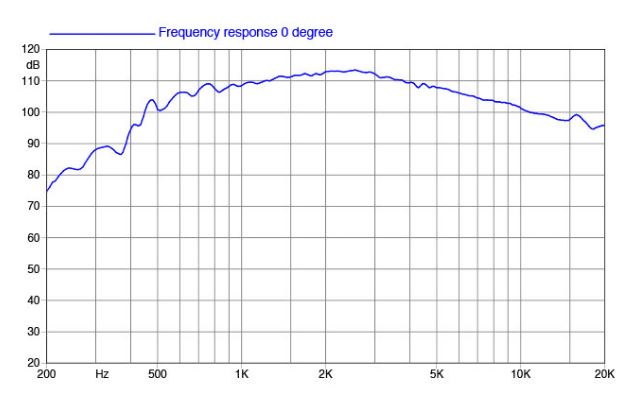

What do you mean Mark100 ? What is the goal at showing an equalized cd driver whatever the horn, please ?
Why especialy 500 hz to 10 k hz ? Is it about the impedance curve shape after EQ ? Something else ?
For me, I'm always looking for a driver to cover a particular bandwidth with flat mag and phase, after EQ.
So i look to the low and high ends of the response and see what output is available.
The ends are always lower in output than in the middle of the response, but they set the net usable sensitivity because the excess output needs to be equalized down to the level at the ends.
Some folks may interject here and say the ends can be equalized up.
Which is true, but it does come at the expense of total available output.
So EQing the ends up can often work for home at lower levels.
Just doesn't work for me cause I'm a clean headroom junkie....it's one of the few things i can hear beyond mag and phase that really seems to matter.
Looking at the response of the HF1440, it's about 100dB at 500Hz and say 10-13kHz. I figure the hump in response, up to maybe 112dB @ 2.5k is pretty much unusable and needs to be EQ'ed out. (The rolloff above 13k doesn't bother me...old ears 🙂
So i'd reckon the guy to have a usable sensitivity of about 100dB.
That's better than it seems i think, especially for a single diaphragm CD.
Usable, level response sensitivity, is always lower than specs.

Edit , that's also what I think about this little bump... staying passive a R//C could certainly flat it... at worst a R//C//L.

Also the impulse response is very clean, does not store energy/ring.
edit. here's the graph. The ultimate shape will change in a horn and won't be as underdamped, but what to look for is the quite small amount of high-freq "zig-zag" after the impulse.
