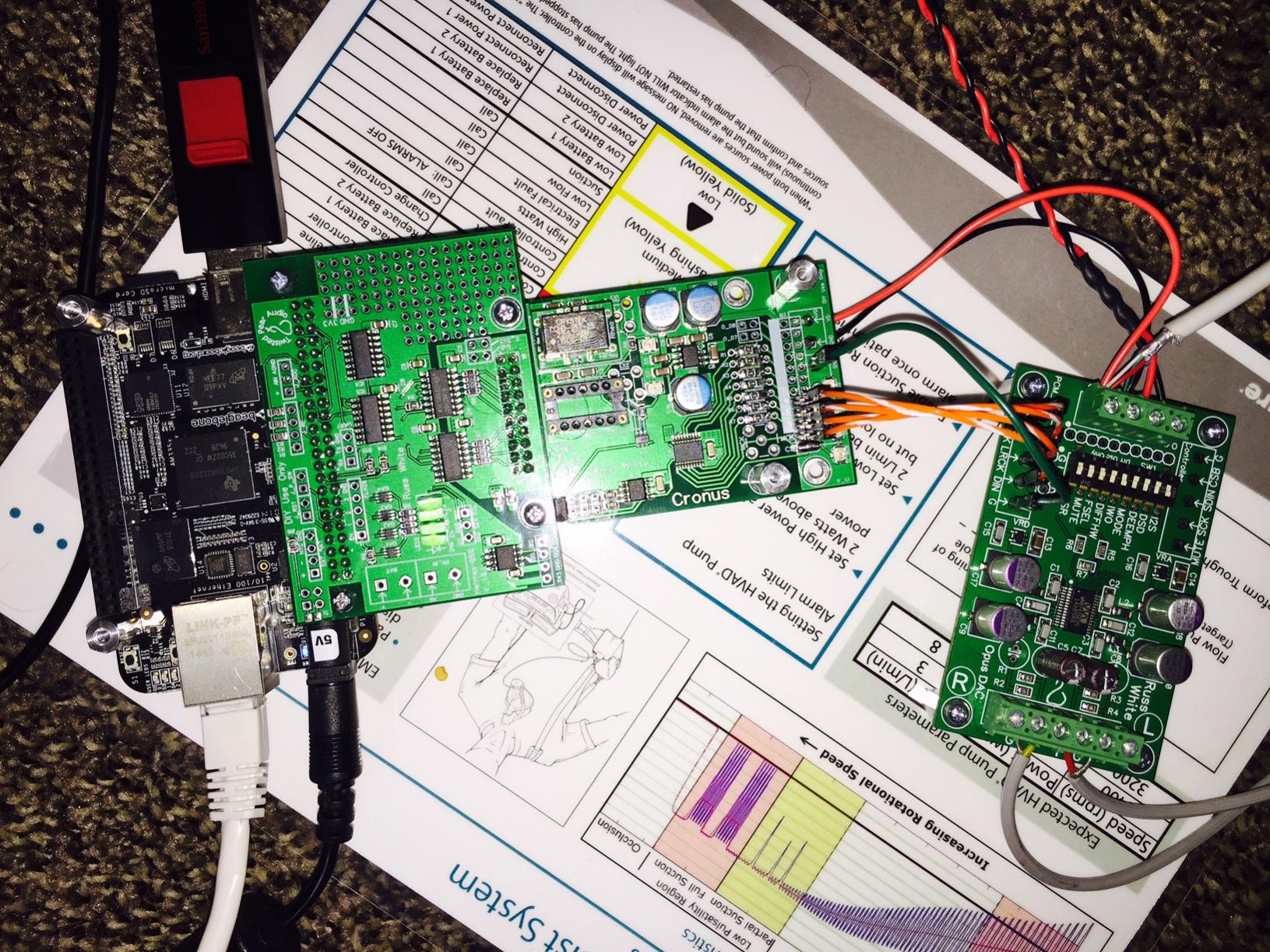

There is a voltage regulated 6.1 V supply to V analog part of Opus and a Salas 5V reg supply powering digital part of Opus . 5V(digital) from opus is also connected with a short wire to Cronus.
Hermes is not connected with any supply and getting powered from BBB, which has a 5V supply through DC socket.Please see pictures.

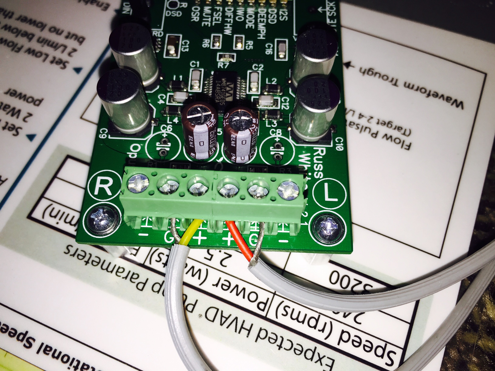

Please see the speaker wiring ,only used two bypass caps to the positive terminal.

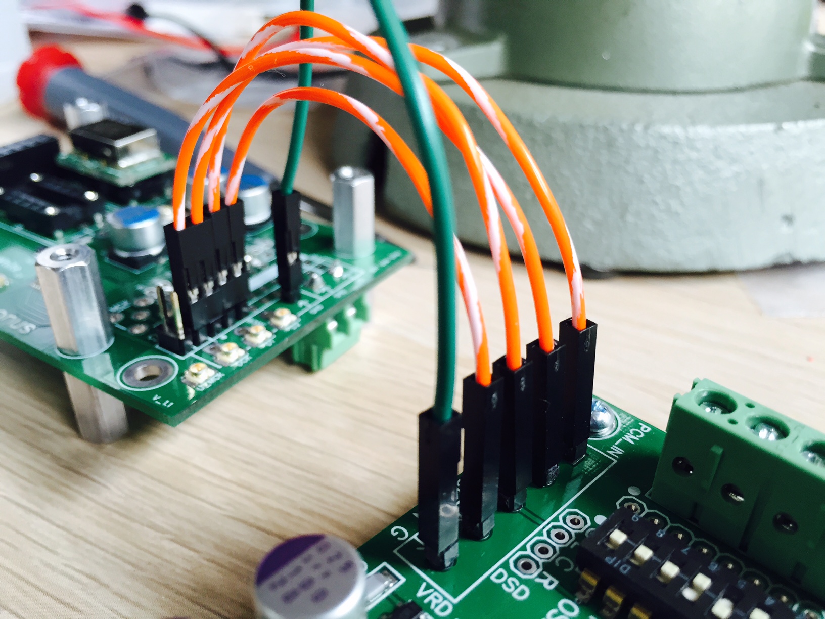

Kinku, I need a more closed-up view of wire connection at the Cronus output. Something funny as long as the photo shown here is concerned. Make a photo so as to clearly show the details of header pin alignemnt from L to R, i.e., LRCK to GND.

No need for grounding CS pin. Anyway wiring appears incorrect. You should wire in the same way as in B3SE. Refer to the photo shown here.
Green goes to DCK, Yellow to D1, Orange to D2 and Blue to GND with MCK as Red in front of Green. This connection of mine will help you. Your goal is not so far.

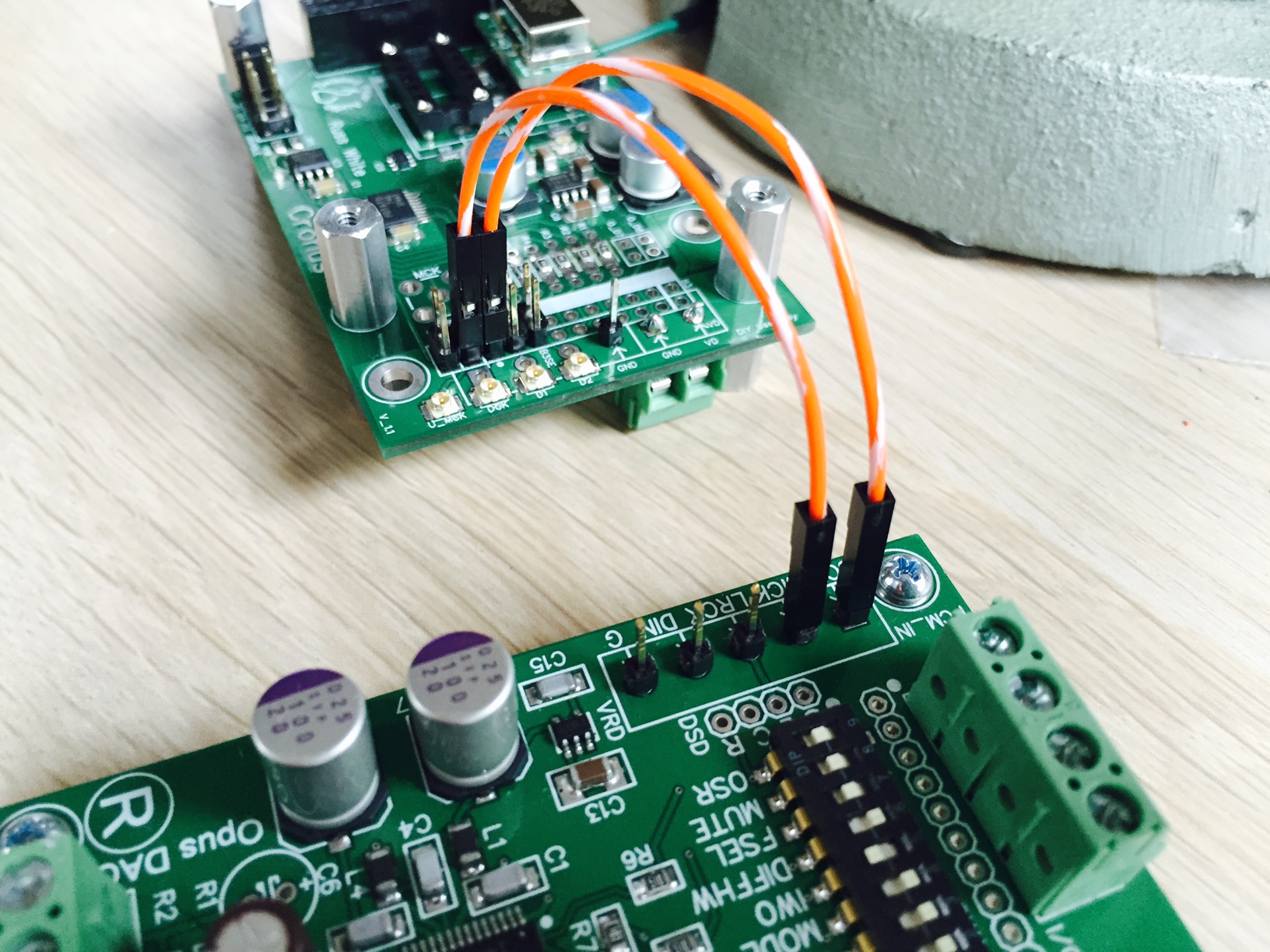

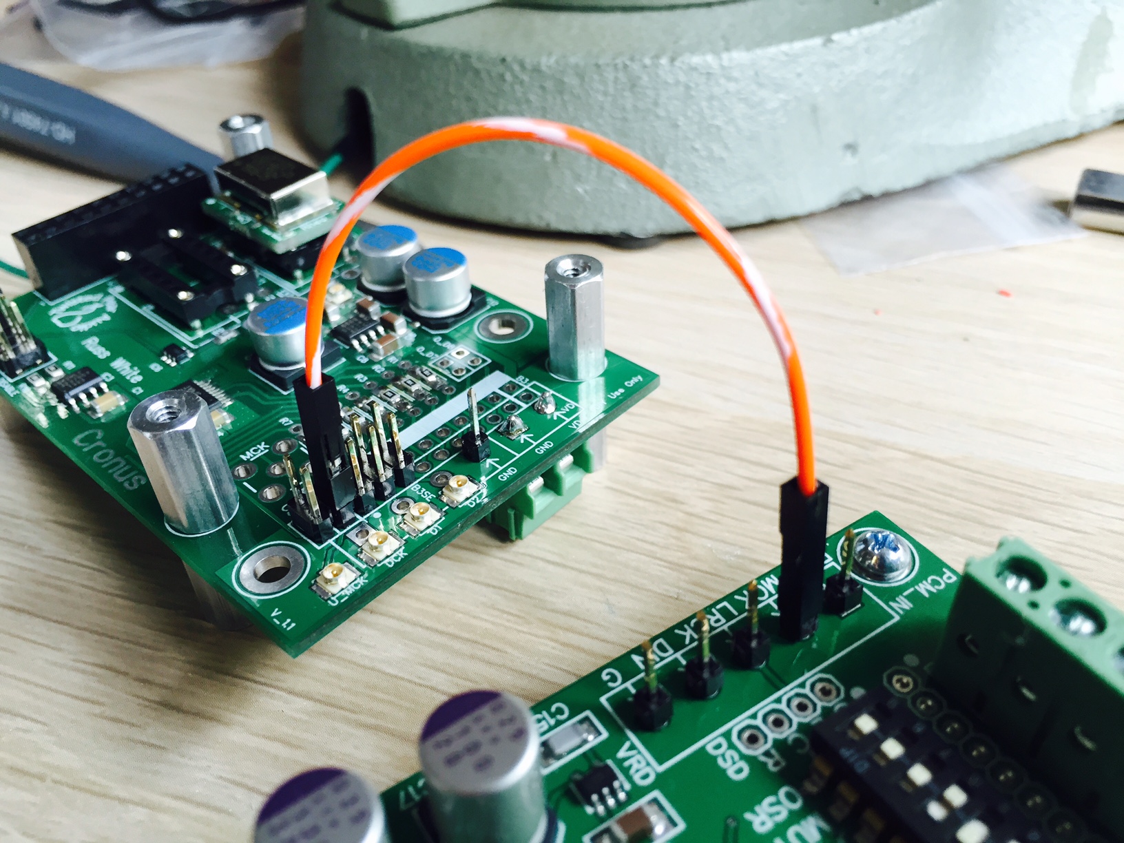

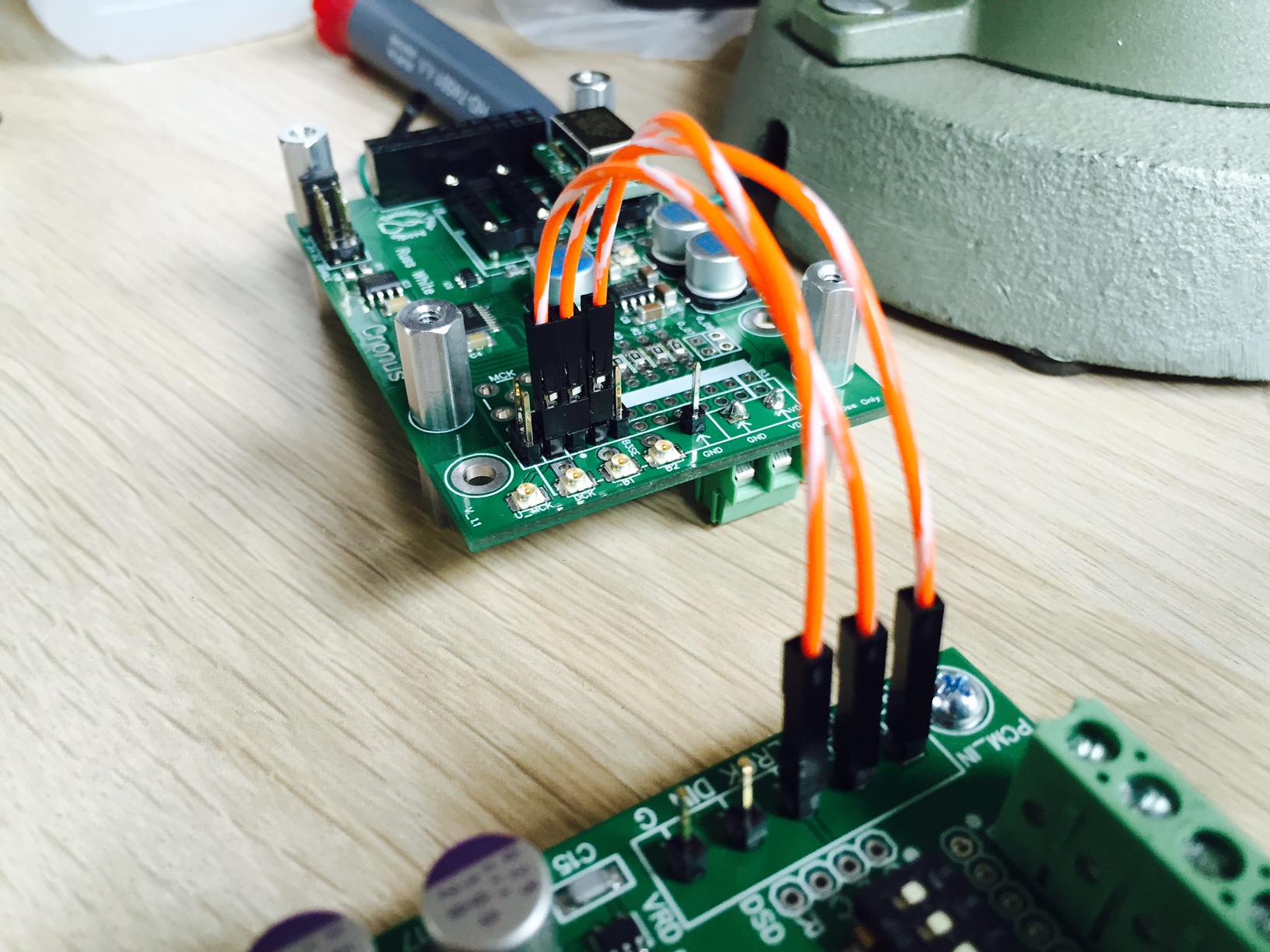

I am going to put some pins in B3SE part and try there.But I thought B3 connector has the same pin outs
I am using same color connector for now so I made 4 shots ,starting with MCK--->MCK
DCK--->BCK
D1--->LRCK
D2 ---> DIN
G--->G
Do you think the B3SE connector is the way to go?

Kinku, you are playing with the wrong holes. Planned wire connection is correct but these are for B3 and you need the holes for B3SE which the Opus shares in the same way. Move all pins to the frontmost header nearly adjacent to u-Fl housing. Look at the signs and letters carefully. My last photo will help you.
I have to correct my statement. If the wiring to DI, D2, DCK and GND is correct, there is no difference between B3 and B3SE headers as miero implied. Sorry for confusion.
But if you tried each of B3 and B3SE wire connections and still get no sound, the culprit of your problem will include more wider possibilities, particularly basic soldering.
