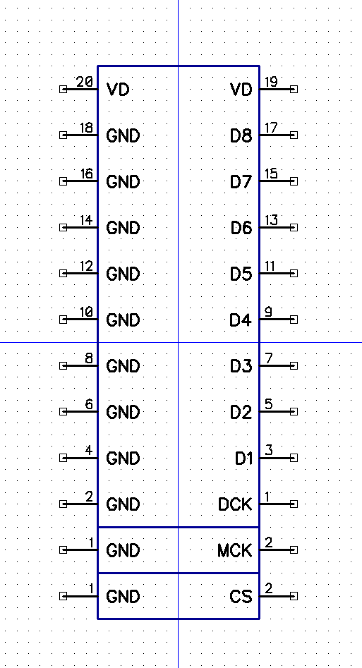

I will also post this on the cronus thread - but here is the pinout of the .1" headers at the output side of the cronus.

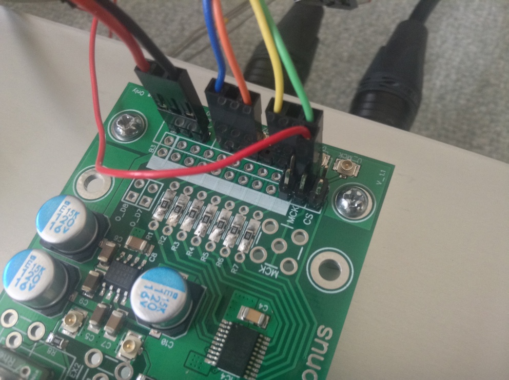

Thank you, Russ. This scheme was of great help to locate the MCK output pin and now my dual mono Opus with volumite installed is working well with another set of BBB/hermes/cronus boards and botic driver, which was of course confirmed to work perfectly with B3SE. The sound is superb!
BTW, I found that H/W and S/W dividers are not working with Opus, as long as my current dac setting, though almost default, is concerned.
With 45/49 clocks set to J1:2, the MCK output on the scope remains the same. This is also the case with S/W divider by miero after editing kernel option.
Just wondering I might have missed something essential because it appears these settings were all bypassed. As of this writing, 22/24 clocks are on the Cronus.
Anyway, thanks for this comprehensive scheme.

WM8741, aka Opus, supports the MCK only up to 33.86/36.86. So 45/49 is beyond the ranges. Plan B option hinted by Russ may work but he did not recommend it (probably due to the disruption of the time alignment integrity intended for Cronus).
