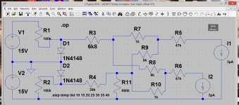

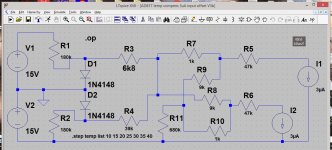

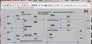

Guess I better go ahead and post these -- maybe some of the much-sharper-than-me folks on here will see the flaw in my thinking.😱 I've been going around in circles for hours now, fixing one shortfall but causing another, can't remember what the original *supposed clever insight* was, and still haven't yet gotten to what was supposed to have been the *real point* of the exercise -- letting the simulator push the pencil!
What seemed like an obvious, simple exercise to simulate the AD817's decreasing input current with increasing temperature -- 3,75uA at 0 C to 2,75uA at 40 C -- and simplifying to linear over that range -- has not revealed itself to me, short of building a model. Of course that would be a worthwhile pursuit. But not something I'm capable of doing on a short timescale. Maybe someone on here knows how to implement a table of temp:current value-pairs for one of LT Spice's built-in current sources, but I haven't found a way to do that, either.
There ARE numerous, popular, nominally uncomplicated solutions to remedy this issue. But they'd require additional op-amps or other active circuitry -- nothing so simple as a diode and a few resistors.
Best practical suggestion would be to use it as is, adjusted for your typical ambient temperatures according to the season. Then be sure to have the headphones unplugged at power-up and power-down.
Or cave, at least temporarily, and fit the output coupling capacitor suggested by other members (which offers the best protection for the headphones, too).
Sorry for the limited joy,

Oh, forgot to mention -- the zip is the complete collection of work-product that LT Spice generates for all 4 of those variations .. in case anybody's interested.

It's the voltage drop across the input resistor. The AD817 is designed for video service -- bandwidth and linearity extending into the low 2-digit MHz. This calls for much lower impedances than audio; 75 and 150 ohms are common. At those impedances the 3uA current that the '817 requires isn't an issue; at the 10k to 50k ohms typical of consumer audio gear, that causes a 30 to 150mV offset.
Of course, we could make the 68k's smaller. But it would have to be objectionably low -- 3 - 5k ohms -- to get the offset down to the 9 to 15mV range. That would load the preamp too heavily.
Sometime in looking over the spec PDF, I noticed the input current's declining slope with rising temperature. (see below -- haven't yet sorted how to get the thumbnail to turn up mid-text 😕)
Then, cobbling up the arithmetic mentally, I thought, 'Maybe we could balance it against that of a diode and approximately cancel it!' I still have no idea what I botched in the reasoning 🙂o), but I'm not ready to throw in the towel just yet.
Glad you're willing to concede and install the caps, though, even if (hopefuly) only temporarily. Much safer for the 'phones.
