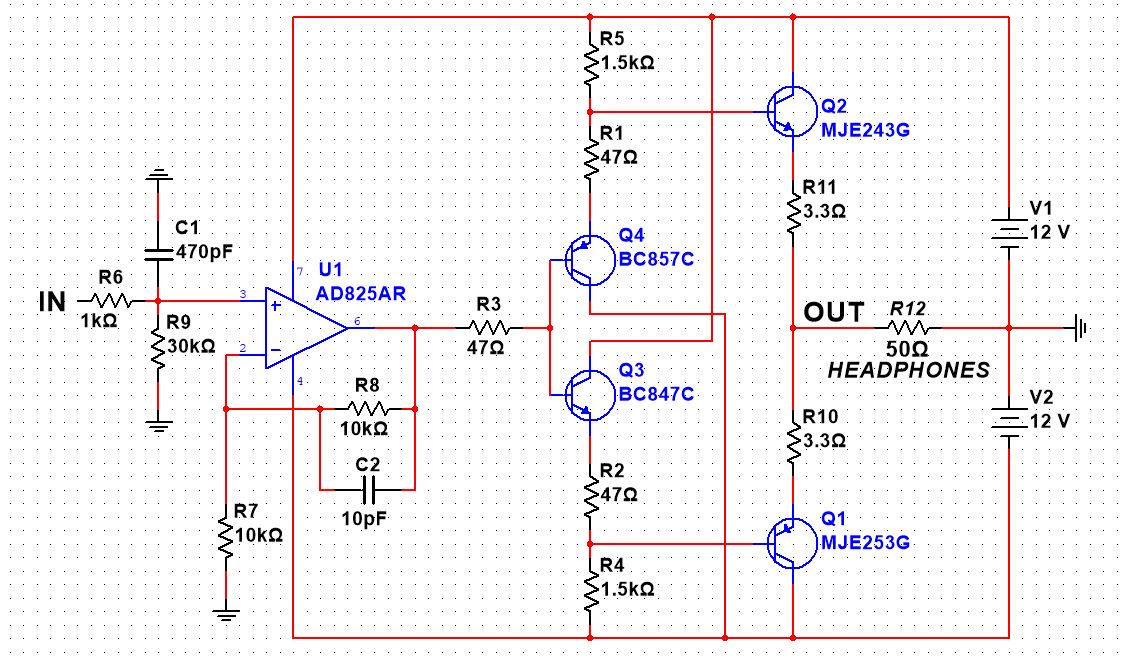

Hey guys,
So the muting relay works great and the amp sounds good.
There's no hum or noise now.
So now to sort out the headphone amp. Perhaps someone has some suggestions. Right now there's a pretty loud hum in the headphones and the amp sounds distorted. Here's the schematic. The hum may be due to layout. The circuit board and input wires for the headphone amp are close to the transformer. I'm going to change the input wire to shielded cable. Hopefully that works.

The circuit board and input wires for the headphone amp are close to the transformer. First correct that. No sensitive circuit should be close to a mains transformer (steel chassis no doubt) unless this is a special type with extreme low stray field.
I already tried to make it clear but it really would do yourself and any one else a service if you would first think, design and then build. It is not advisable to develop the habit to "just do something" and then ask forum members how to solve stuff. This habit is very hard to get rid of and there is some laziness in it which is not a virtue. This is a constructive comment as it would save everyone time. In this case you gave the answer yourself so please solve it.
The circuit itself is a very basic textbook circuit. You omitted input caps and output caps (depending on which opamp is used) and muting. C2 and C5 should be 1000 µF as a minimum and CLC/CRC would be even better. Most things in power supplies are shared no matter if you use tubes or semis. A DC PSU should give a straight line on your oscilloscope so no ripple and as least noise as possible. Volume control is lacking (your ears will thank me) and gain seems too high but that is liked among tube people. In other words, you should have first thought, then designed and then build. Sorry.
* Since this is a thread about a tube preamp making noises I would like to advise to make a new thread in the solid state section regarding the opamp circuit. Or in the (new to me) "Headphone Systems" section. Make sure to study other standard opamp HPA circuits first and compare with yours and add what is lacking. Make sure to add a type number for the opamp you use as that is relevant info.

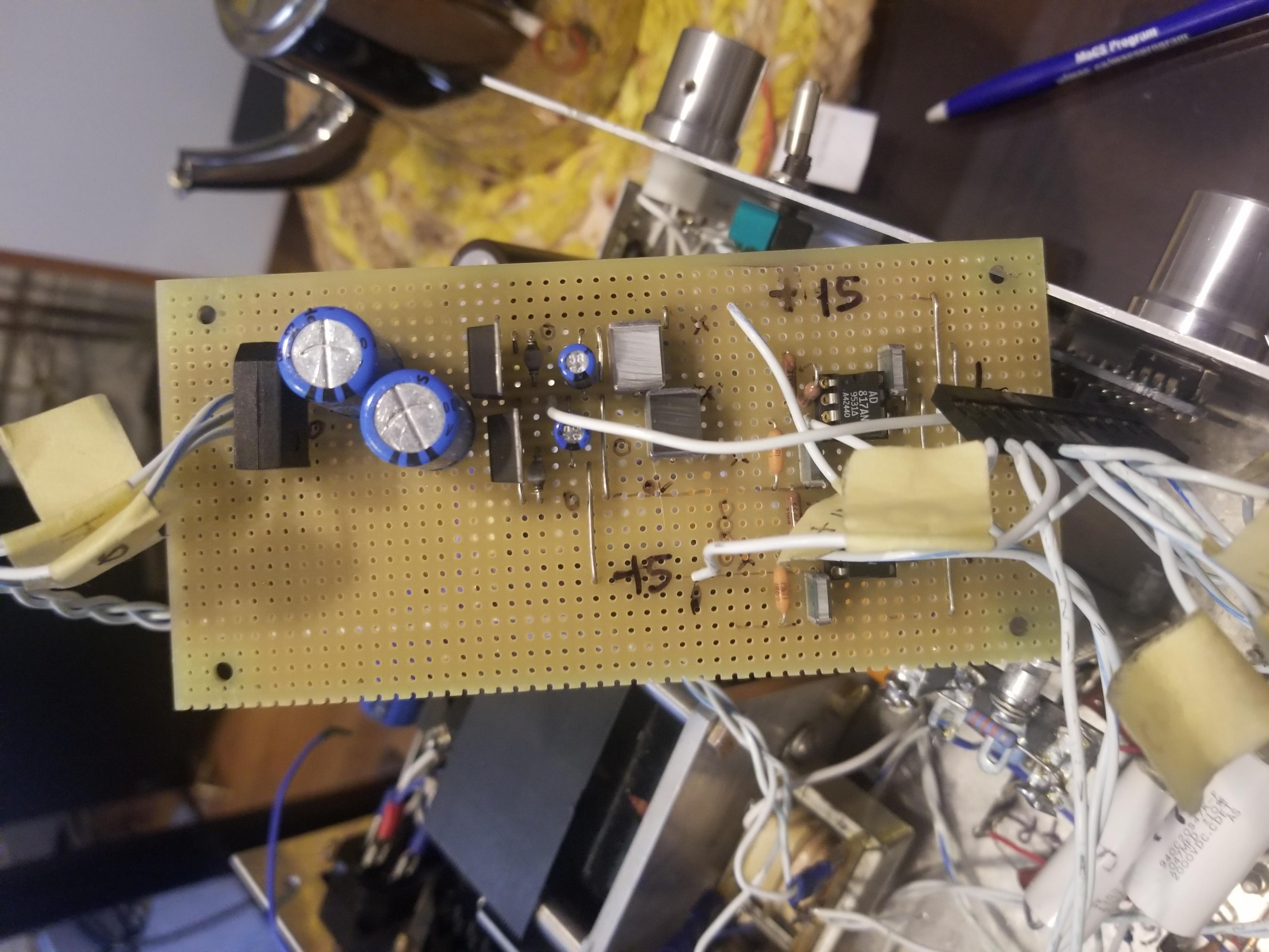

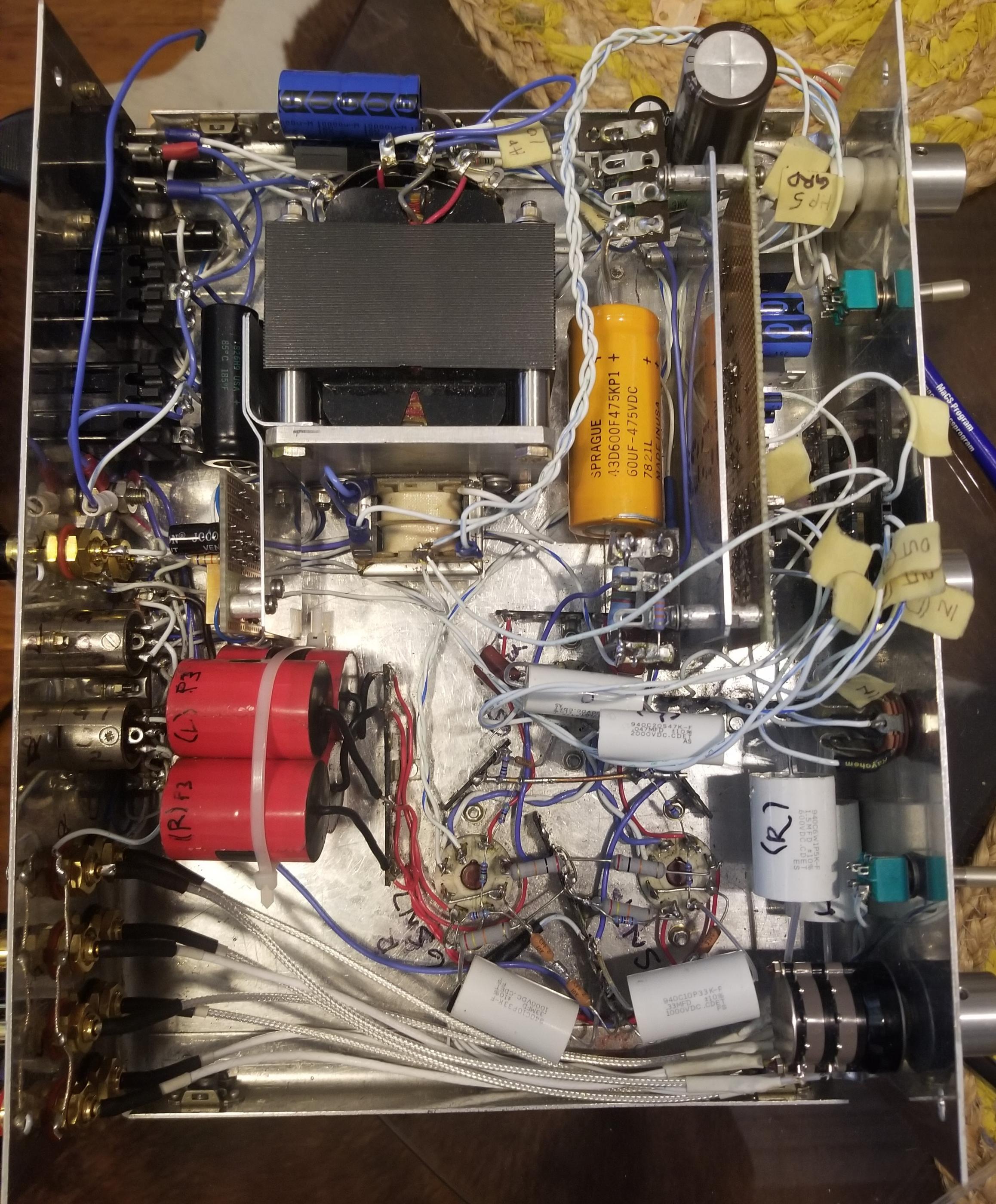

I will post a picture of the chassis with all the parts so you guys can visualize what's going on. I took a look at the marking on the chips for the headphone amp AD817AN.
JP.
The chassis is aluminum. I don't want to move the transformer unless absolutely necessary. As you can imagine, It would be a lot of work to do so.

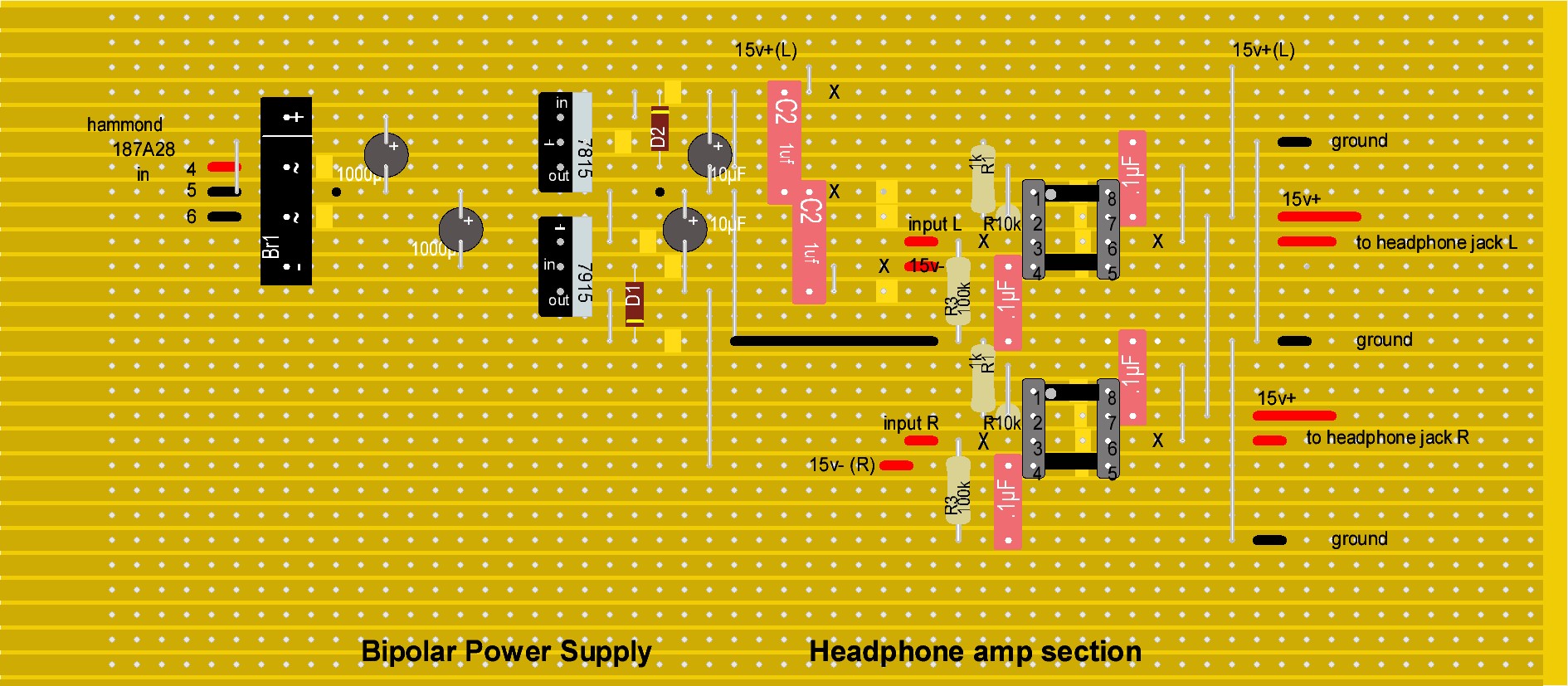

Did you mean both c2/3 should all be min 1000uf? I have 1000uf caps for position c2/3 but only 10uf for position c4/5
There is a volume control. It also works of the bipolar power supply. VCU | academyaudio
Nigel yes the 0v is grounded.

In a logical world one would move the HPA not the transformer :) An aluminium chassis is a good choice.
Yes when I write C2 and C3 I mean C2 and C3 as that makes life way simpler. Just like I wrote CRC/CLC if you want the very best. Possibly the volume control is best supplied with separate regulators. The chosen opamp is unknown to me as I have never used that one but it is a fast one so again a recommendation to use an input RC low pass filter to have it amplifying audio signals only.
My compliments on the direct improvement in posting. You should however read posts/reactions a bit more careful as you seem to have missed some directions regarding AC coupling the HPA. It would not surprise me that the hum becomes less as well. And eh... please have the thread split up.
Fast opamps love to oscillate on prototype boards. You’ll need an oscilloscope to see what’s going on. Even with a good layout I had opamps oscillating at 28Mhz. Some LM6171s were oscillating near 100Mhz!
Also you don’t need an input or output cap if your source has no DC offset.

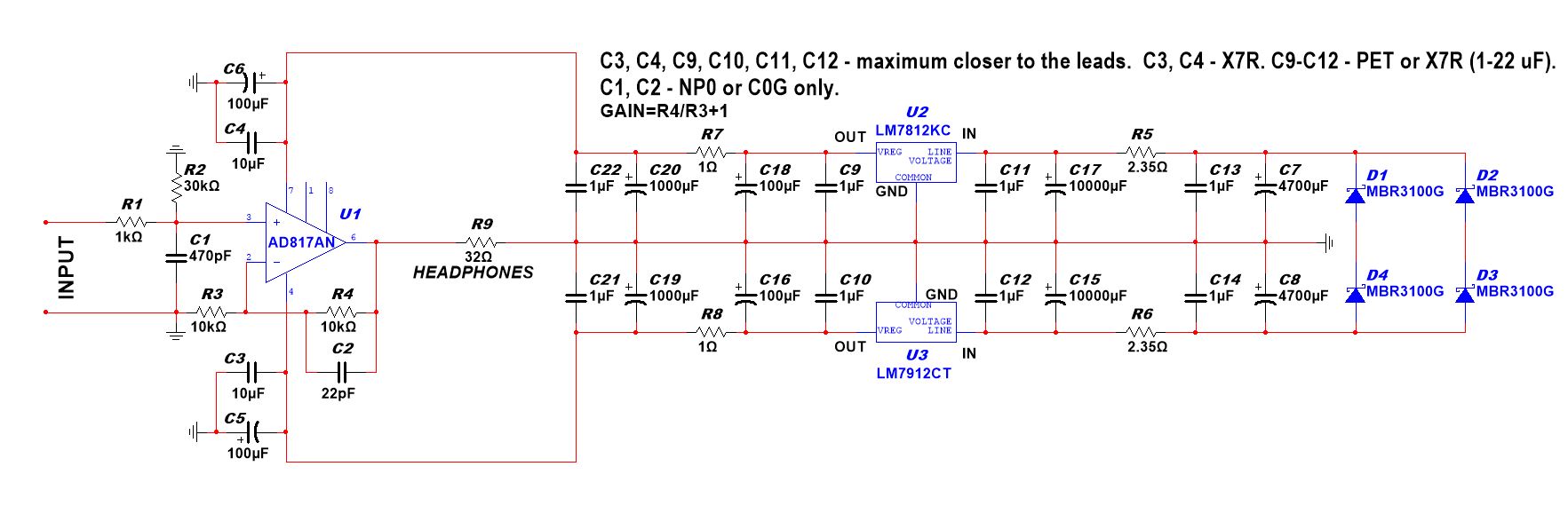

Maybe like that...

I believe they are original AD817ANZ. My friend gave them to me, i think he has other chips we could try.
Thanks for the attached schematic. I'll have a look at it.
AD817ANZ not bad OPamp, but for headphones need more output power, there is better something of AD825, AD8065 (8066 - dual version of 65), or THS4061 (4062). It's if you need only OPamp. Much better used OPamp+simple diamond buffer without NFB like Lehmann BCL schematic.
Just like that, or something :eek:
