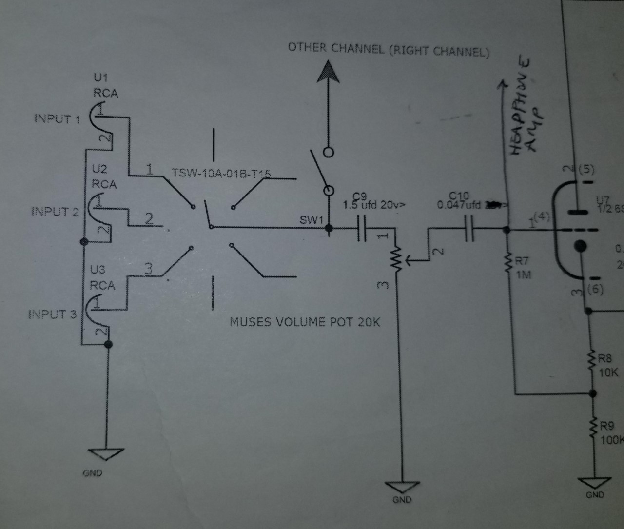

Thanks for the response. There's cap after the volume control. see the attached picture. I'll look into slower opamps. I'm gong to try using shielded cable at the inputs of the opamp. Also add some 220 ufd 50V non polarized on the output, with a 10K resistor to ground. If that doesn't work i can try some shielding as suggested. If that doesn't do it, I can separate the PS and HPA like you suggested. I hadn't even considered that option. Thank you for pointing out the possibility

I won't calculate it (you can) but I think C10 is chosen too small when it couples both the tube circuit and the HPA. You do realize that both the tube circuit and the HPA will be regulated in signal both at the same time? So when using head phones at reasonable volume the tube circuit will also have input and thus output. Comes with the circuit of course. Also the HPA should be connected before C10 with its own coupling cap to avoid the DC offset of the tube circuit making things very difficult. When the values of the HPA circuit are what is written in the schematic a separate 1 µF 50V Wima film cap in 5 mm pitch per channel will work OK. * there is no input filter at the inputs so after the source selector. I thought you changed that?
edit: couldn't resist and C10 is indeed way too small when used for both but there is a huge error in the circuit anyway so please correct. The preamp can not function good as it is built now as it will lack bass because of the 100 kOhm load of the HPA...

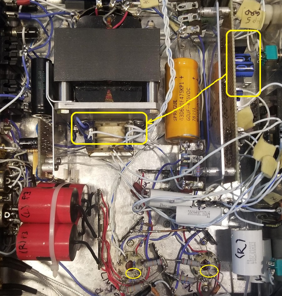

You have 4 problems, and a couple ancillary issues:
- the schematic in post 25 shows the HPA signal coming from the grid of the first tube stage; since it's a self-biased Cathode-follower, that gives the HPA a huge DC offset! -- give it its own input coupling capacitor (again, j-p advised), and take it from the MUSES volume control wiper (before C10) -- it'll need to be a lot larger than the 0,047uF for the tube Grid, say 4,7uF or 10uF @10 to 25V -- don't be afraid of electrolytics, especially for a test to confirm that it works
- 20dBV is too much gain -- by about 17dBV! The 32 ohm Grado HPs will demand the AD817's full 50mAp-p at ~1,13Vrms (~40mW), which is already in the range of typical input sources. You won't like the sound if the op-amp hits its current-limit. Lower the feedback resistor (if I get it done within the edit-time-limit, I'll type in the component designation; Alrighty Then: R2) to 30 - 50% of the op-amp's '-'_to_ground resistor.
- the AD817 is not a good choice for this service; we can probably find a way to make it work, but you'll know a lot more electronics by then, than you do now 😉
- the rectifiers around the LM7x15 regulators show a 1N4742A, which is a zener -- change to 1N400x; otherwise high frequency, high amplitude crap on the power line can go right around to the regulated supply
-- It looks like you might have a Star Ground wire passing through the center tap of the 187Axx transformer. That's a no-no. The relatively high-current pulses charging the 1000uF caps will corrupt that line.
-- Move the bridge and 1st filter caps to the transformer (IIRC jean-paul mentioned this). Right now you have almost 40Vp-p going the whole length of that braided feed. Braiding is great for reducing radiated EMI, but doesn't help a whit to reduce what gets coupled capacitively. The included pic suggests moving the whole supply -- which would be nominally better. But you could start with just the bridge and first filter caps and solve the bulk of the problem. If you do take the regulators, remember to take their output capacitors, too -- they're needed for stability.
As a general rule, power supply sections are best kept sequestered in a distant corner of the chassis whenever possible. Try to make a habit of that in future projects. 😉
-- There are some scary places in the point-to-point wiring. Try to include what they call a Service Loop in each part -- enough slack to allow reconnecting it, if for some reason you needed to just cut the wire to disconnect the part.

Ha ha it is becoming a repeating cycle isn't it? 🙂 Same with way too high gain, it is liked by many that have the "just doing something" way of working 😀
Since it starts to annoy me and I think I have done enough usefull suggestions that solved issues I bail out. Gregas, have fun and please think of doing things a more efficient way the next device.

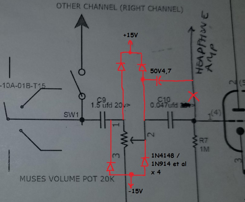

Probably, start with the 4,7uF 50V input coupling capacitor. Be sure to take it from the MUSES volume control, not AFTER the 0,047uF coupling cap going to the valve grid.
Then lower the HPA gain: All you have to do is tack a 470 or 560R resistor across the 10k feedback resistor (R2 - pin 6 to pin 2). That'll cut the gain to a little over 3dBV, which is plenty since the AD817 can only drive a 32 ohm load to about 1,1Vrms.
At this point you should have a listenable HPA. There may still be hum, but it should be relatively in the background. And the distortion should be fixed.
And here's something else I forgot earlier -- a little protection for the volume control.
