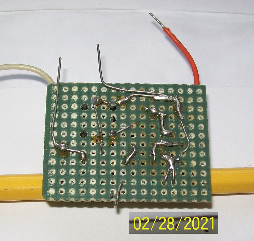

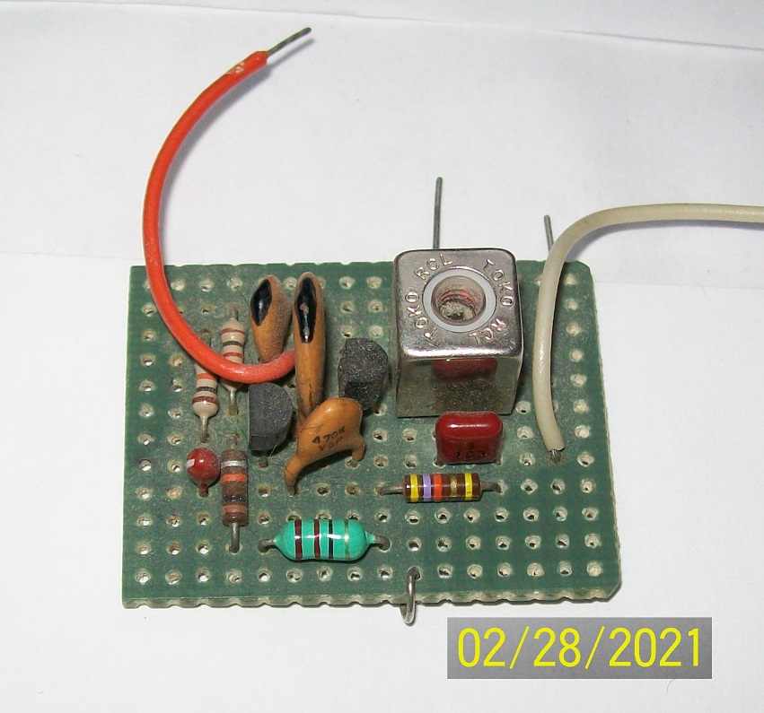

Below is a little VCO example from 30-some years ago, complete with dust and pet hair. It has more and larger parts, but about the same 9 nodes as your bias circuit. About 1 square inch.
