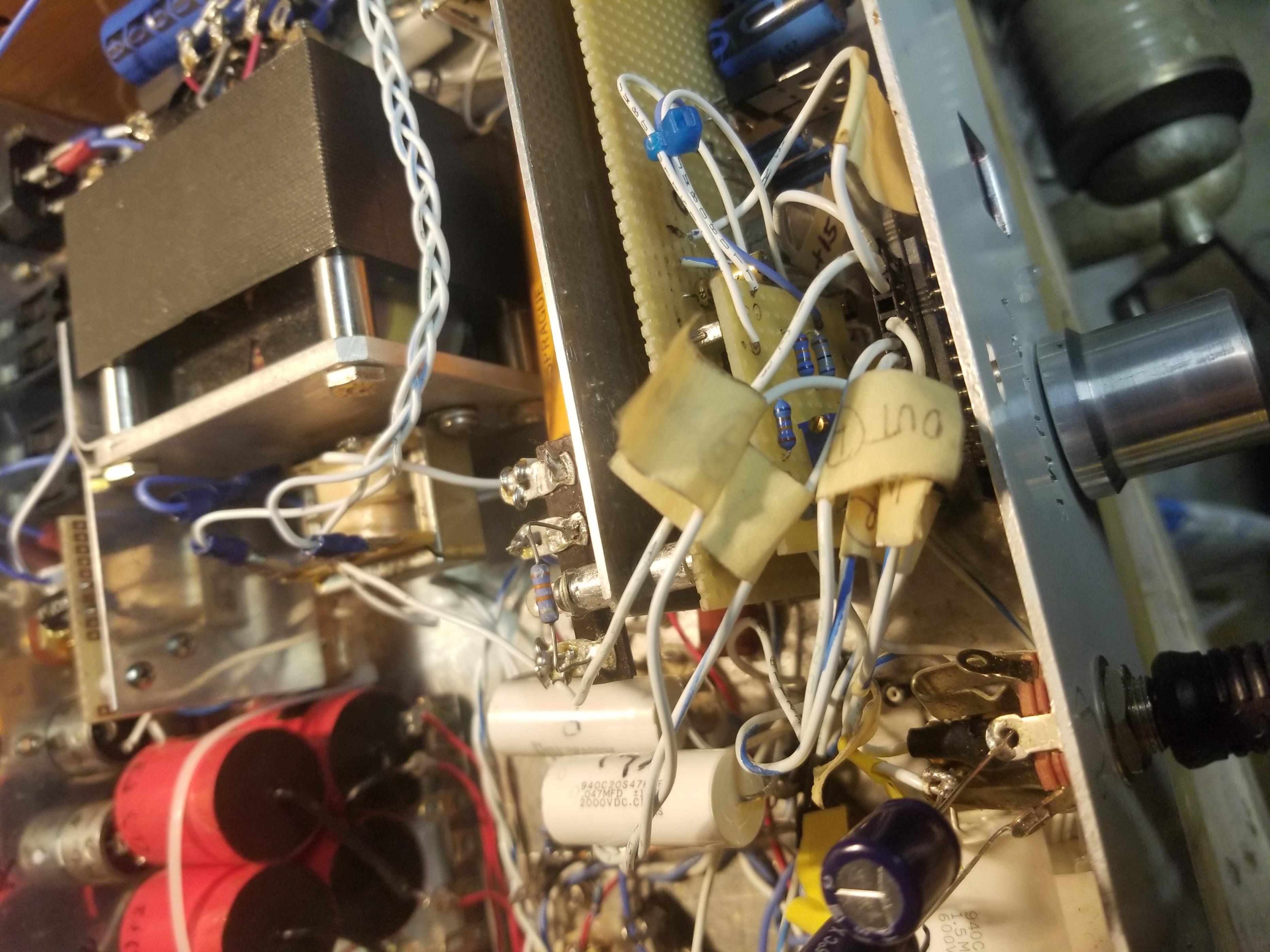

Just opened it up to have a look. Looks like the output caps won't fit on the veroboard where i has hoping. The temp compensation circuit is mounted above the area where they would fit. So if they sound ok not sure where I'd mount them.
Ok so 16v 220uf bipolar caps are in temporarily. I've conected them on the headphone jack. The amp
Sounds good to my ears.
So what now? Remove the temperature compensation circuit so that the capacitors fit on the veroboard?
Or take some measurements first?

I've forgotten what impedance your headphones are. 220uF is OK if they're 80 ohms or so and up. It might be a little light for driving those of lower impedance. Bigger caps probably won't fit at all .. 😱
But the best, and most important test, is surely "Sounds good to my ears".

Unless your 220uF bi-polars have a leakage problem, or have failed outright, there can be no offset -- at the 'phones at least.
So, does the bass drum sound right? And the open 'E' string of the bass guitar, or double bass? If they do, maybe it's time to put a wooden stake in the bias circuit and start enjoying the darned thing.
You'll still need the 68k to ground. If you want you could lower it to 27k or 33k -- would slightly reduce the input offset, and proportionally that of the output. But no appreciable performance change would result.

Just an update i spent some time listening to the HPA. Kick drums sound as they should. Low bass notes as well.
