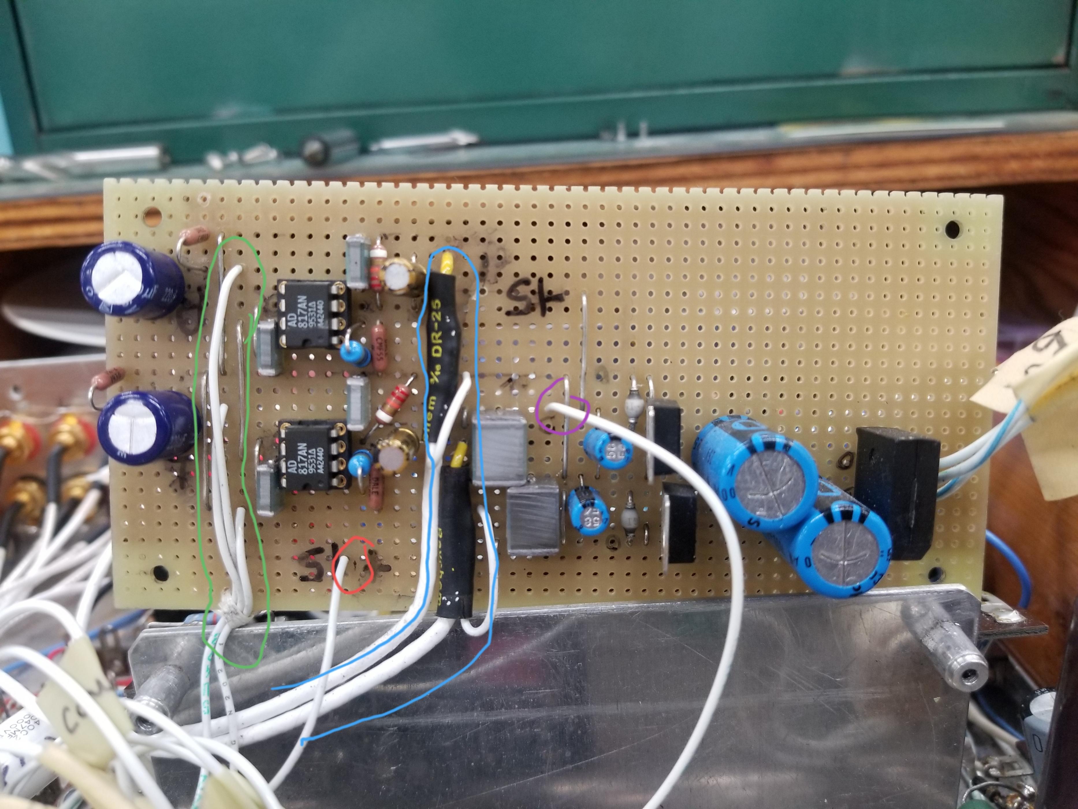

I ended up using 22k inputput bias resistors instead of the 24k, grabbed the wong ones. I tried the amp like this and it sounds good. Similar to before in terms of sound. Perhaps more bass?
Also the volume control seems less sensitive to volume increase when I rotate, it does that make sense?
The decrease in volume control sensitivity is reasonable -- each wiper now has about 3x the 'load' -- 22k vs 68k (in parallel with the much lighter load of the valve grid bias resistor).
The possible bass increase is a little harder to rationalize.
How about the hum -- any improvement/change there?
Yeah i wasn't positive about the bass increase.
The hum is about the same. Very low and in the distance.
I could def live with it. More noticeable with the closed back headphones I have. They have a stronger bass output than the grados.

I'm going to install the output caps and the 10k resistors on the veroboard.
Also try some shielded cable. The plan after consulting my friend is to ground one side only of the shielding.
I'm also going to try and clean up the wiring, and create a service loop as you've mentioned in the past.
I was thinking of using smaller gauge wire from the board to the volume pot. That would mean I'd have to crimp terminals on the new wire. The thinner wire would be easier to route and manage.
Let me know if you have any ideas about that.

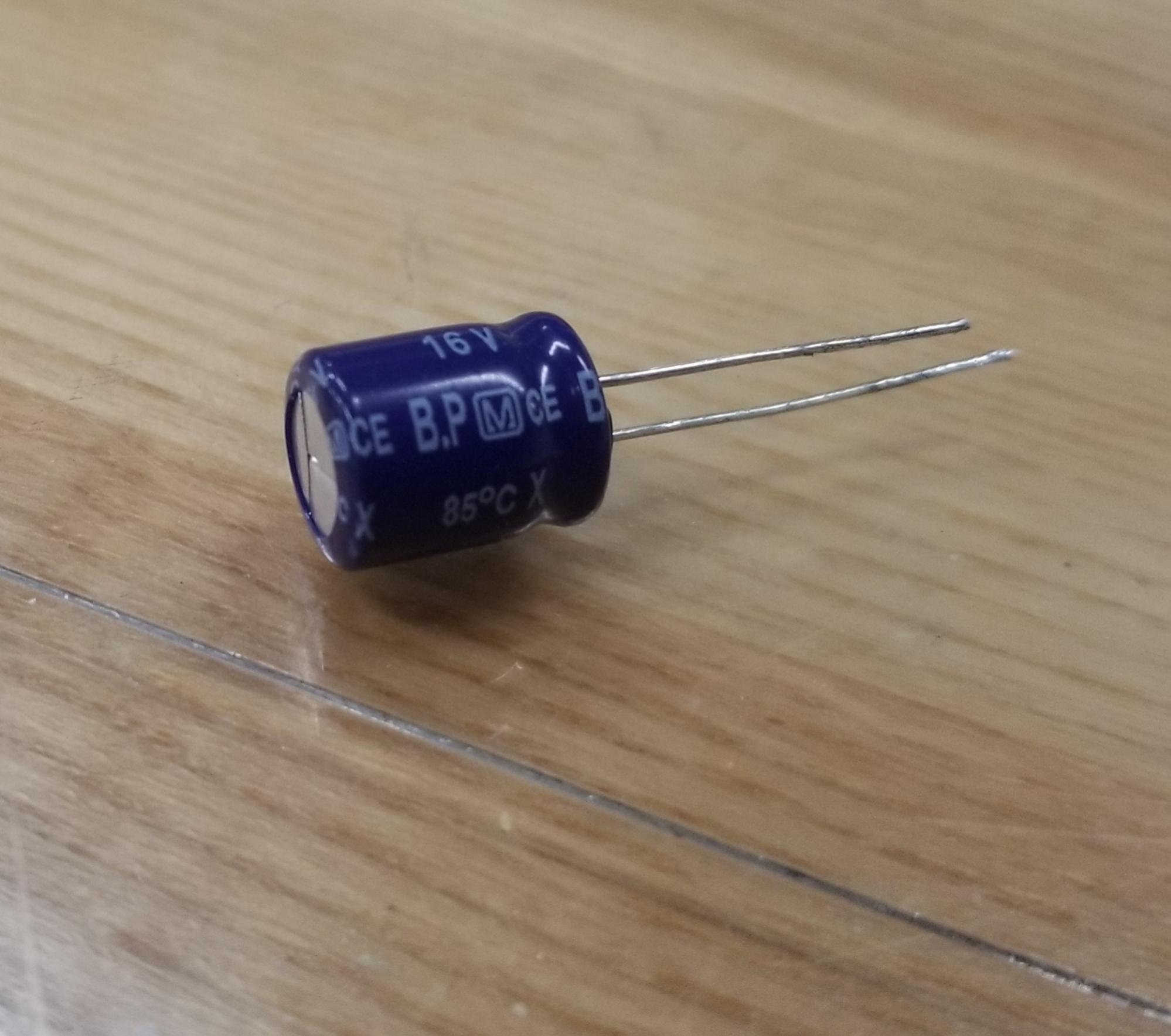

So working on putting the Bipolar caps on the veroboard. I noticed they have 2 different sized leads just like regular polarized capacitors. Any idea why that is? Should I pay attention to that?
They are the same package as polarized caps, they use the same packaging machinery...
Well it's completed now. Veroboard is in and soldered up.
The shielded inputs didn't make any difference. That being said I'm happy with
How it sounds. Slight hum in the distance when no music is playing, barely noticeable.
It's been quite a journey. I think I may have even learned a thing or two.
