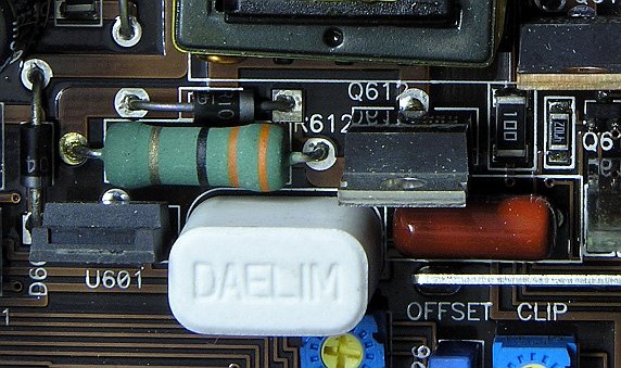

That's a problem. You should have ~0v on the third leg. ~13v on the center leg and ~0.7v on the first leg.
What are the markings on the large white resistor next to Q612?
What is the resistance across its terminals?
my amp doesn't have the resistor like that.....
i replaced the irfz34n, and it checked to be bad....
i have two resistors like the one in your photo that is laying down...
Is there a green resistor standing up where the white resistor is in the photo?
If so, what are the colors on it and what's its value (measured with meter)?
It's open. It should be 0.30 ohms. It probably opened when the FET shorted.
Use only a flameproof or fusible resistor as a replacement.

There could be a couple of problems. The most likely is a shorted transformer. It may be difficult to check unless it's shorted from one set of windings to another.
Using the numbers from the earlier link...
1 should be shorted to 10
2, 3, 8 and 9 should be shorted together
4, 5, 6 and 7 should be shorted together
There should be no direct (0 ohm) connections between the 3 sets of windings above.
It's also possible that the transformer has a shorted turn in one of the 3 groups of windings above. You won't be able to determine if it does with an ohm meter.
Does the outside of the transformer show any signs of overheating?

Check the capacitors next to the diodes to see if any are shorted. If one is shorted, it's likely the one that is connected to the diode you replaced.
The 4007 isn't a high-speed diode and may run hot during normal operation. If you get the amp working, you should replace the 4007 with the same part number as the original.
Which diode was defective?
I would be surprised if it even function correctly at all with a 4007. You need a fast recovery diode.
