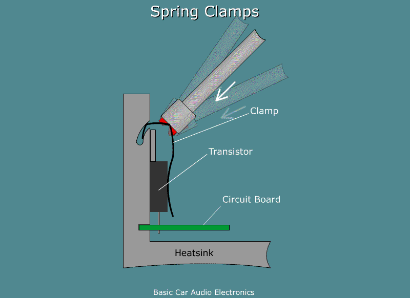

To reinstall them, I use the following 'tool'. The red insert is the insulation from 6g wire. It keeps the driver from sliding on the clamp. Tap them gently back into place.
Where you able to get new clips? I haven't bent any of mine but I haven't tried putting them back on yet either.shagone said:trial and error led me to this idea as well as a few bent up clips in the procces.
Hi Perry, thanks for all the help. Are you person who wrote the website in your link? I actually have one of those snap on tools. I found a screwdriver to be easier.
the ones that i bent originally before finding the tool that worked were easily bent or hammered back into shape and worked fine after re-installing them.
i have heard that new clips are nearly impossible to find. i have an amp or too here that arrived with a few missing clips if anyone has a lead on where to find them. one amp that comes to mind is an older Autotek that i need clips for.
