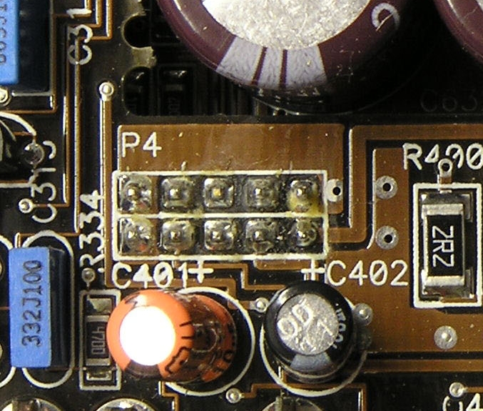

On the 10 pin plug near the power terminal block, post a list of the voltages on the pins. Bottom left is 1. Bottom right is 5. Top right is 6. Top left is 10.
Set the meter to DC volts. Black lead on the ground terminal of the amp.
problem solved.........replacing all the TO-220 FET's did fix the amp........the remote wire came loose.......giving me a headache.....thanks to everybody who took the time to read and post to my thread.......perry, thank you for taking the time to post a picture and for me to check the voltages on the 10 pin plug.. that's when the amp came back to life on the bench, and then later i found the remote wire came loose......it's all good.

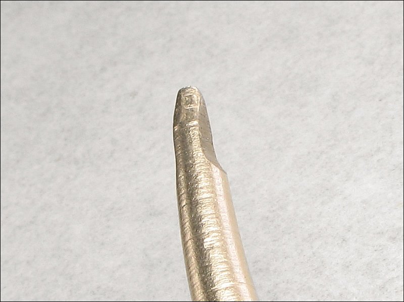

There has got to be a trick to remove the clamps holding the transistors down. Anyone care to share?
I used to grind a screwdriver to fit in the slot then bend it about 45°. A friend showed me this and it works better in most cases.
Cotter key remover:
Grind end like this:
Cotter key remover:
So I can bend the clips up but then I am stuck because they dont slide. So what is your process?
Insert the tip of the tool into the slot in the clip until it hits the sink and pull back on the handle. The back of the clip will lift and the clip will pull out of the slot.
