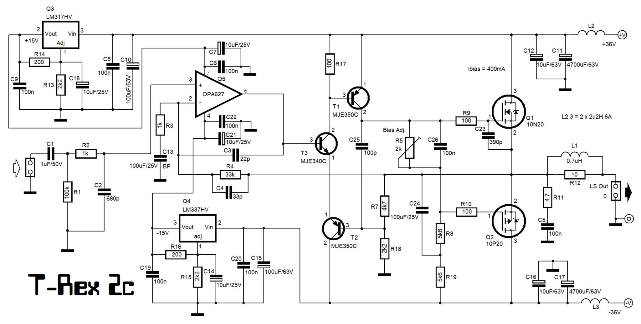

Help, with LAT FET schematic
The scheme in #18 is not workable, as there is no bias feedback to the opamp. Having a transformer imbedded within a global feedback design will considerably complicate the design and the effort required.
Unless you're determined to design your own amp for the learning experience, I'd advise building a proven design.

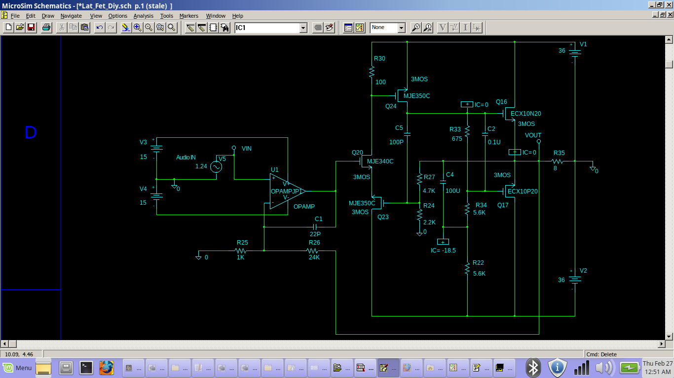

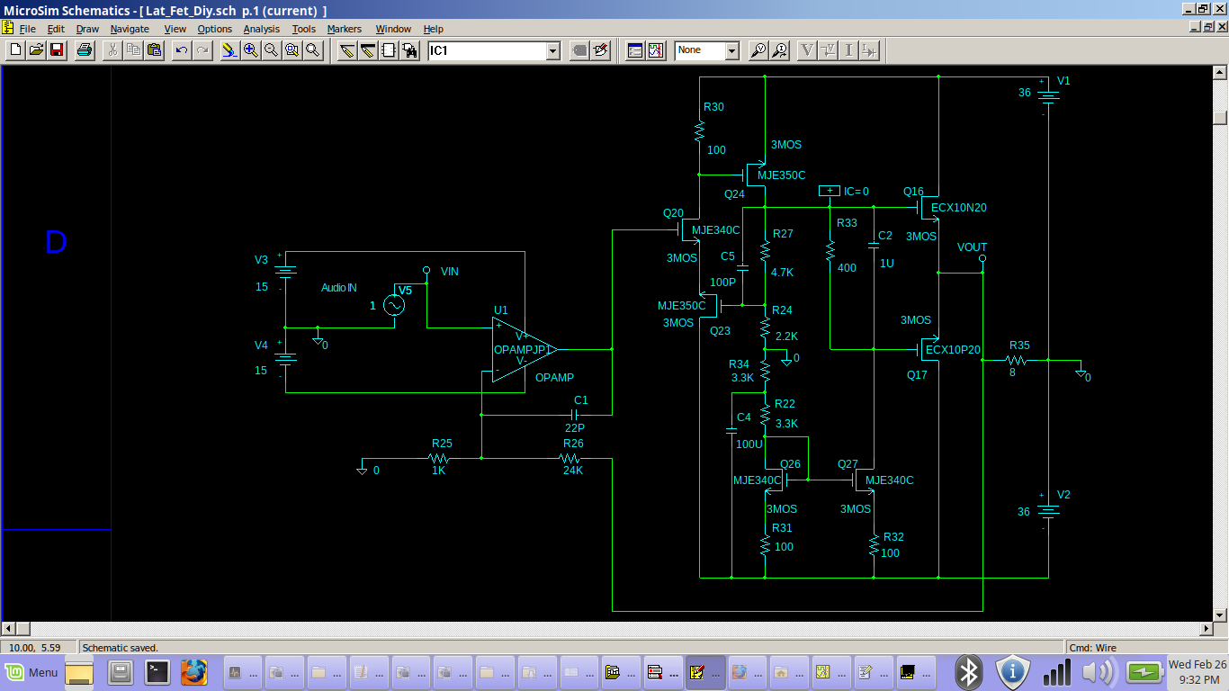

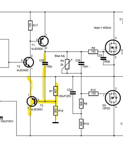

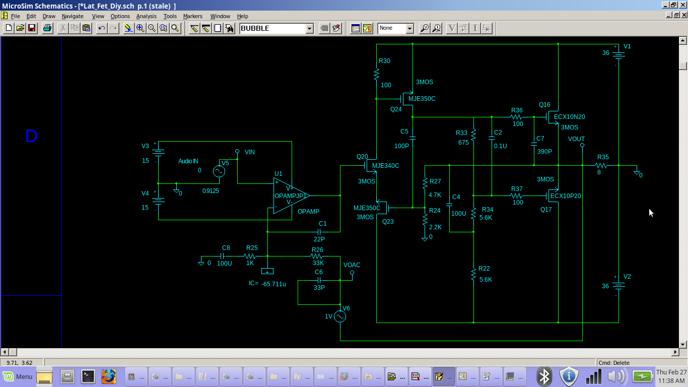

The bias is set by the collector current of Q27 going through R33 which creates gate voltage for Fet16 and Fet17. I have no models or simulations to actually have real values. I don't know how stable the bias point will be because of Q27 heating effects. Ideally Q26 and Q27 need to be at the same temperature so that the voltage across R33 would be nearly temperature independent. The voltage across R33 is VR33=R33*{R31*(Vrail-Vbe26)/(R34+R22+R31)+Vbe26-Vbe27}/R32.

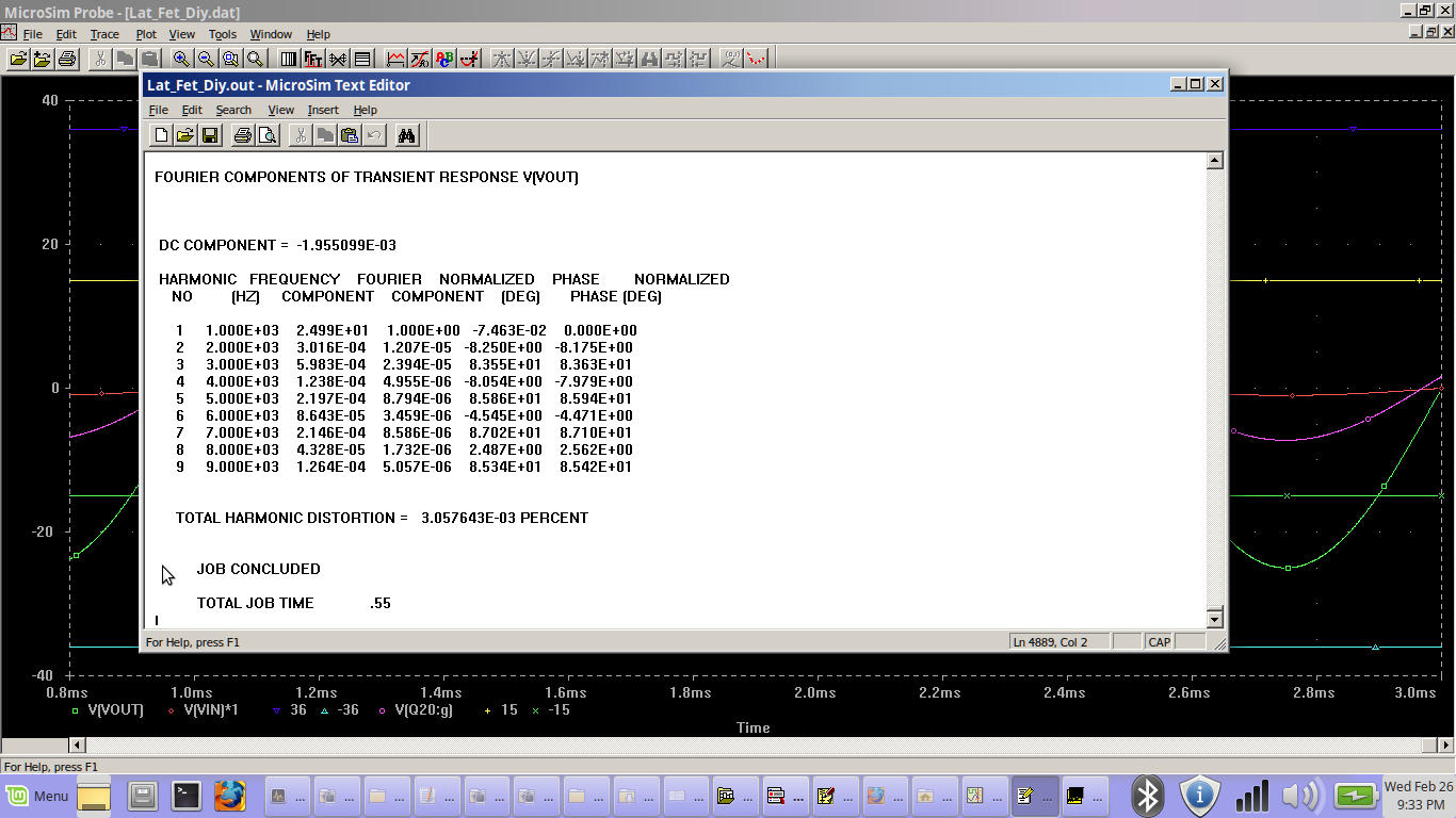

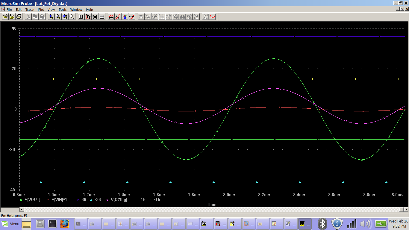

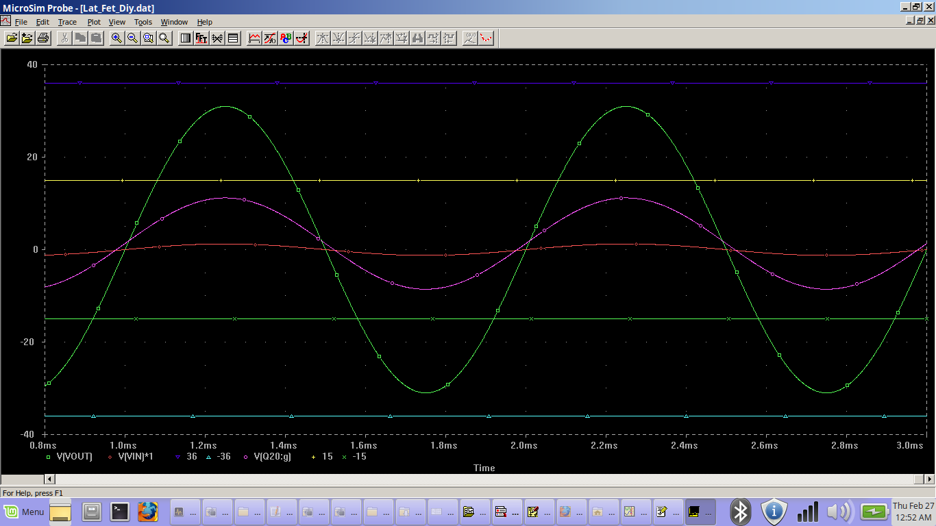

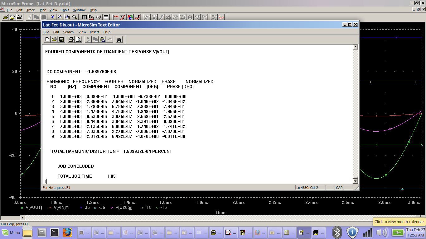

You made me go to work. Here is some data. I think that I have the right models but someone will have to check me. The bias is at 400ma. I am using a 13v/us op_amp model. It needs about a gain of 3 in the output stage to work well. I had to compensate the output stage for stability. It may have issues but it does amplify with low distortion. I used some transistor models from a collection by Bob Cordell for the simulation.

I was wrong. I think that you can get there from here. That boost function off of the output kills the need for the current mirror and yields a much lower distortion. Nice.

Many thanks for the effort, I needed this kind of effort/support.
The gate/source op the 10n20 needs capacity compensation by adding a capacitors of 390p. The 10p20 has already this higher Cgs. Maybe distortion will be better.
I will study your proposal and make a PCB to build and test.
The opamp you use for high bandwidth error correction by feedback to get lower thd and noise, psrr then without opamp.
It is possible to get almost same thd + n specs as the opamp.
Just look at composite lm3886 designs with specs better then standalone lm3886.
I expect with this topology get at least ten times better figures then normal lat fet designs.

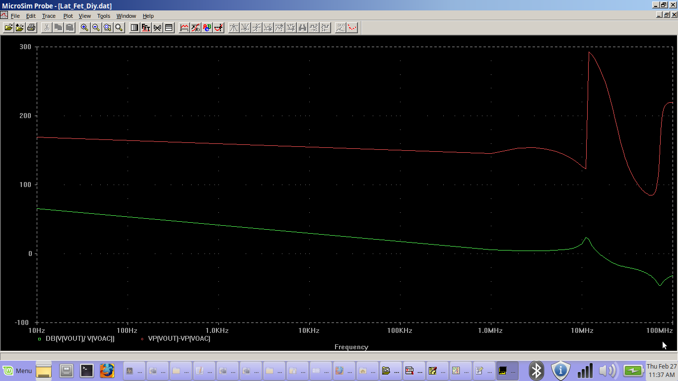

I think it will self oscillate.

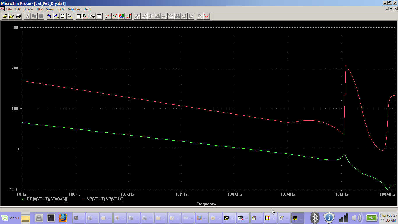

You have three amplifier stages. First the Op with a 0 db gain at 7,2MHz. Then comes the transistor stage with a bandwith of about 0,7 MHz and then the LATfet stage with a varying bandwith depending of the D-S voltage but something like 1,5 to 3 MHz. I have not made a simulation but to me it looks like a lot of phase shift. If you google "nested Miller integrators" You will find a method of getting following integrating stages to work.
The upper N channel fet has 0.973 Vgs and the lower P channel fet has 1.128v Vgs with a 0.394A bias.
You can't be sure of the AC analysis because I don't have the real model of your op-amp. So be aware that you may want or need to change some values when you have the actual circuit.
