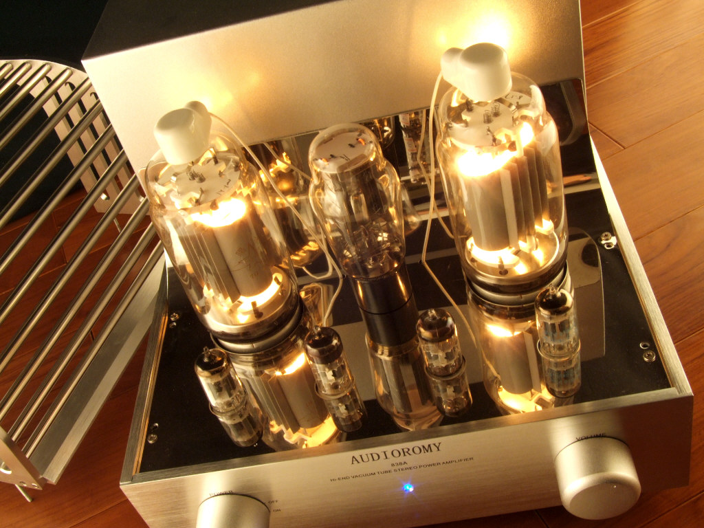

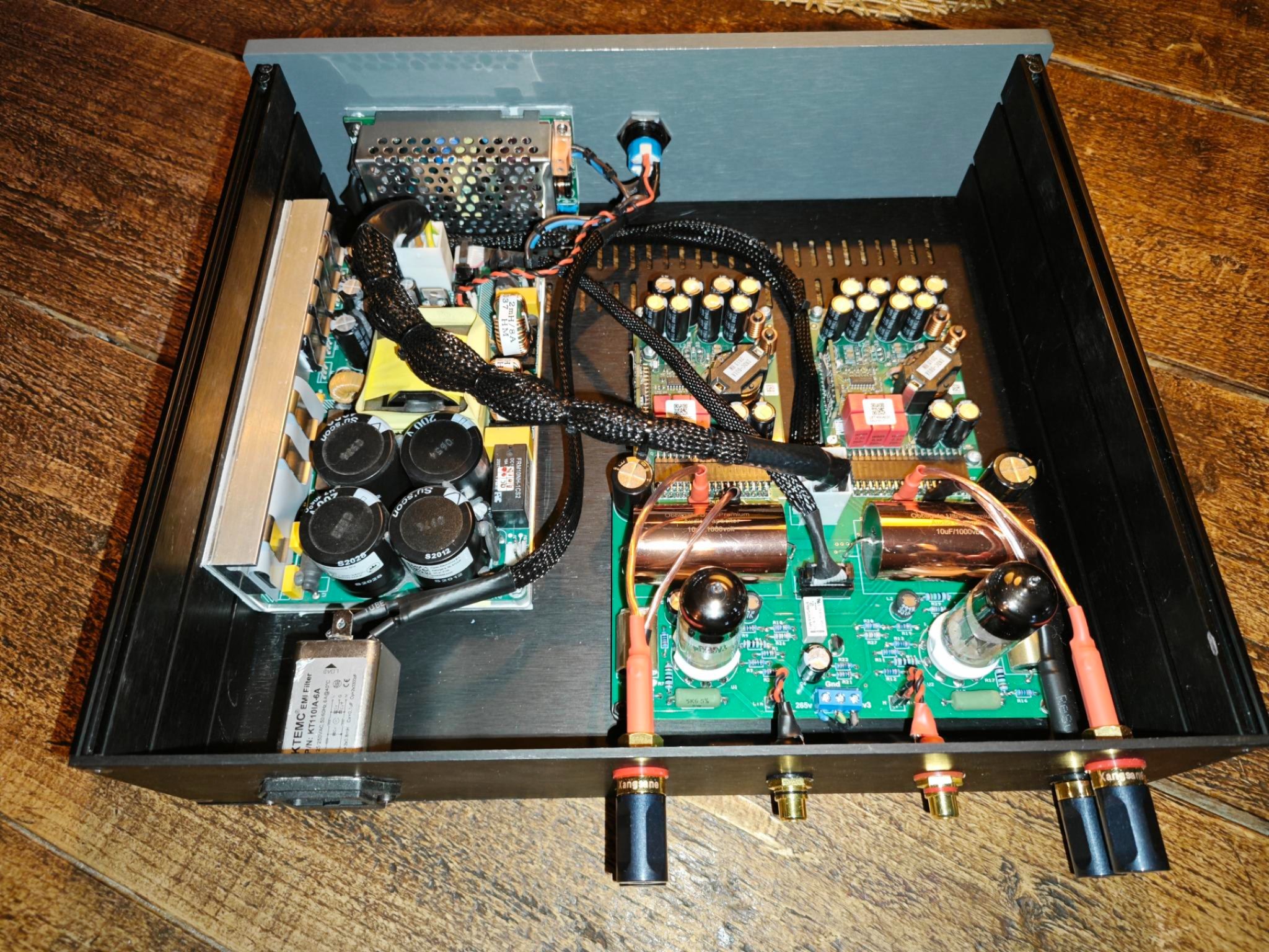

This week the stereo version is ready and it have to compete with my purifi 1et400a hybrid and a 813SE tube amp.
