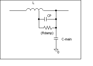

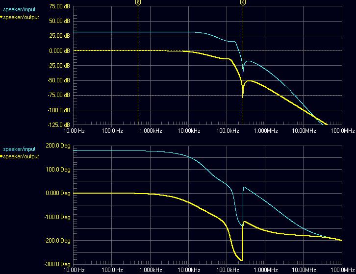

I agree with Charles, a notch can be added without adding an inductor, simply by putting a cap (and perhaps a resistor) in parallel with the main coil. (is that what you meant?) That has a disadvantage, however: the response of the filter remains flat at frequencies higher than the notch freq, so the RFI radiation can become very important.
I thought another way of doing the same, as I have told: adding a second LC stage, calculating the components so the pole is mainly independent on the main filter pole. Then add the notch to this second coil. Then take feedback from the first LC section only (the other has little influence on the overall freq. response and it remains independent on load, so no problem).
BUT: it does not improve the carrier rejection in the feedback loop, only the overall rejection.
SO: I have thought another way: adding the notch in parallel with the FIRST coil, and leaving the second LC stage simple. This way:
a) You have feedback around first filter with improved carrier suppression due to the notch.
b) The filter response continues dropping at high frequencies
c) I get excellent carrier suppression at the output
d) The simulations show about the same phase margin as with single filter and no notch (but THD due to TIM should improve).
e) If the sw. freq. moves away from the notch, you are not worse than you were before (indeed you have to move more than 10% to lose compared with before, so no problem)
What do you think? I am anxious to test that in real-life.
That's NOT what I meant, since its disadvantages are by far too high.
What I meant was using a notch filter in the signal path before the comparator in order to remove the ripple before the two signals are compared. There are techniques available using simulated inductors or summed high- and lowpass- filters and the like.
Another thing I also once thought of was the use of a tap on the filter coil and a parallel C like below. I want to avoid as many inductors as possible since they are a PITA.

Ah, ok. You meant in the fb. path. (I try to avoid that, due to the phase changes, compensation needs, etc).
Apart from the pain of having another inductor (can be very low valued, a ready-made choke indeed), what do you think of my solution?

As far as I understood you want to use a notch filter first and then a lowpass, am I right ?
If yes, you might have quite some idle current in your first inductor !

Yes, that's the idea: the first filter determines the main filter pole, at, say, 50KHz, with a notch at 280KHz or so. The second one is mainly a second pole at, say, 150-200KHz.
Why the high idle current in the first inductor?
Pierre
Pierre
At resonance you always have higher current flowing between inductor and cap than flowing through the parallel arrangement as a whole (also your cap needs to have low losses or it will get hot) !
Now that you connect this thingie directly to the output ..........
Have you simulated it and checked the current ?

Ok, I have simulated it quickly, seems to appear huge current peaks in the capacitor, that don't appear if the notch is in the second stage. So I think that Charles is right (as expected), I don't like that currents flowing in my components.
So idea discarded.
To see if we are in the right way (excessive ripple in the feedback signal that causes TIM in the error opamp), perhaps changing it to a very fast one should improve situation, just to be sure that we are not hunting in the wrong direction... what do you think?
I will keep you posted when I can measure something in the prototype.

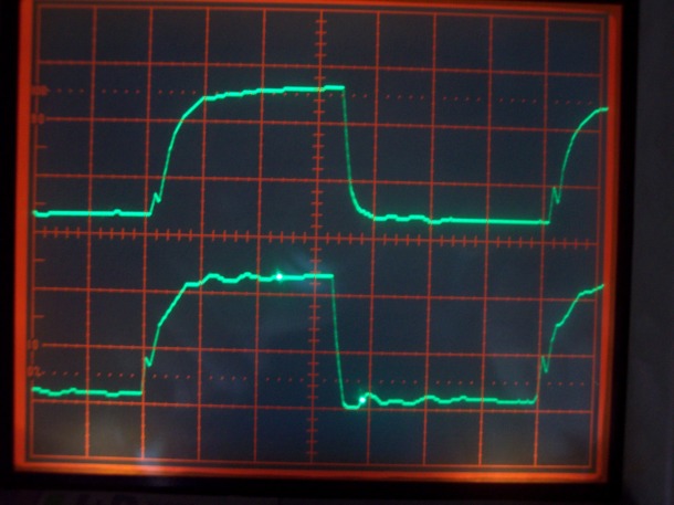

These are the gate to source voltages of both mosfets.
They have been carefully measured with a 40MHz probe just at the mosfets pins. The scale is 500ns/div, 5V/div.
Top trace is Low side, bottom trace is High side mosfet.
NOTE that the measurements weren't taken at the same time, so they are NOT time aligned!
What do you think?
My gate drive setup is a IR2113 with 10ohm and schottky diodes in antiparallel in series with each gate.
What do you think?

You're using one of the IR driver IC's right?
Ouput current of the driver would be increased from lowering that resistor, not much though, and you still have set dead time so it won't cause overlapping signals.
I can't see how shoot through would increase driver current either.
Due to the driver in use I dont' think you're suffering shoot through caused by overlapping signals, but since you're turning the mosfets on faster with the lower resistor, you give less time for the body diode of the mosfet to recover and that will cause a shoot through like spike, as the mosfet turns on into a partially recovered diode it can't yet fully block the reverse current which gets slammed down it's throat. Big loss of efficiency, would lead to failure. You need the slower turn on to help avoid that.
My simulations have shown massive THD decreases by hugely overlapping the signals... in reality it can never work like that without exploding so a compromise has to be found.
Jaka Racman will be posting some gate driver waveforms for us soon that should be very educational and you may find that helpful in some way. IR gate driver with and without BJT buffers. Stay tunned.
What kind of mosfets are you using anyway?
I have now reduced the gate resistors to 6 ohms and I will post the gate drive signals. They don't show any violent spikes or similar, so I assume they are safe. I think distortion has been greatly reduced, specially noticeable at low frequencies. (all this by eye, still waiting to be able to do some RMAA measurements).
My mosfets are NTP35N15 from OnSemi.
BTW: What signal shoul I watch to in order to ensure that the mosfets are safe? Vgs? Vds?
